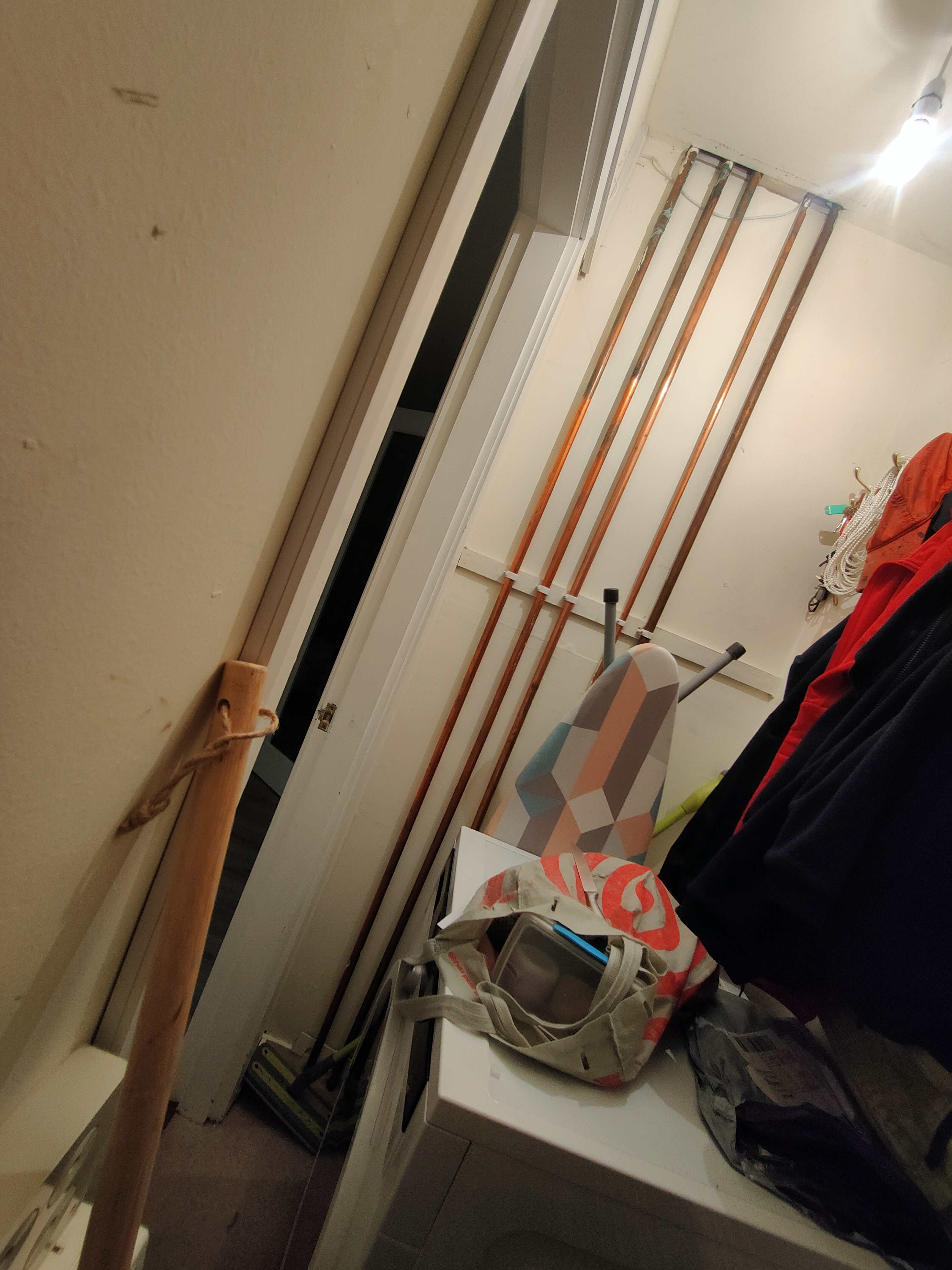

February 11Feb 11 1 hour ago, AidanGee93 said: Thanks mate, I think I'll check the blow out pipe and do what you recommend to see if any water gathering...only issue is my boiler is located in the central of the house upper floor, so not against a gable end wall with the blow out pipe heading through that wall ..any idea where the blow out pipe will lead to? There's a bathroom in room next to boiler cupboard so thinking it maybe attached onto the drainage pipe from sink/bath? Can you post a pic of the pipework under the boiler and another stood back a bit, so we can see if maybe it goes into a trap or a pump unit etc?
February 12Feb 12 Author 17 hours ago, Nickfromwales said: Can you post a pic of the pipework under the boiler and another stood back a bit, so we can see if maybe it goes into a trap or a pump unit etc? Yes mate, bare with me I'll post a picture of the boiler with pics of the pipes running up...later tonight

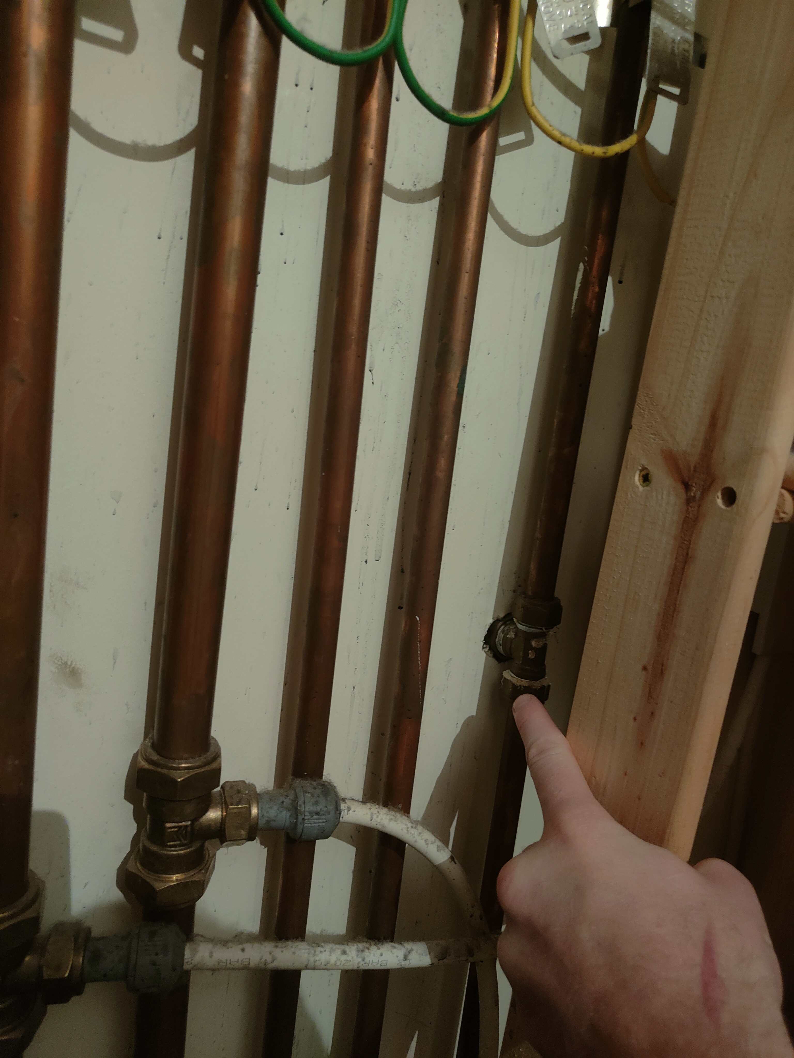

February 12Feb 12 Author So picture with tumble dryer in it is the bottom floor where pipes run up to next floor for the boiler. There's a T piece on the 15mm copper...mabey this is the pressure relief valve pipe leading to a drain pipe? (Where that T piece leads to is the en suite).
February 12Feb 12 22 minutes ago, AidanGee93 said: So picture with tumble dryer in it is the bottom floor where pipes run up to next floor for the boiler. There's a T piece on the 15mm copper...mabey this is the pressure relief valve pipe leading to a drain pipe? (Where that T piece leads to is the en suite). Nope, doubt it. The PRV discharge wouldn't T off. Combi needs 5 pipes, flow/return/gas/cold/hot. I see 5 pipes, so we're looking for pipe #6. Look directly up under the boiler, do you see another 15mm pipe heading off? Can you see this appear on an outside wall?

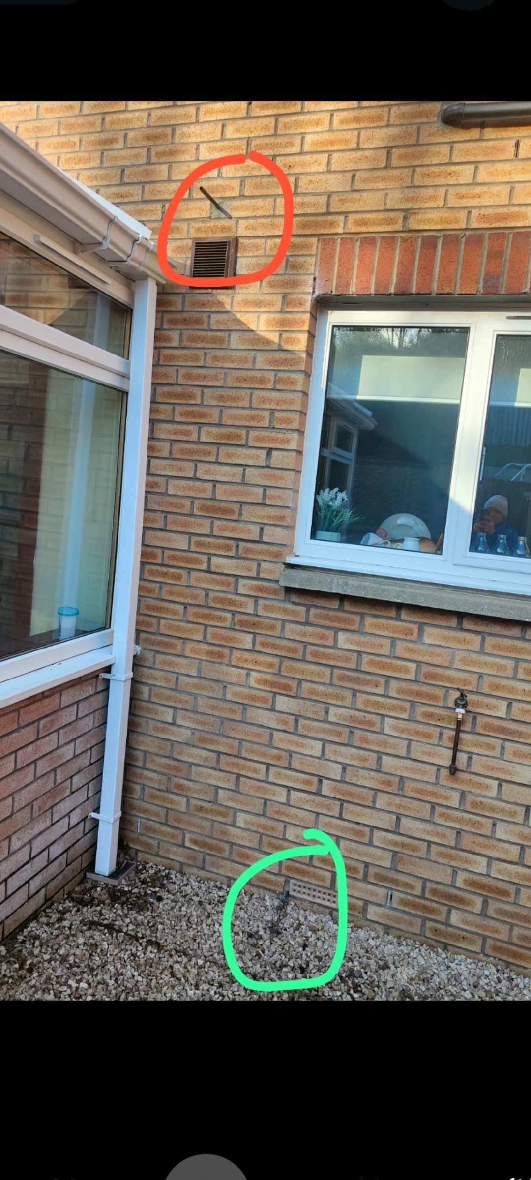

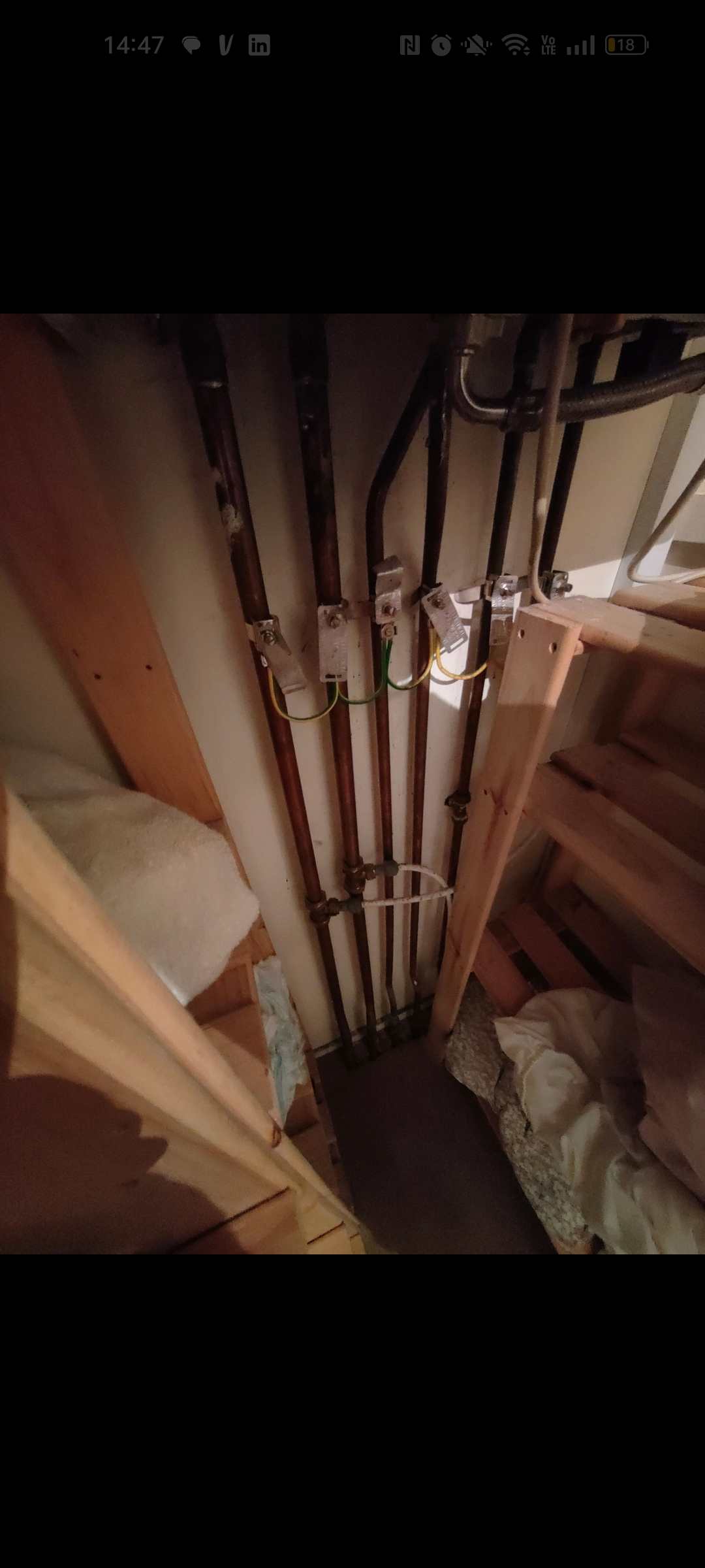

February 13Feb 13 Author Here's better pic with 6 pipes... Cicrles the pipes outside, green is central heating drain valve. So the red must be the Trv discharge? What I can do is tie a sandwich bag to this (preferably on a dry 24hours) then if it's wet inside it means?
