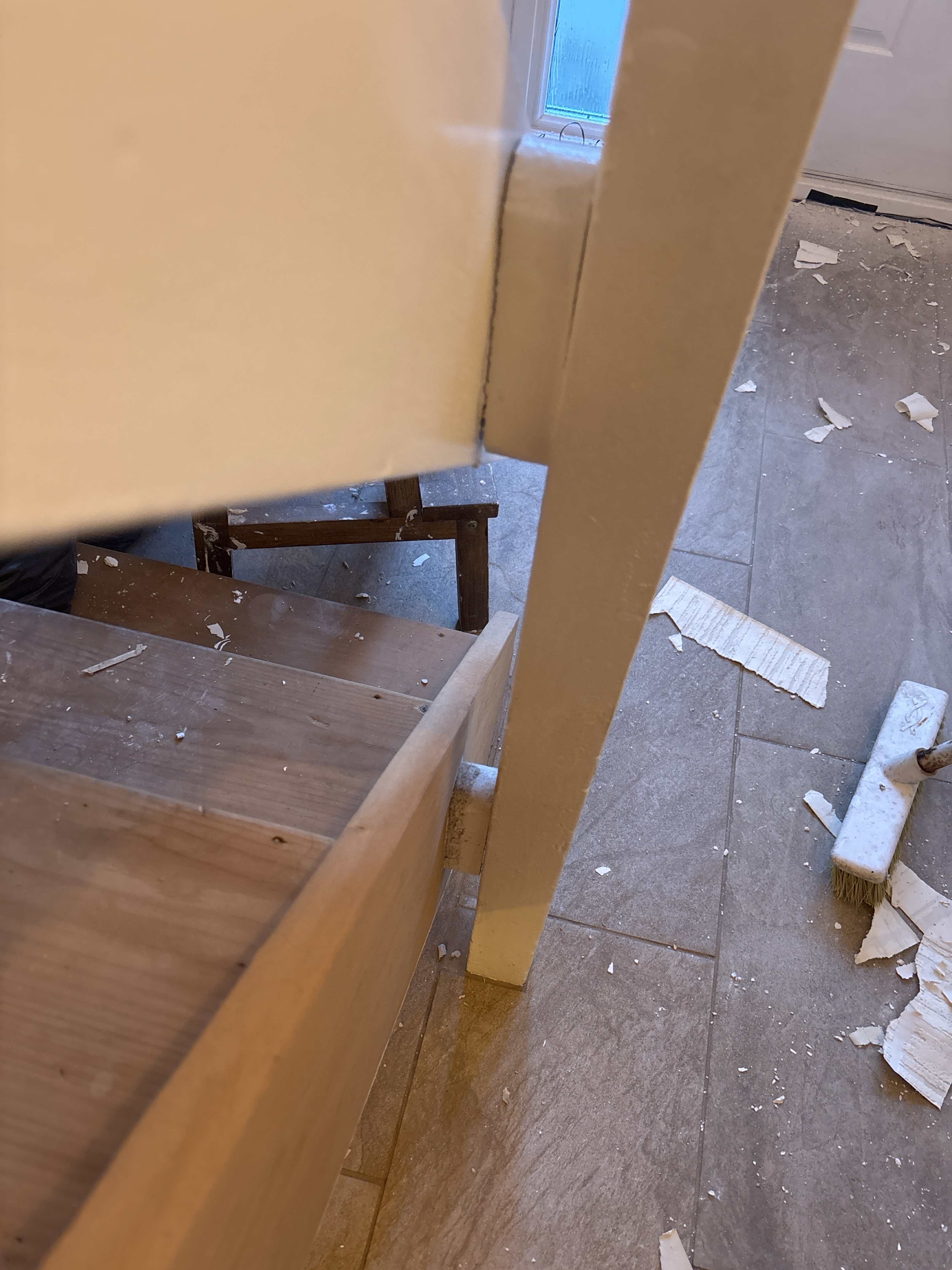

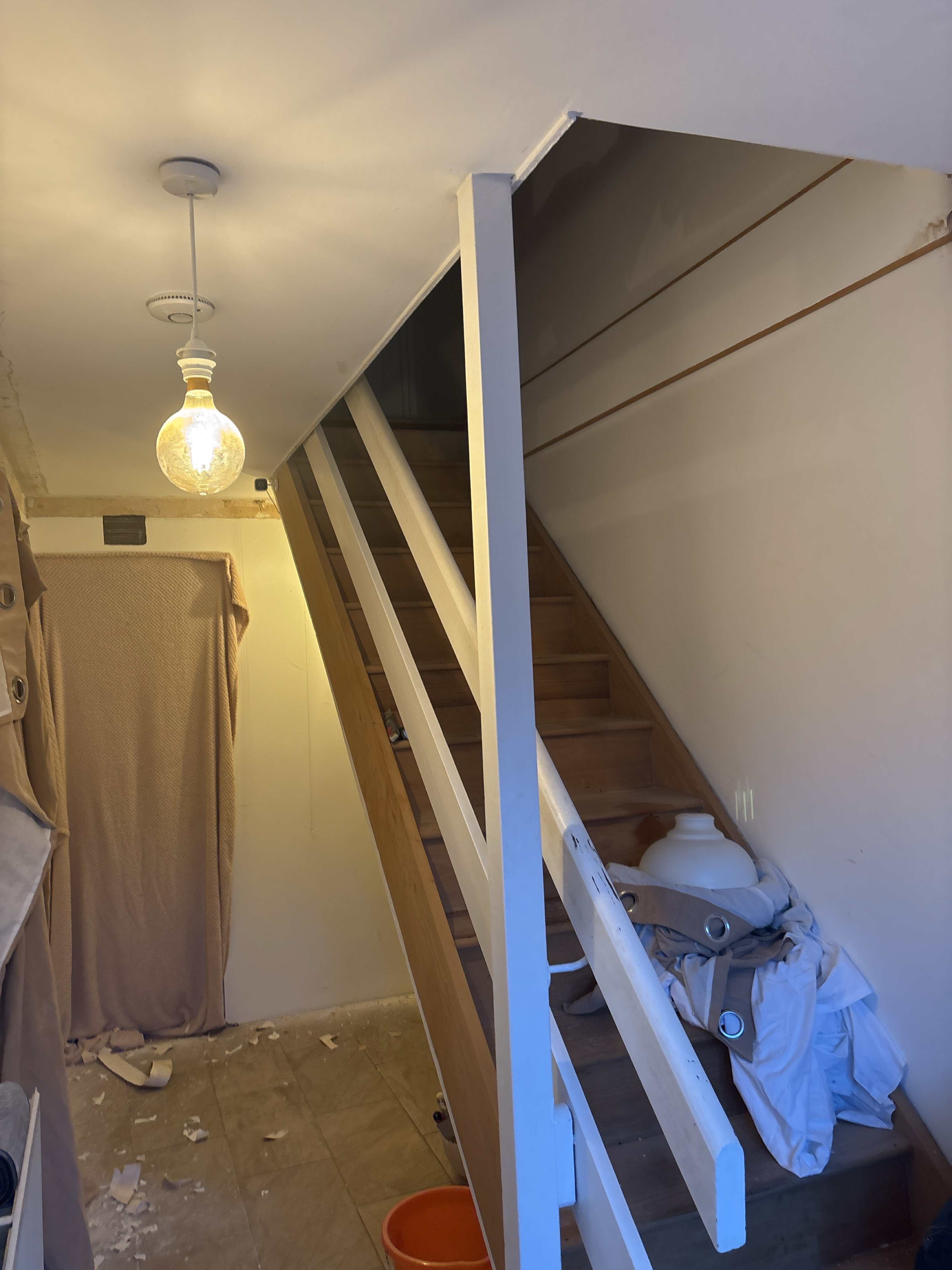

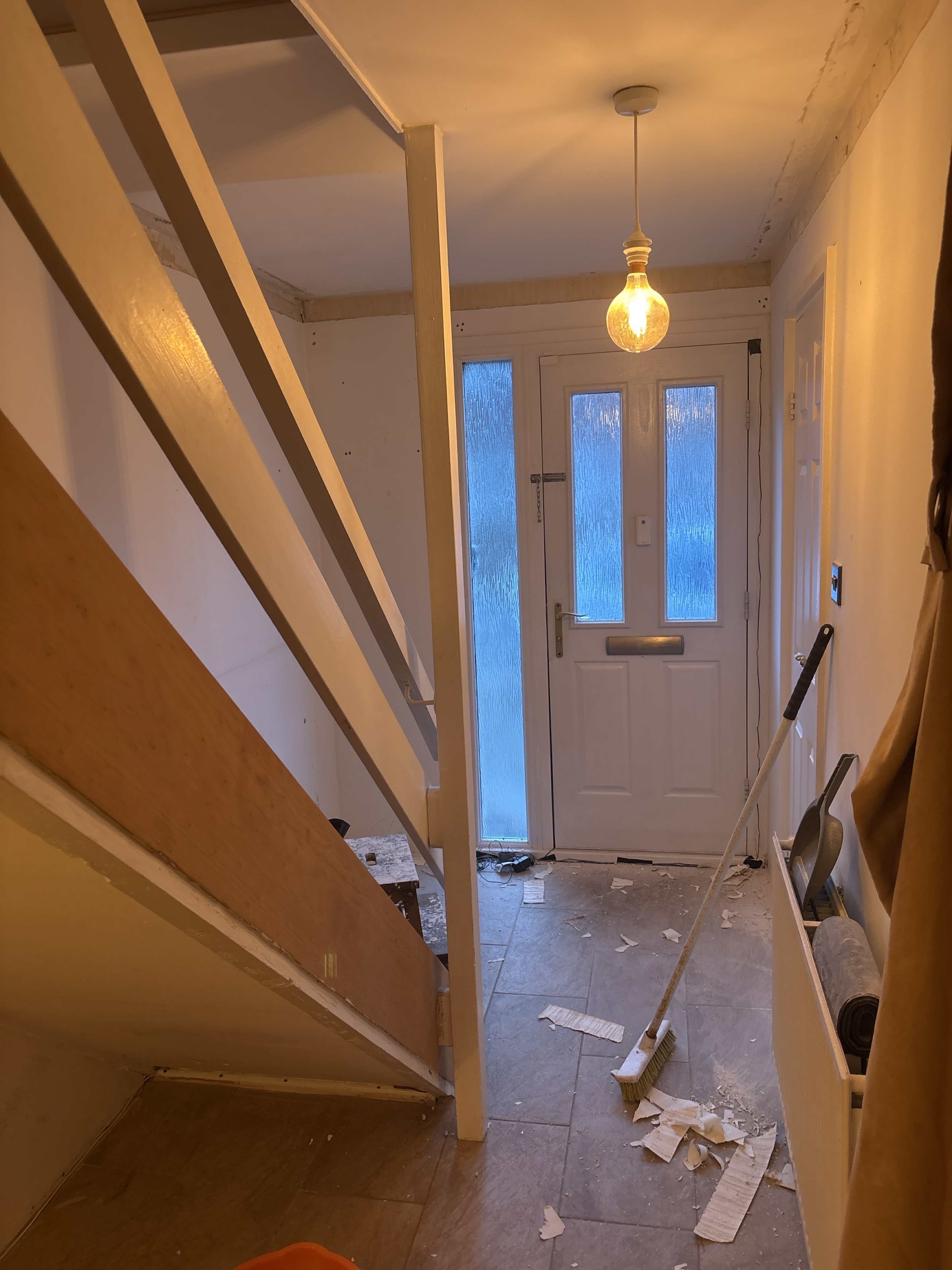

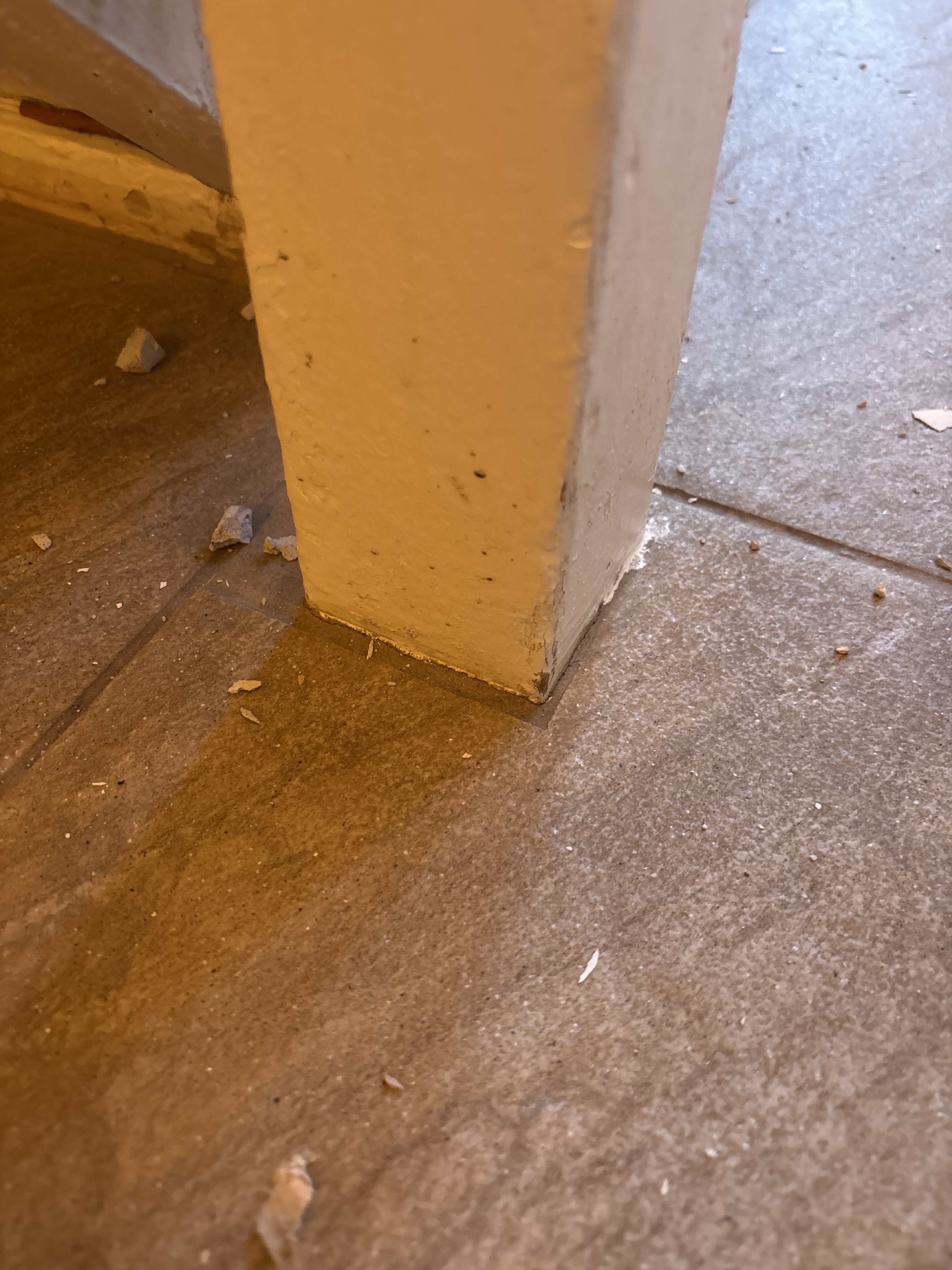

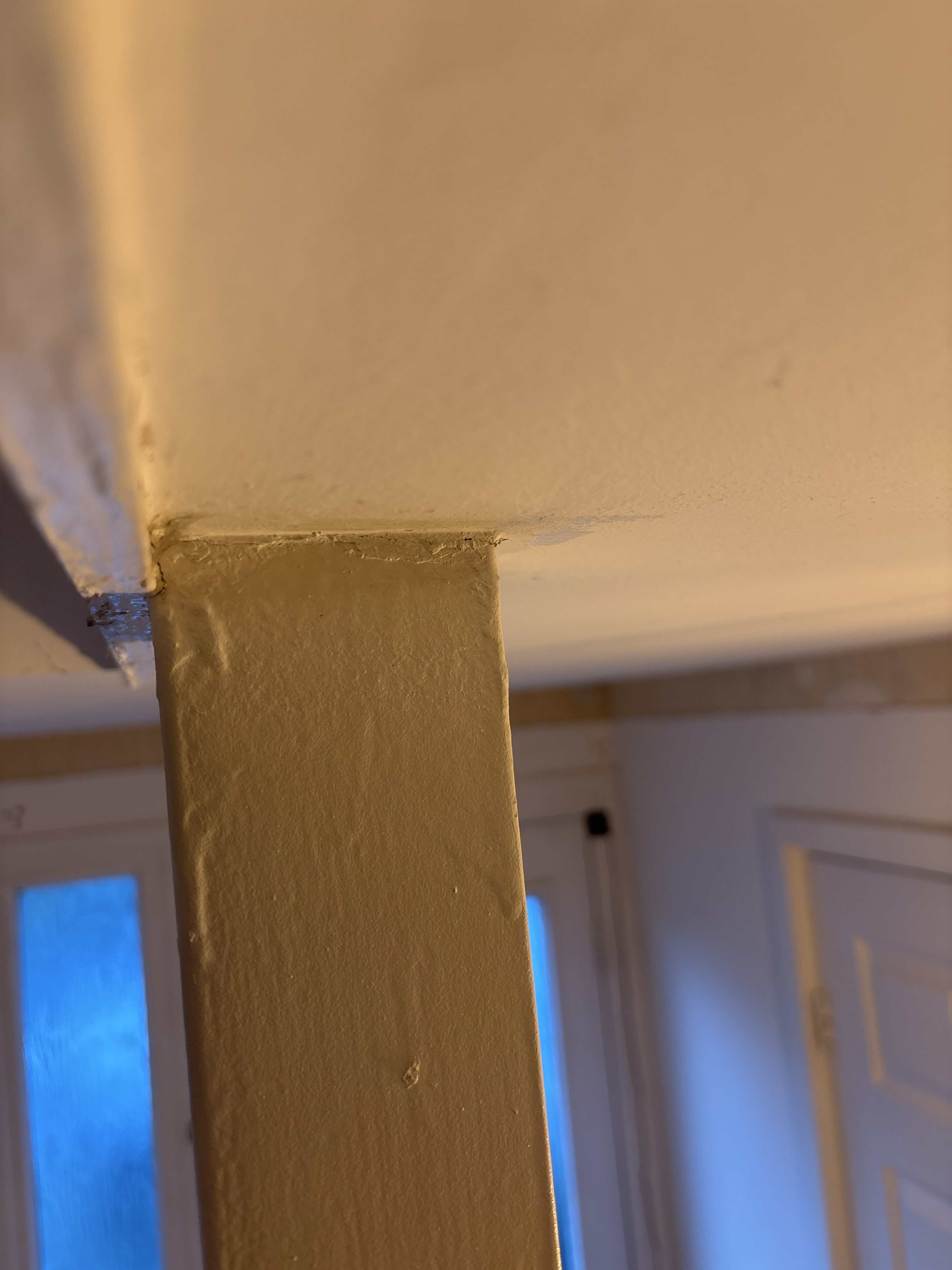

Photos attached show:
  1. Base of the post at floor level
  2. Head of the post at ceiling level
  3. Detail of connection between post and stair stringer
  4. Wider context of the staircase and hallway

Hi, I cannot see any pics, but at 65mm square it is unlikely to be structural. Many older houses had newal posts floor to ceiling to make them more stable.
Not structural. Most likely the relic of a 1970's renovation.
