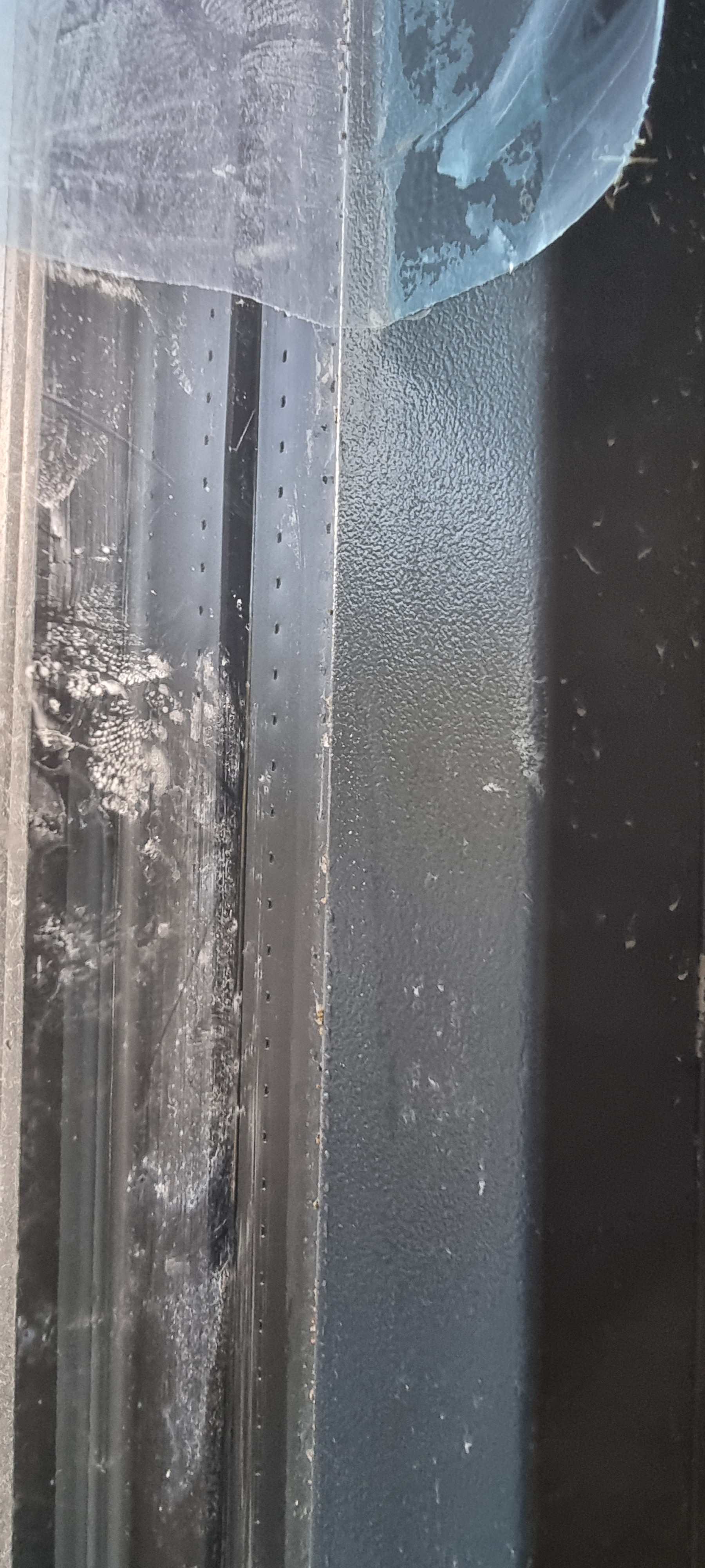

Mr Blobby Posted yesterday at 11:55 Posted yesterday at 11:55 In a few places on the large windows glazed on site, the external gaskets are below the beads. Like this: These little ponds are usually full of dirt and water. Window fitters here lunchtime to run through my snagging list. Should i add this to the list and insist the gaskets are properly seated? Fitters are going to be reluctant because it will take a team of weightlifters to lift the glass.
G and J Posted yesterday at 12:22 Posted yesterday at 12:22 We had this on a large fixed pane. The fitters took out the pane, re did the gaskets, and reglazed. 1

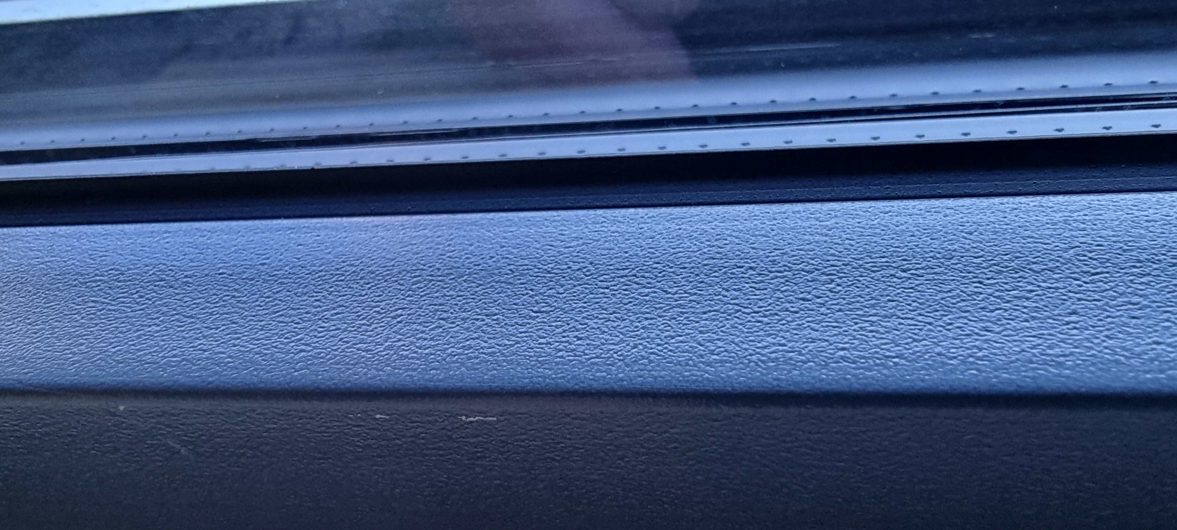

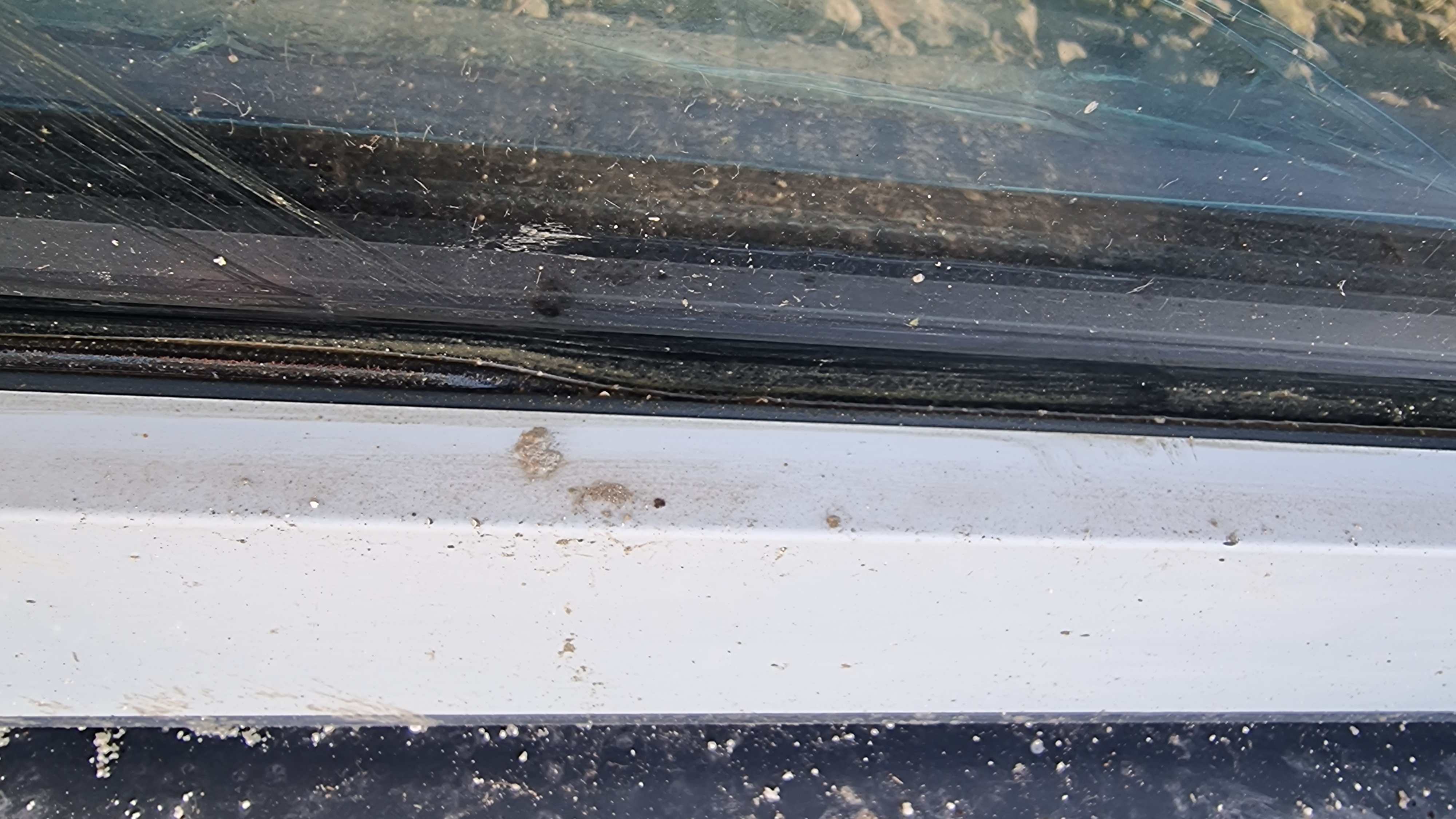

Mr Blobby Posted 23 hours ago Author Posted 23 hours ago (edited) Another thing that's weird, is all our internorm fixed pane windows have a gasket between bead and glass, like this But one window has no gasket, which doesn't seem to cause any problems but seems a bit odd. Like this... I'll ask the window fitter when he arrives if this is by design 🤷 Anyone else have this feature? Edited 23 hours ago by Mr Blobby
craig Posted 23 hours ago Posted 23 hours ago 1 hour ago, Mr Blobby said: the external gaskets are below the beads Add to snag list 14 minutes ago, Mr Blobby said: But one window has no gasket It should be dry sealed (gasket) or wet sealed (silicone) depending on system. Add to snag list. 1
