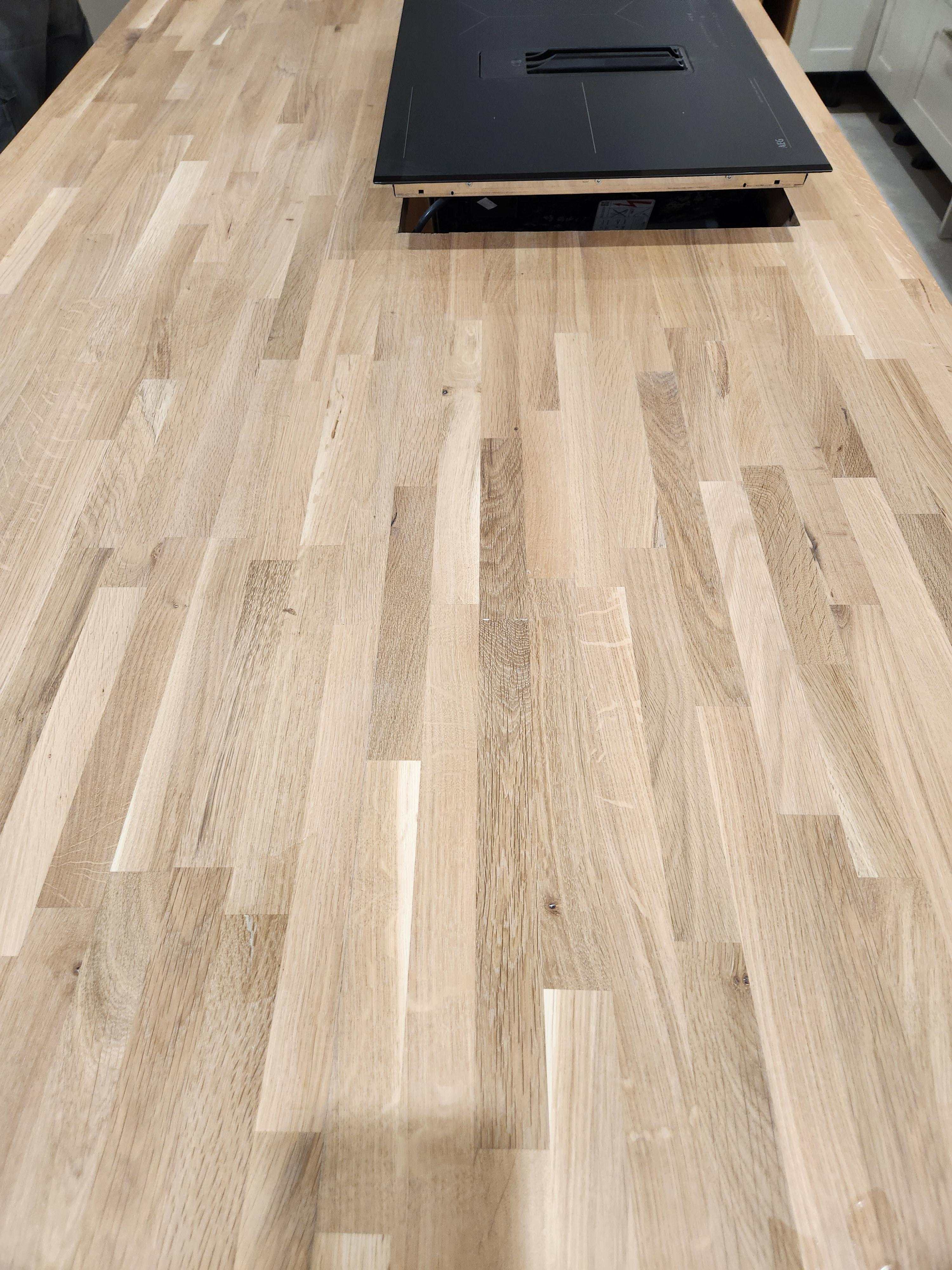

Hi All - I have been finishing the oak tops with the 3068 natural version of the Osmo Top Oil however it seems to go on quite different to the normal satin/matt version. I'm applying it with a brush and rubbing the excess off after a few mins. Because this seems to be a very differnet oil it feels like more coats are needed. Just wondering if anyone out there has any experince with these oils.
Oak tops. Initially sanded to 150. Applied two coats 12 hrs apart, then rubbed down with 240 before applying a third coat. Forth applied same as third.

Have you noticed any white pigment in the 3068?

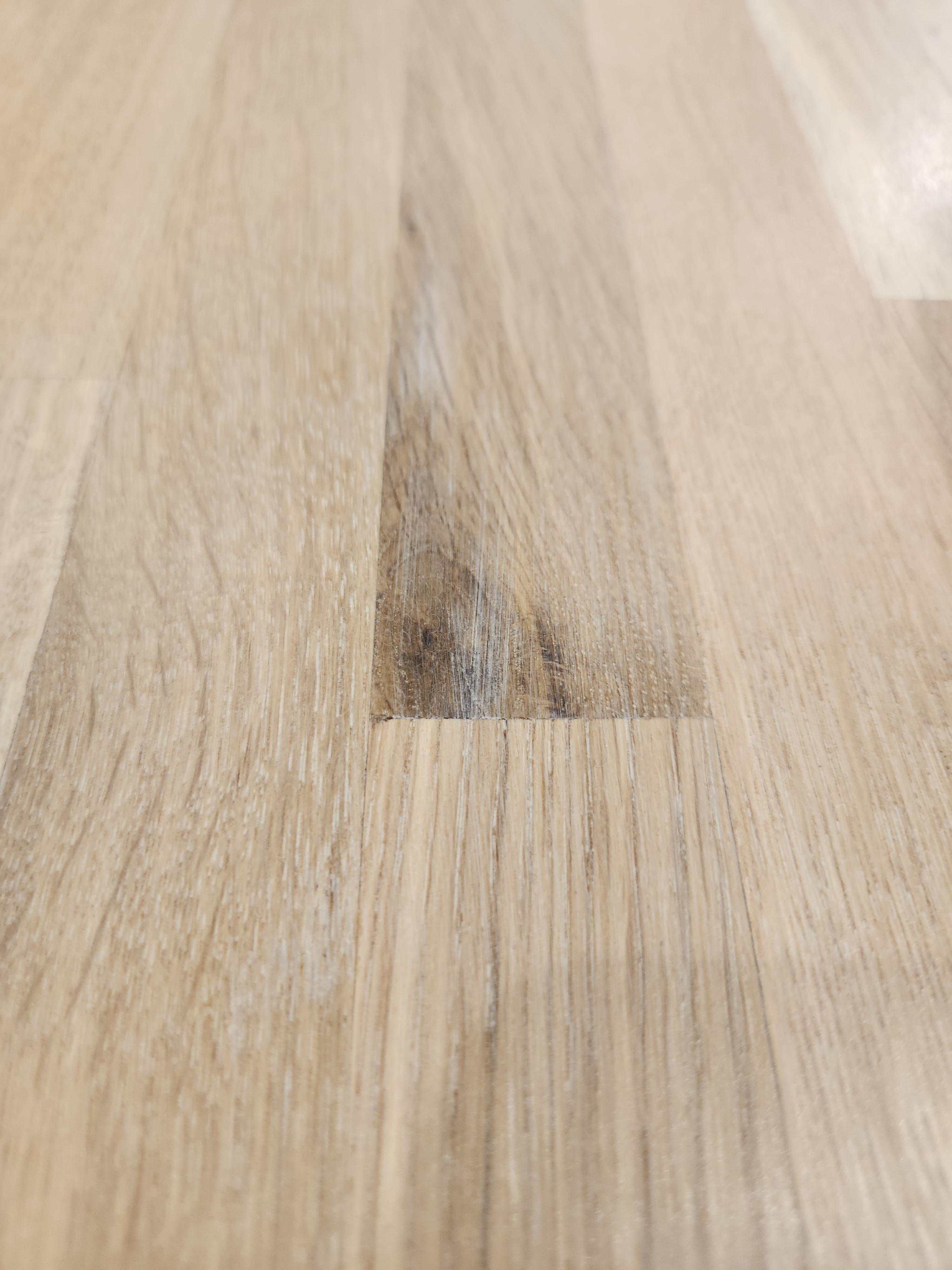

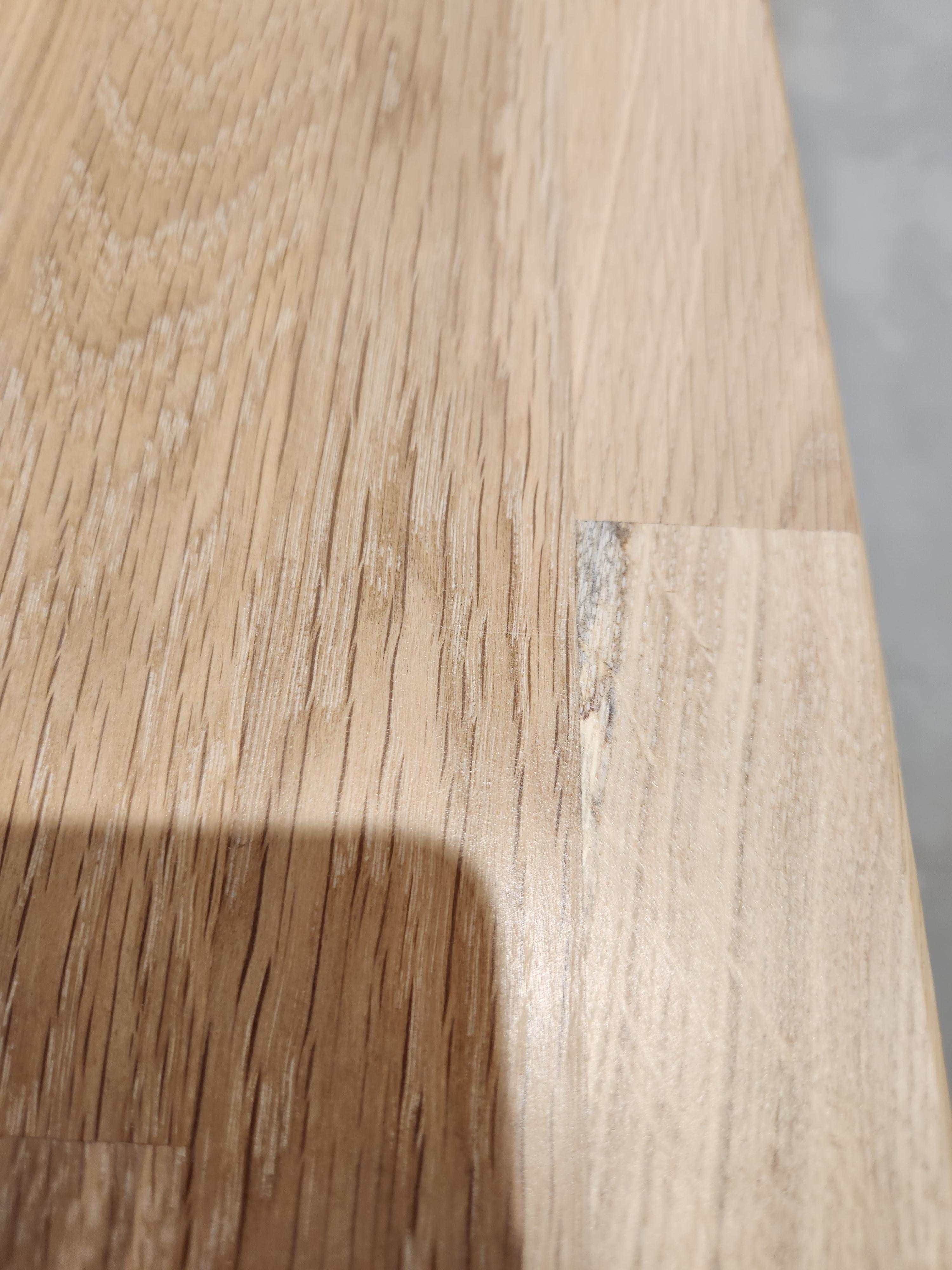

Thanks Nestor. The white pigment does seem to settle anywhere there is a little grain or its a bit rougher due to imperfections like knots, I've epoxied anything large but didn't apprecaite how little it needs to settle and catch in smaller gaps. Overall I really like the look but that does spoil it a bit in places. I think the mistake I've made was not spending more time getting the rough factory belt sanding out so there are some deeper scratches that pick up the pigment.
Instead of sanding (which picks up the fibres) finish by scraping. I use a Stanley (other brands are available) type knife blade and drag along the surface, incline blade slightly towards direction of travel. A few strokes and you will feel the surface is very smooth. You will probably find most of the “whiting” will scrape off as you remove the “fluffy” grain patches

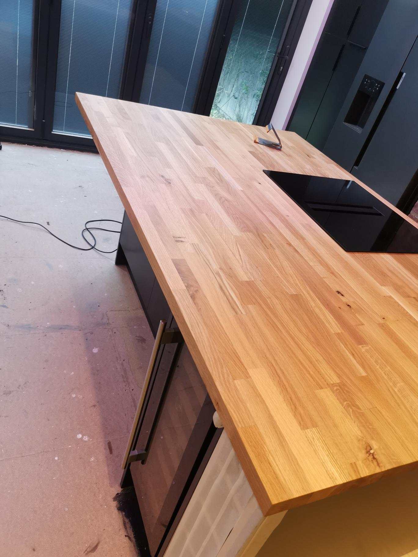

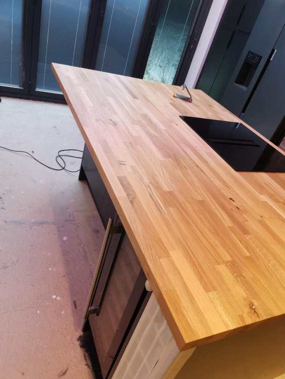

So I thought I'd gotten the tops ready for Christmas, but it was a bit of a let down. They didn't hold up well at all. Plenty of ring marks and water stains. I'd got about 4 coats on and they looked and felt great so really thought they would have held up better. Going to call Osmo tomorrow to see if I've done something wrong in how I've applied. There was very light use on the day as well, much less than how they'll end up being used every day.
The Osmo oil I’ve used in the past said ‘maximum 2 coats’. I can’t see how 4 coats would be a problem but maybe it is? Does your particular oil mention maximum number of coats?

I've spoken to Osmo now and they were happy with the application and number of coats so should have been fine. We agreed to put another fine coat on with a rub down and then to try avoid using as much as possible for a couple of weeks.
