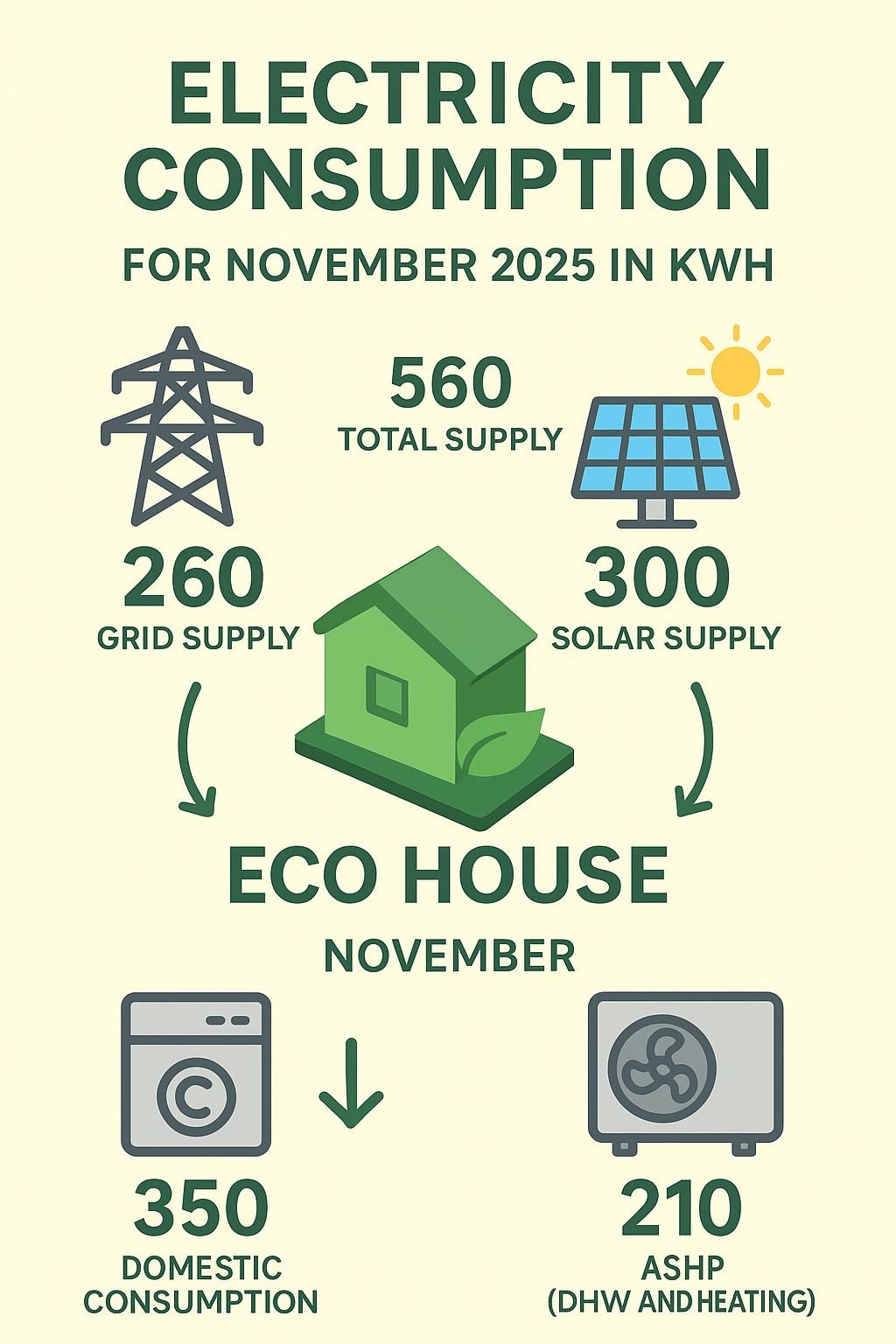

RedRhino Posted December 11, 2025 Posted December 11, 2025 We are entering our first winter in our self-built timber frame house. ChatGPT created a graphic and I thought people might like to see it. With MVHR the good and bad news is that room temperatures tend to equalise; and the rate of cooling is slow so nighttime temps are very similar to daytime temps. On that basis we have just one thermostat on the ground floor which is set to 21c. 220m^2 across three floors. No heating upstairs. Tesla Powerwall 3 to store solar. We only exported about 10kwh in November. 2 1
Nickfromwales Posted December 11, 2025 Posted December 11, 2025 1 hour ago, RedRhino said: We are entering our first winter in our self-built timber frame house. ChatGPT created a graphic and I thought people might like to see it. With MVHR the good and bad news is that room temperatures tend to equalise; and the rate of cooling is slow so nighttime temps are very similar to daytime temps. On that basis we have just one thermostat on the ground floor which is set to 21c. 220m^2 across three floors. No heating upstairs. Tesla Powerwall 3 to store solar. We only exported about 10kwh in November. Great post, thanks for sharing here. Can you use the ASHP to cool? Doing that for a few hours in the afternoon to early evening may help knock off 1° which would be quite significant for having cooler rooms when you are looking retire each evening.
