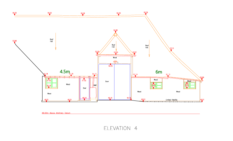

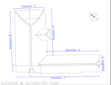

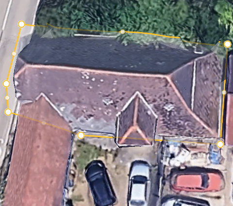

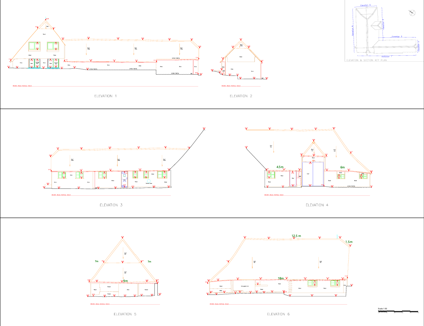

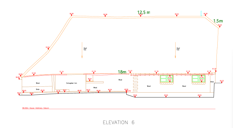

I'm looking to place an order for some reclaimed roof tiles in readiness for a roof replacement on my barn as part of its conversion to a residential dwelling. I could use some help figuring out an approximate number of tiles I'd need to order.
I'm looking to use Rosemary clay tiles which are  265mm x 165mm. 60 tiles per m2. I know I'll need eaves tiles and tile and a half's too but for now I'm looking to get the bulk of it ordered.
The part of the roof I'm looking to replace are elevations 4, 5 and 6. I have attached reference images of the roof and measurements (in green) which I took myself using the 1:50 scale from the drawing.
Is there any info I'm missing?
Thanks all
