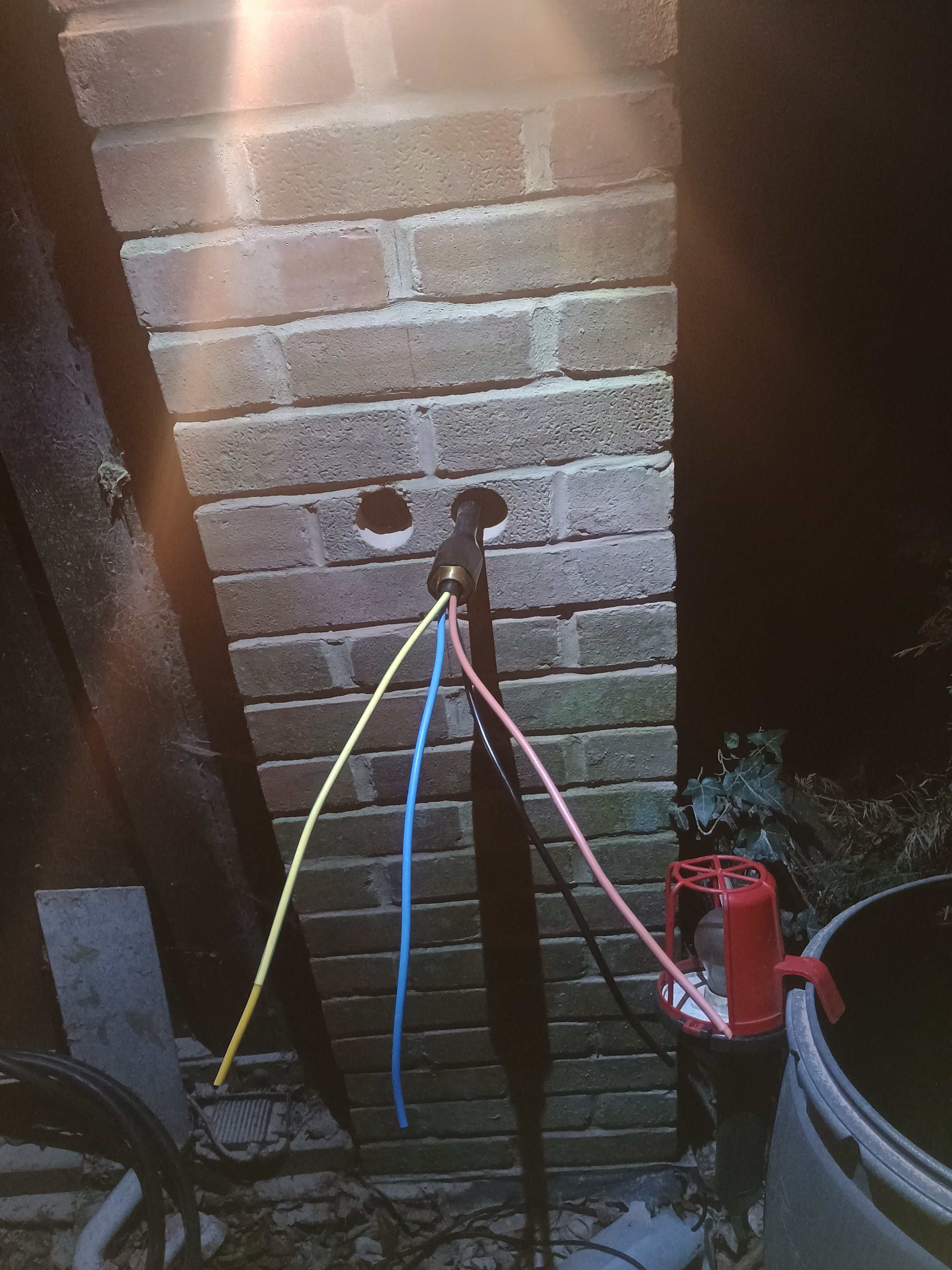

Onoff Posted November 27, 2025 Posted November 27, 2025 Just run separate SWA and Cat-6e to your EV charger like I am:

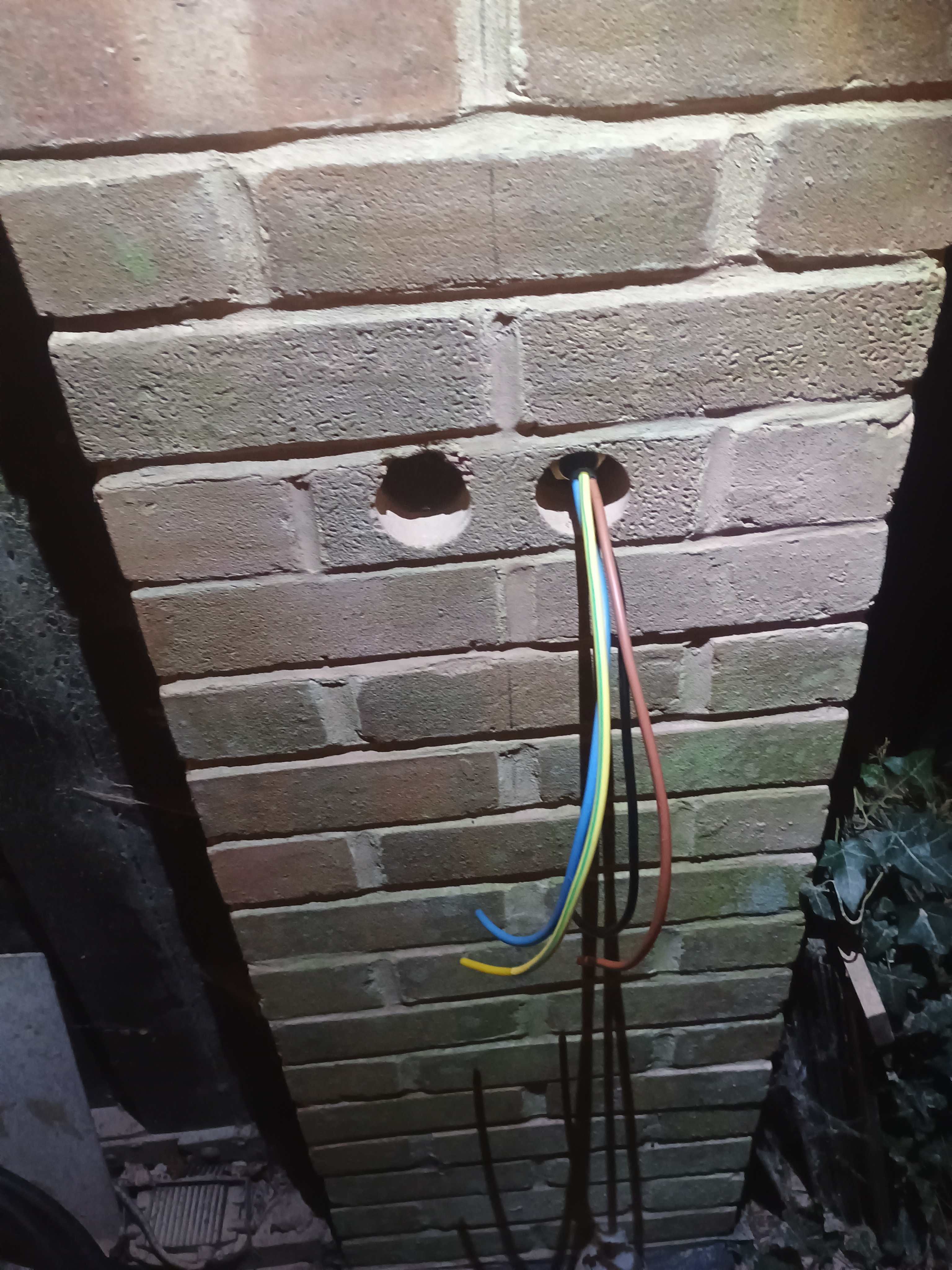

Onoff Posted November 28, 2025 Posted November 28, 2025 Mine in the picture above is old colours, red, yellow,blue,black 10mm². Red sleeved with brown, blue as is, yellow sleeved with green/yellow and black left spare. I'm coming in through the back of the EV charger as coming up into the bottom is just plain fugly imho.

Onoff Posted December 1, 2025 Posted December 1, 2025 I've got a 10mm² SWA running to the charger point. Then a 20mm flexible duct cable tied to the SWA with a Cat-6e in. 1
