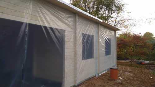

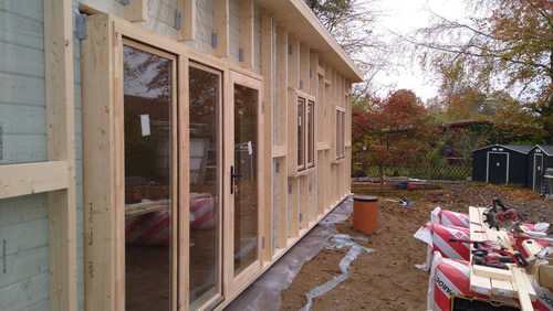

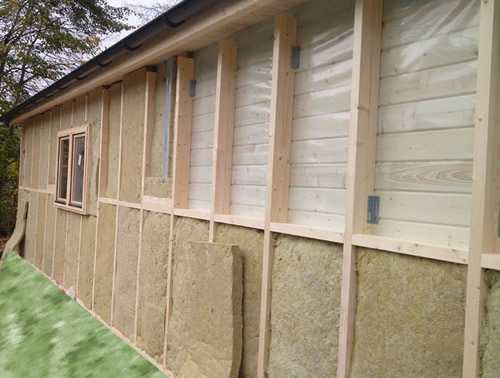

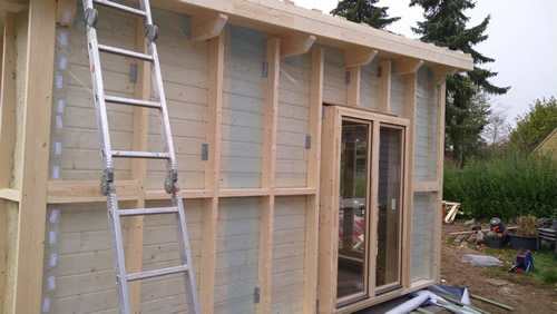

Finally on the back end of restumping our 12 year old log cabin and starting to think about details for the insulation and overcladding of the walls. I’m following the idea shown in the attached pics (photos from logcabinkits.co.uk) but worried the vapour barrier would trap any existing moisture in the logs.
Improving the air tightness would be great but struggling with concept of wrapping wood in plastic. Would one of these fancier “smart” barriers be better? Any suggestions?

I take it the pic with the clear plastic on the outside is just temp rain-cover?

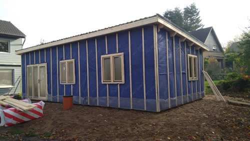

Thanks, I'll take a look at that Intello. Assume it's one of these smart membranes. The pics are not mine but the clear plastic looks to still be there after the insulation frame has been fitted, Assume its their vapour barrier.
So you think the insulation went outboard of that?
Yes. They started with a log building (similar to mine), 3rd pic down is their vapour barrier, 2nd and 4th pic they have added the timbers in which batts will sit, 1st pic shows batts being installed. 5th pic shows their breathable membrane and battens ready for cladding.
