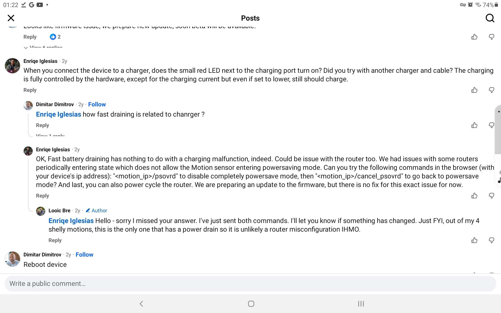

Found this on that last link above..

Thanks @Temp, as the last comment on the thread you found says, I’m in the same boat: I have three Shelly motions and yet only one has this problem. I will try rebooting it, as I’m not sure how to communicate with it via the browser. Do they mean just a web browser?
Posted
Yes it appears to suggest you just browse to the URL..  <motion_IP>/psovrd   (replace <motion_IP> with the IP address of the device) then to <motion_IP>/cancel_psovrd.
I don't know if it will actually return a web page each time.
