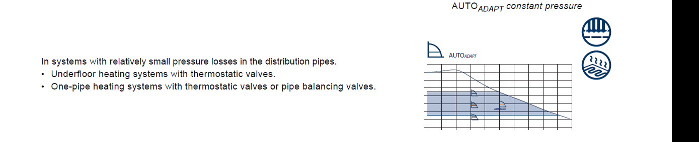

OldSpot Posted Sunday at 12:42 Posted Sunday at 12:42 I've got a Grundfos UPM3 AUTO 25 70 130 on an Ivar UFH manifold. Just trying to work out why you wouldn't just run it in the "Constant Pressure Auto Adapt" mode as opposed to any of the other 3 Constant Pressure settings as this seems to cover all bases? Or have I completely misunderstood!?

OldSpot Posted 8 hours ago Author Posted 8 hours ago Thanks for your reply John. As you allude, there is a difference between PP and CP and the UPM3 AUTO has auto adapt for both. I think in your answer you're talking about the PP not working properly not the CP auto adapt?
John Carroll Posted 6 hours ago Posted 6 hours ago Yes, correct, I don't really see though why it should be required or even work on a UFH manifold, where, each system will have its own manifold pump so, irrespective of how many zoned systems are on or off, the flowrates shouldn't change?, why don't you switch over to (CP) Auto Adapt and see what effect it has on yout loop flowrates.
