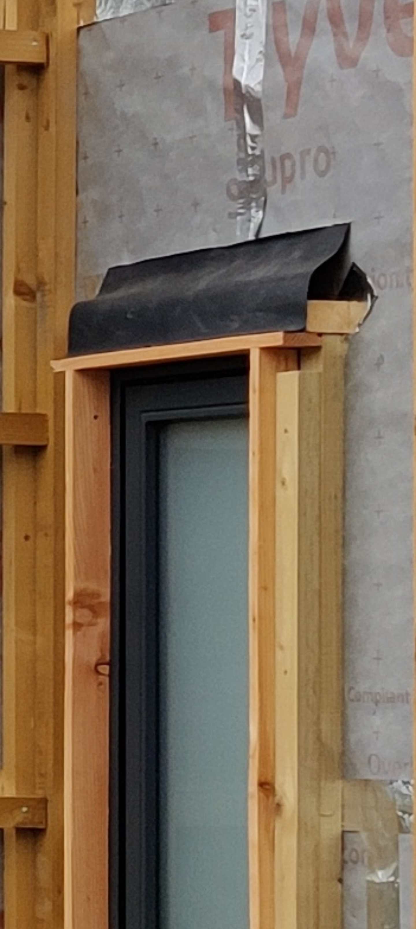

marmic Posted October 30, 2025 Posted October 30, 2025 hello all, anyone know please if a preformed flashing like this/similar is available off the shelf from anywhere? so far not found.......... (25mm vertical battens + 21-25mm horizontal cladding/reval boards). ideally anthracite grey to match windows and roof. or if not best/easiest/recommded thing to use? be interested of course to know what others have used please................... many thanks

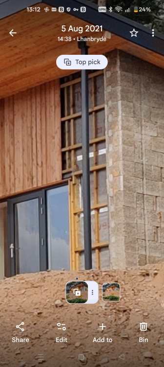

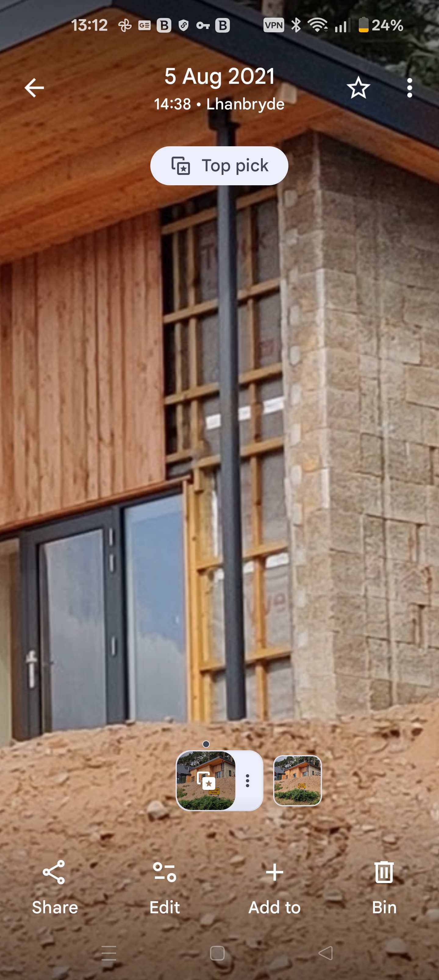

JohnMo Posted October 30, 2025 Posted October 30, 2025 I used a wide DPC Not the best photo, but should give you the idea
JohnMo Posted October 30, 2025 Posted October 30, 2025 A slightly more advanced photo with more of the battens in place, you will insect mesh as well to wasps out etc.
marmic Posted October 30, 2025 Author Posted October 30, 2025 many thanks - was thinking that as a possibility if I couldnt find a more purposeful trim and already have a roll here....... I did same on a garden office (posh shed!) few years ago at last place but wrapped it down over and stapled to the front edge of the reveal board (which were gravel boards!) - not sure how well it will withstand UV / full exposure etc.
