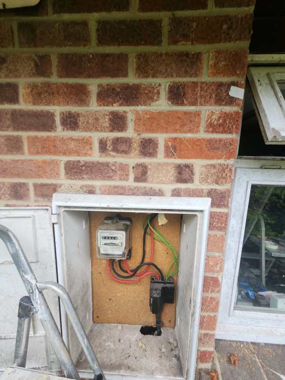

cor Posted October 16, 2025 Posted October 16, 2025 query i have 3 core 10mm SWA coming from garage to consumer unit and was thinking the best way to do this? plan was a junction box to terminate SWA and then feed double insulated meter tails into meter box to separate / or dual pole henly blocks the meter box wont fit a meter box fuse switch like: Lewden 100A 1+N 100A Metal Fused Switch - Screwfix but i would just fit this type instead. Click Scolmore DB700 80A Fused Main Switch | Toolstation garage will have its own CU - i have 10mm SWA about 26m(12m in a trench) to feed lights and ring- may have a compressor and welder in there for basic car repairs , mid height lift potentially, no EV but space will be left on a CU for it. electrician will do all the formal connections/ testing / reg with council but was just sorting all the cable routing to the meter box and garage meter box attached for info TIA cormac
JohnMo Posted October 16, 2025 Posted October 16, 2025 6 minutes ago, cor said: 10mm SWA about 26m Have you done voltage drops calculation for expected loads? Sounds a bit small 10mm²
cor Posted October 16, 2025 Author Posted October 16, 2025 i did a estimator on tlc and pretty sure it came as 10mm.....should it be 16mm.. or more then
cor Posted October 16, 2025 Author Posted October 16, 2025 worked on the premise that not all equipment will be on at the same time- havent bought any of the below yet so its just lights and plugs and electric roller doors atm compressor 2200w lift 2200w 8000w welder 7700w ev charger- dont have one anyway more for later if ever lights are led 180w used 10kw as a power
JohnMo Posted October 16, 2025 Posted October 16, 2025 Isn't the norm for motors 4x rated capacity? All the equipment you have listed I would be doing 25mm².
cor Posted October 16, 2025 Author Posted October 16, 2025 I was going on the lines of the initial start up of motors being high demand less after and needing a type c rcbo or mcb... And not using 2 at the same time.
