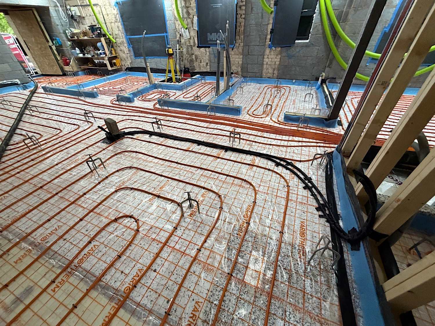

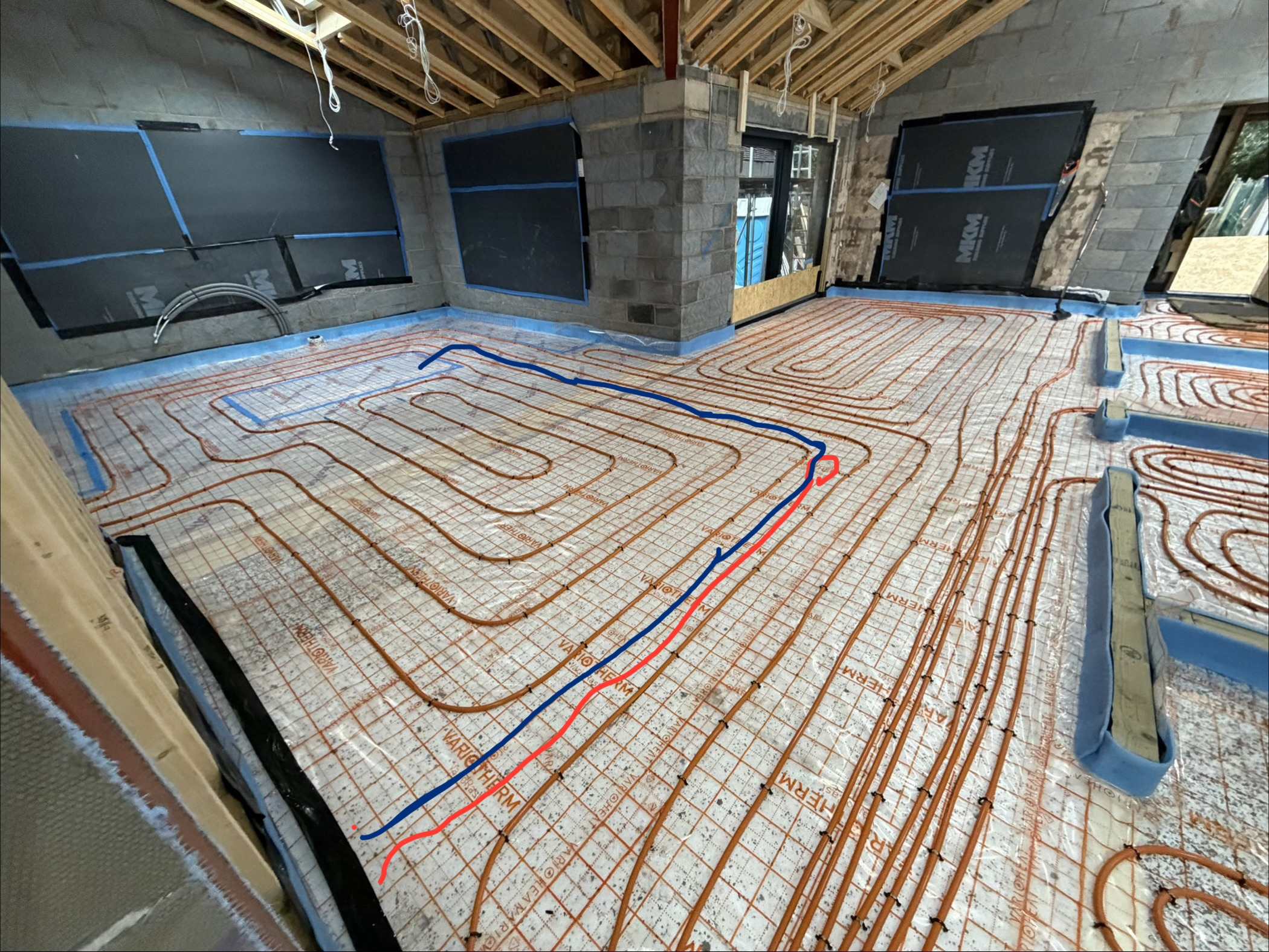

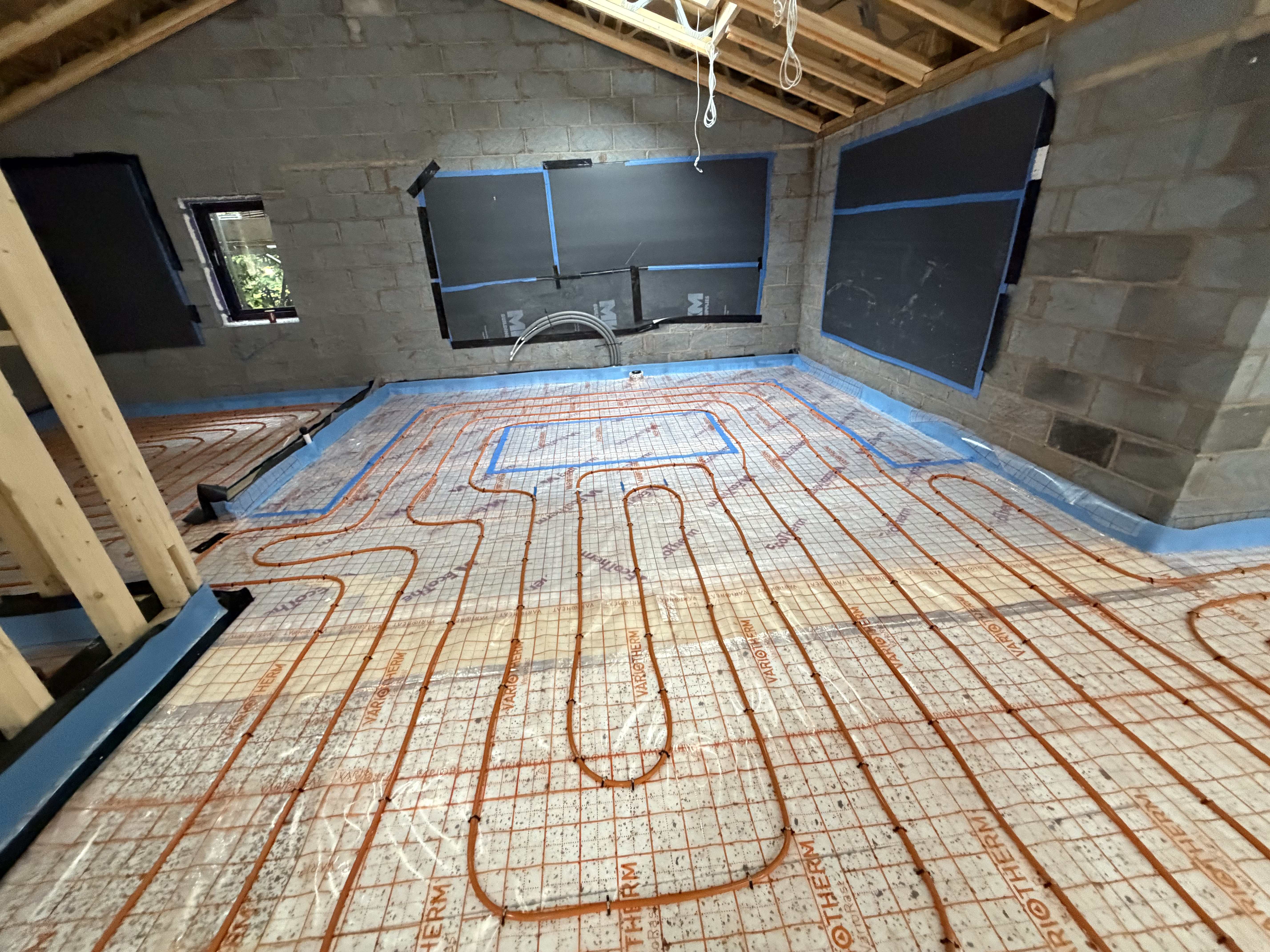

Hello folks. I have around 250mm of insulation with some water pipes underneath and UFH pipes installed on top.

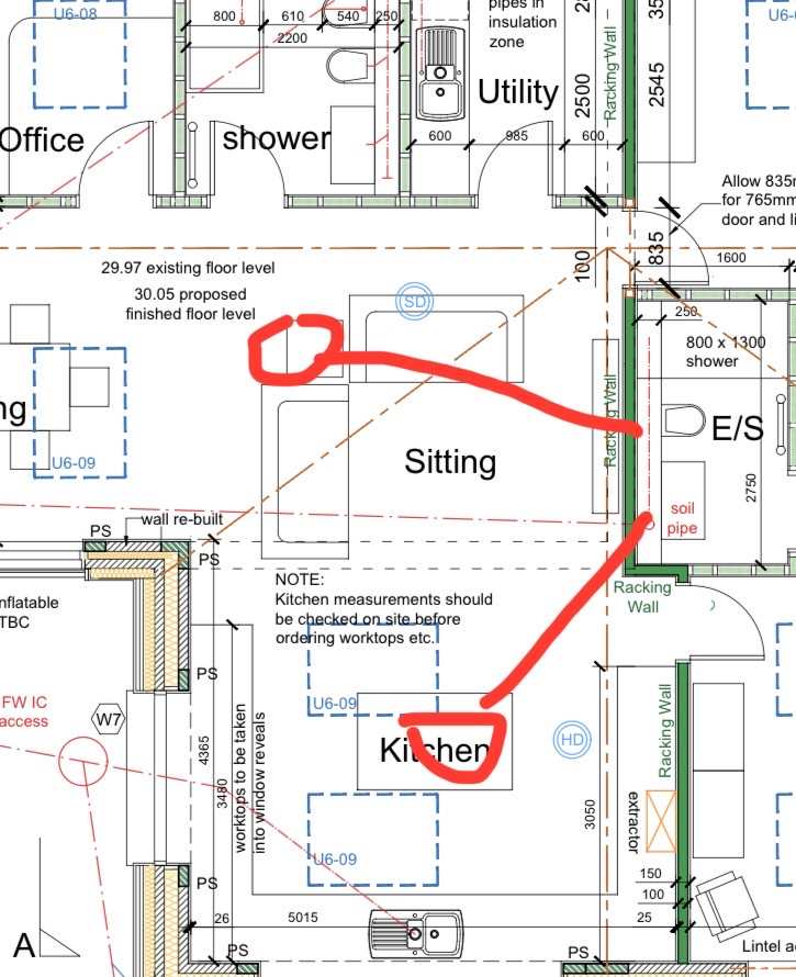

I've just realised I need networking / power and speaker cable to next to my sofas and kitchen island.
See above pictures, do I panic cancel the screed company who are due at 9 or is there something I can do in a few hours before they arrive?

If you are unable to fit the cabling now, fetch some 32mm ducting from somewhere and lay that, feed a drawstring so you can pull through the cable later.  Lay it as straight as you can.
Posted (edited)
Oh and take pictures/measurements of where the runs are in case you need to do any work on the floor nearby

Wickes or equiv, will do all you need.... Small drainpipe (for shed guttering etc) , and or white sanitary drain pipes would work as Ducting as well.
Use duct tape to seal the joints together,to avoid any liquid seeping in.
https://www.wickes.co.uk/Products/Heating+Plumbing/Plumbing/Waste-Pipes+Fittings/Solvent-Weld-Pipes+Fittings/c/1000550
They open at 8ish, so grab, go and push fit, and you'll be having a cup of coffee by the time the screeders arrive!!

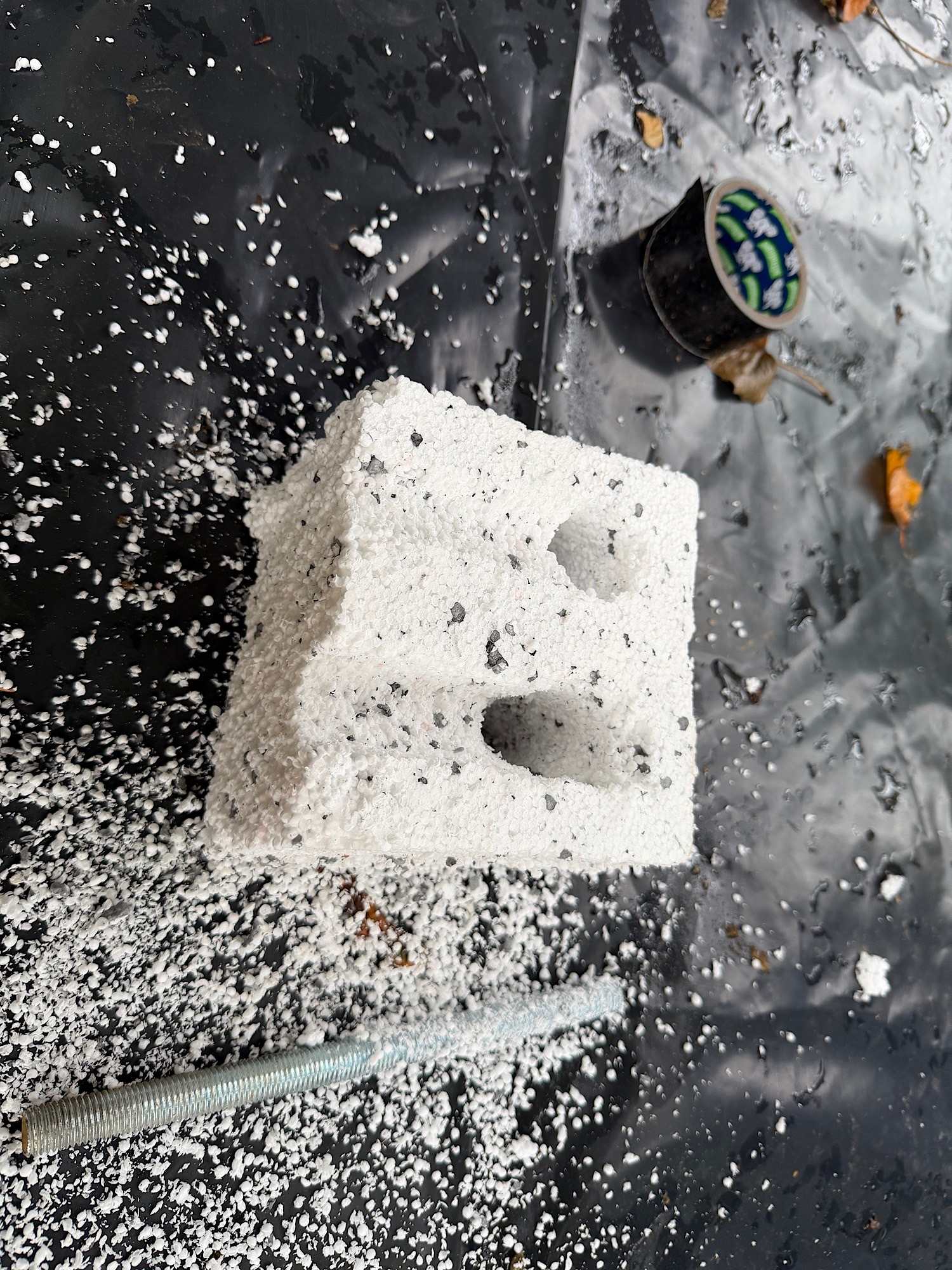

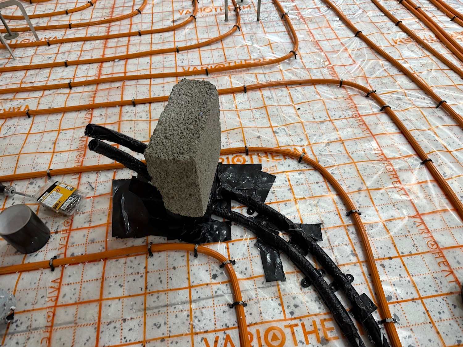

11 hours ago, boxrick said:
What would you hold it down with?
I'm worried it will float. Also got potential crossing of UFH

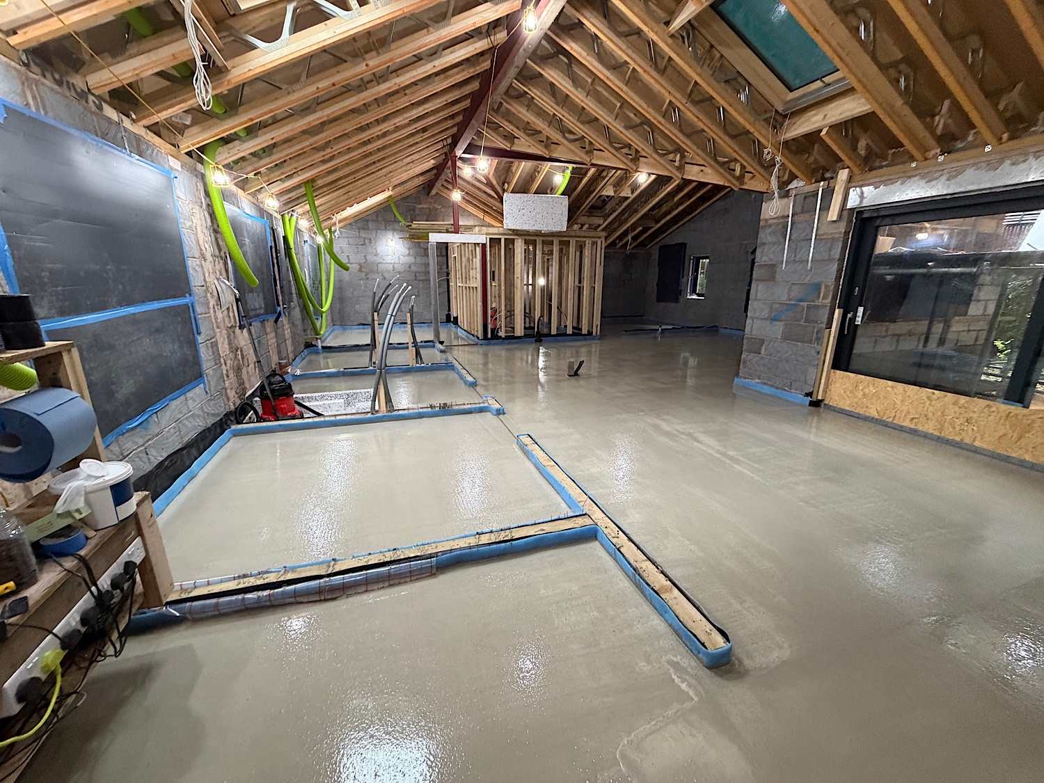

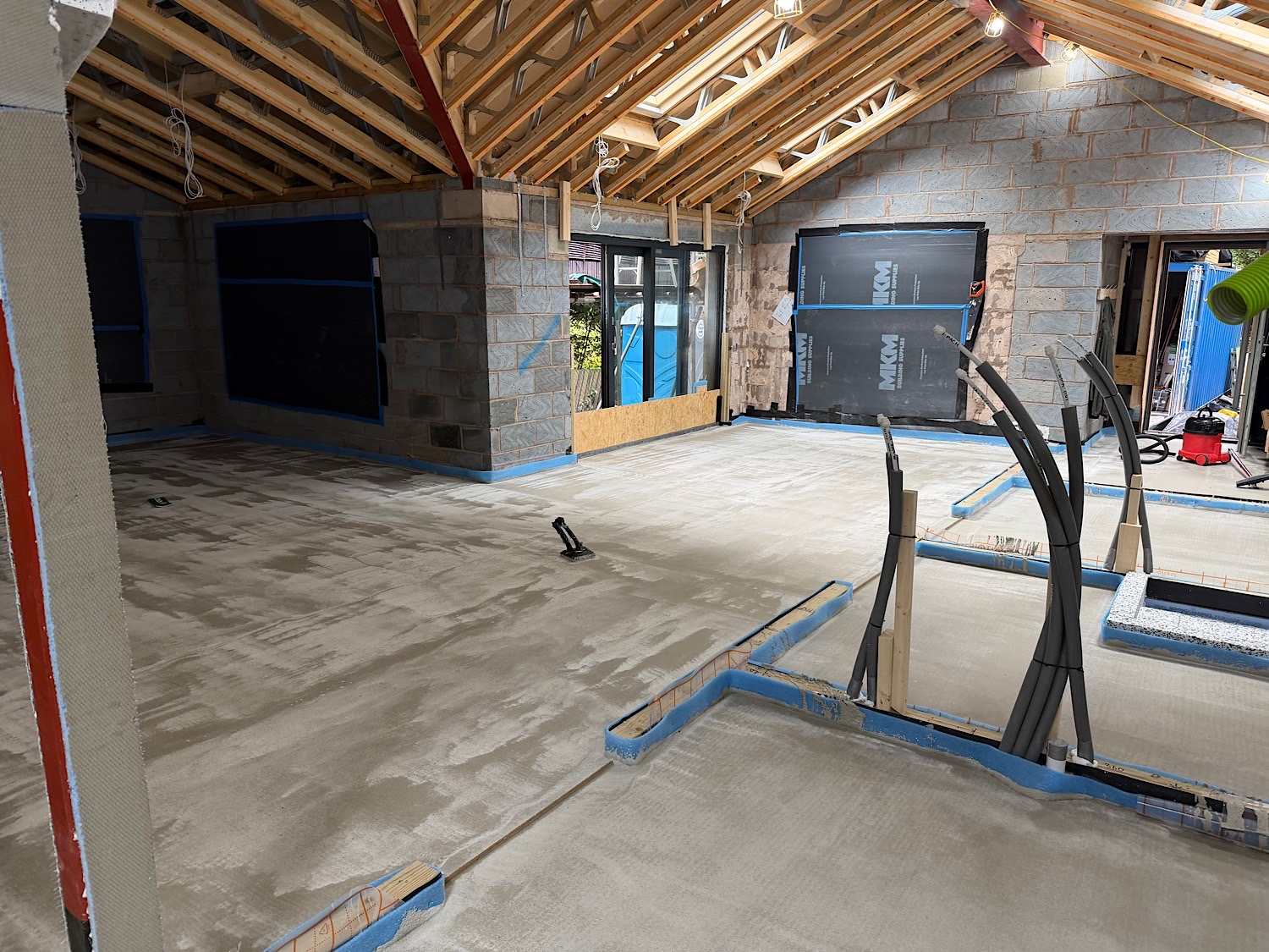

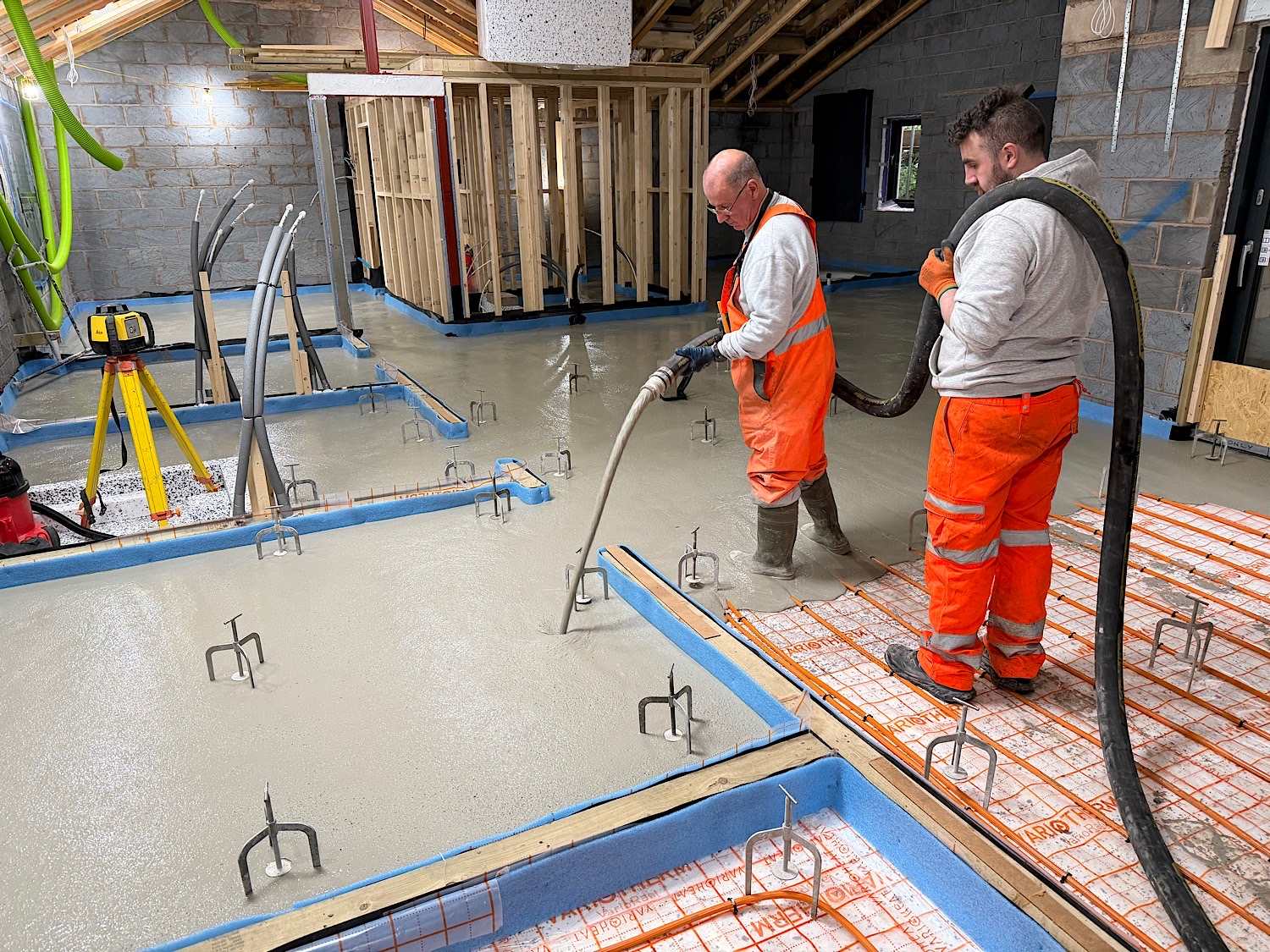

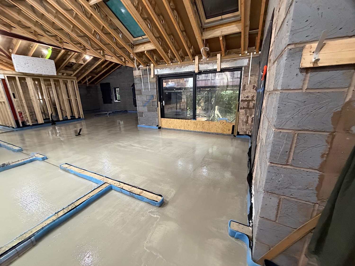

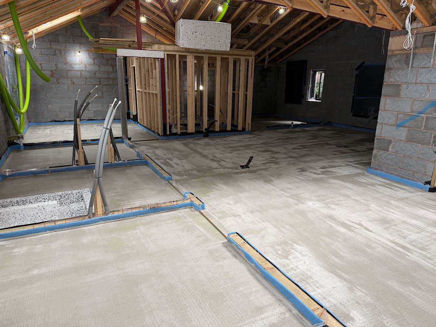

Posted
Mad rush to screwfix.
I got a few ducts in one location but not the other... threw them in as they were pouring the screed.
Better than nothing..
