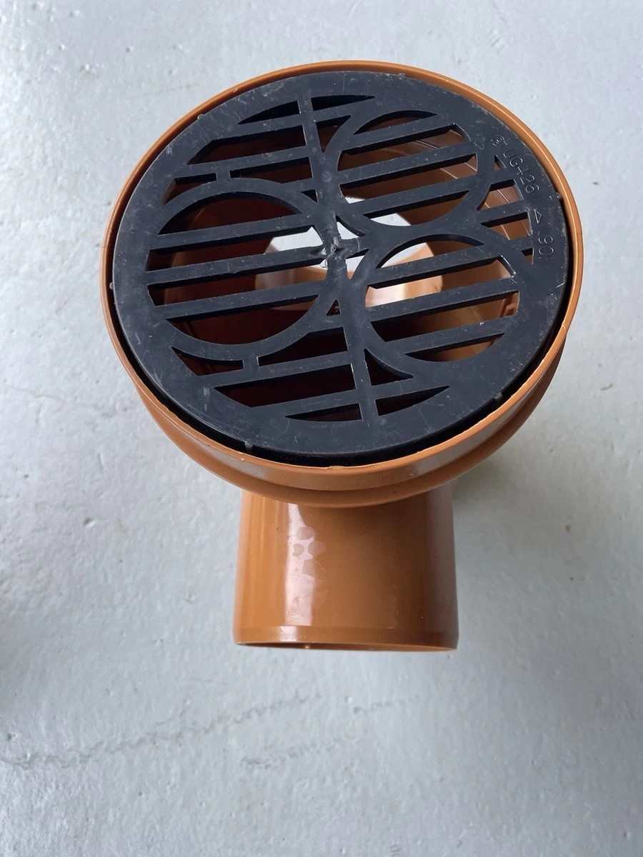

Does anyone know, does the polypipe UG427 back inlet bottle gully come with a trap?
In photos I find online it doesn't look like it, which seems strange?

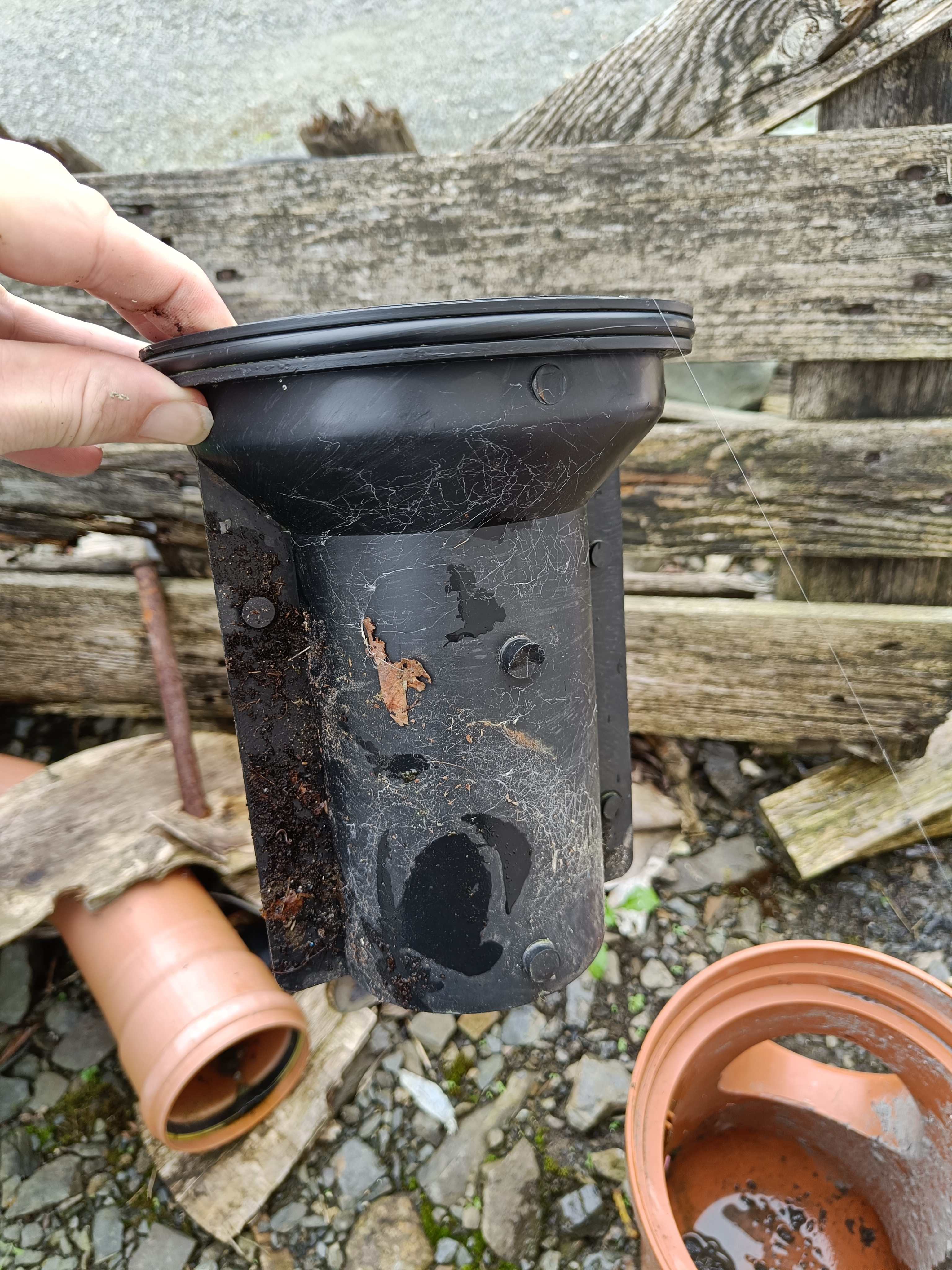

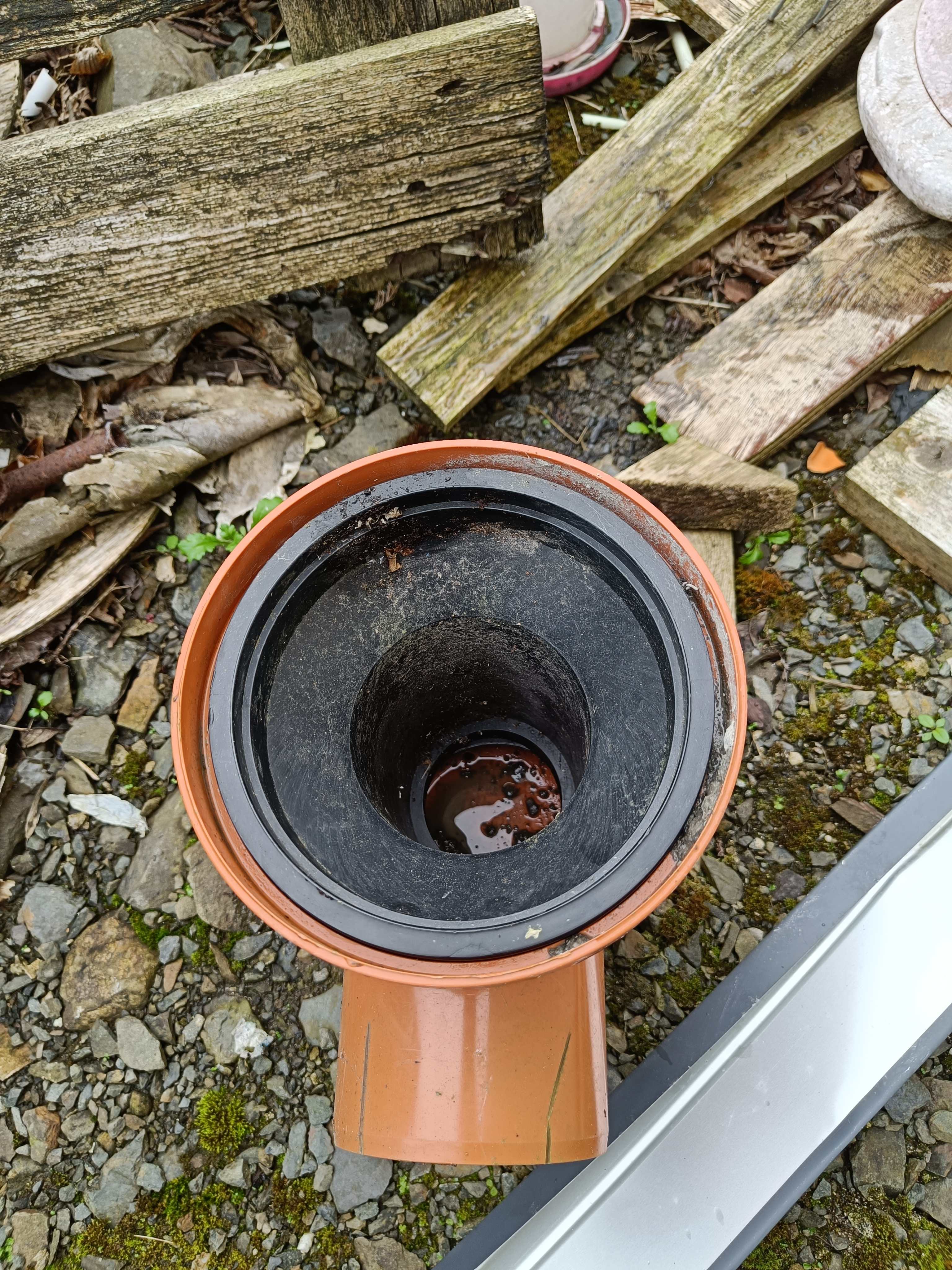

Yes should have an inner black sleeve that slots into those guides on either side.IMG20250919165726.thumb.jpg.2f0a2f23460df1deb95f10f367e45f24.jpgIMG20250919165713.thumb.jpg.2e9dbde6c0cdbc187b6552067bafe267.jpg
