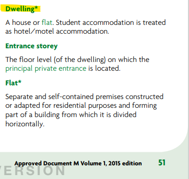

Beagle2 Posted September 9, 2025 Posted September 9, 2025 Hello, I have planning permission to convert a detached outbuilding into a small 'ANNEX' (not a 'dwelling'). The annex is just for visiting relatives and will have one bedroom and a small ensuite bathroom. No kitchen and will not be self-contained in relation to the main house . I want to design the bathroom and wish to know the minimum size I can make it. Can anyone help with which 'Part M applies? Here are the options: Volume 1 - Dwellings Volume 2 - Buildings other than dwellings Or Part M doesn't apply? The regs give the following definition of a dwelling.... our annex is not a 'house or flat'.... Any ideas greatly received, thanks

Temp Posted September 9, 2025 Posted September 9, 2025 That's good because I think if it had to be "incidental to the main house" a bathroom isn't allowed. I'm reasonably sure Part M won't apply as its ancillary to the main house not a new dwelling. If you decide to ask Building Control I would emphasise that. 1
kandgmitchell Posted September 10, 2025 Posted September 10, 2025 I'd echo Temp's comments. Volume 1 applies to new dwellings and this is not a new dwelling but is ancillary to an existing one. With no paying guests BC shouldn't try to apply Part M Volume 2, so you should not have a problem. 1
