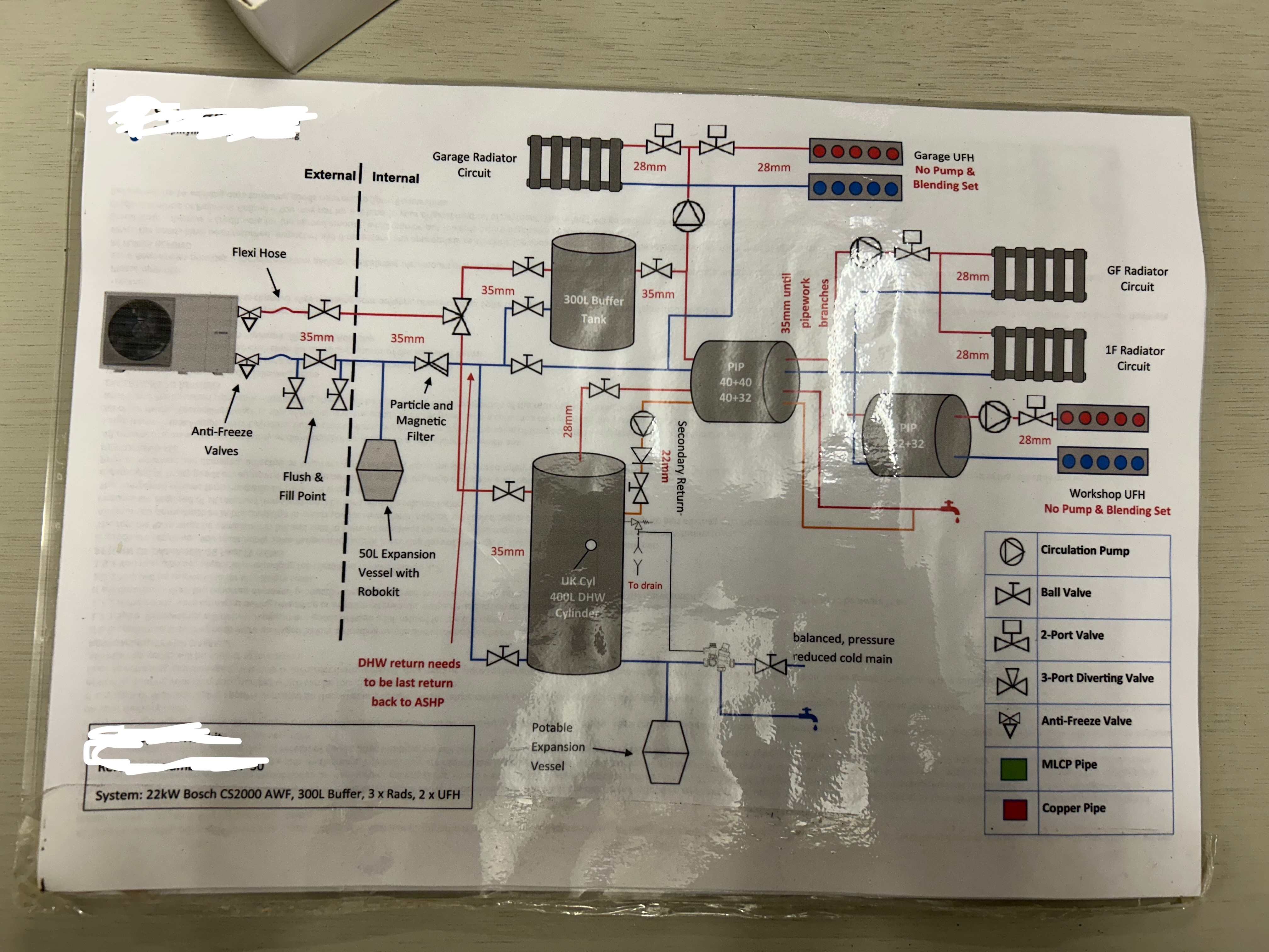

d438a1 Posted September 4 Author Posted September 4 Yeah, thanks. See attached for current progress of works. One thing I haven't finalised yet is how to control it all. Any recommendations? Obviously I want full smart control. And is it worth making use of controlling the lower and upper immersion for occasions I do need to use? Thanks
JohnMo Posted September 4 Posted September 4 41 minutes ago, d438a1 said: Obviously I want full smart control Not really that obvious, nor the best. My view is a simple one, run weather compensation, you then need no control. Looking at your schematic, there are no mixers, which is good, so means the radiators and the UFH have the same flow temp, so should be easy to do just straight WC. Gives the best CoP generally, so lowest running costs. your other option is to do WC with set forwards in cheap tariff periods, here you would use a timer to up the WC curve to second set point 1 or 2 degs warmer, this then means when outside the cheap period the heat pump works less hard, so a little less likely to run down the battery too quickly. Fully open system (nearly) gain good. Your buffer is a 3 port, so a good compromise. Do a search on 3 port buffers to see the advantages and disadvantages.

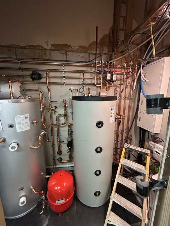

d438a1 Posted 11 hours ago Author Posted 11 hours ago So it's all up and running and on weather comp. Starting to understand the comments now. Just had it running with room/house sat at 20 degrees and it's just a nice comfortable temperature all day long. Did have a few questions.. 1. Was disappointed as I should have done more reading, but the worcestor compress 2000 I have does not have any smart app capability. https://www.worcester-bosch.co.uk/professional/compress-2000-awf. It's not a big deal, but certainly would have been nice to see some of the data and info, especially given the unit is not in same building as house. Certainly I did want to be able to control the hot water at times, e.g when going on holiday. Does anyone know anyway to delegate the hot water control from the unit? It does allow for the stat to be delegated, and the installers set me up with the EPH stat and gateway for that. As FYI my understanding is this unit is a rebadged Midea who themselves do have smart capability. 2. There isn't any sensor attached to the buffer. Is that normal? I would have thought the heat pump would need to know the temp of buffer tank else it's just continously running potentially unncessarily? 3. When the MCS guy came on Friday to sign off he commented that it's better practise to ensure the controls are wired so that if all zone stats are off, it also shuts down the heat pump itself. But my installers said "It's wired correctly. It's to always heat the buffer, it's far more efficient, stops short cycling, and gives you quick heat up times in the cold months". Any thoughts on this one? Thanks as always.
