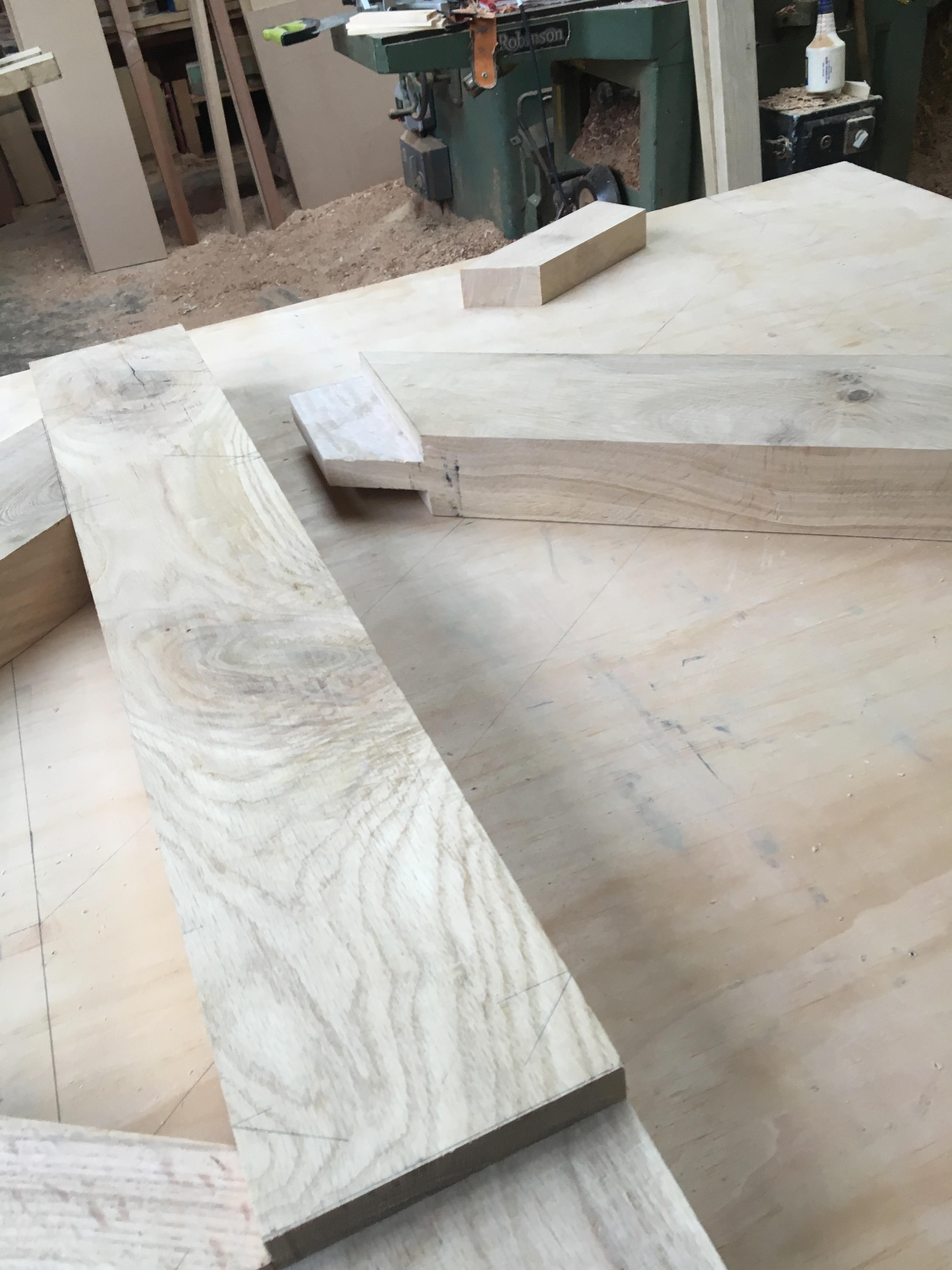

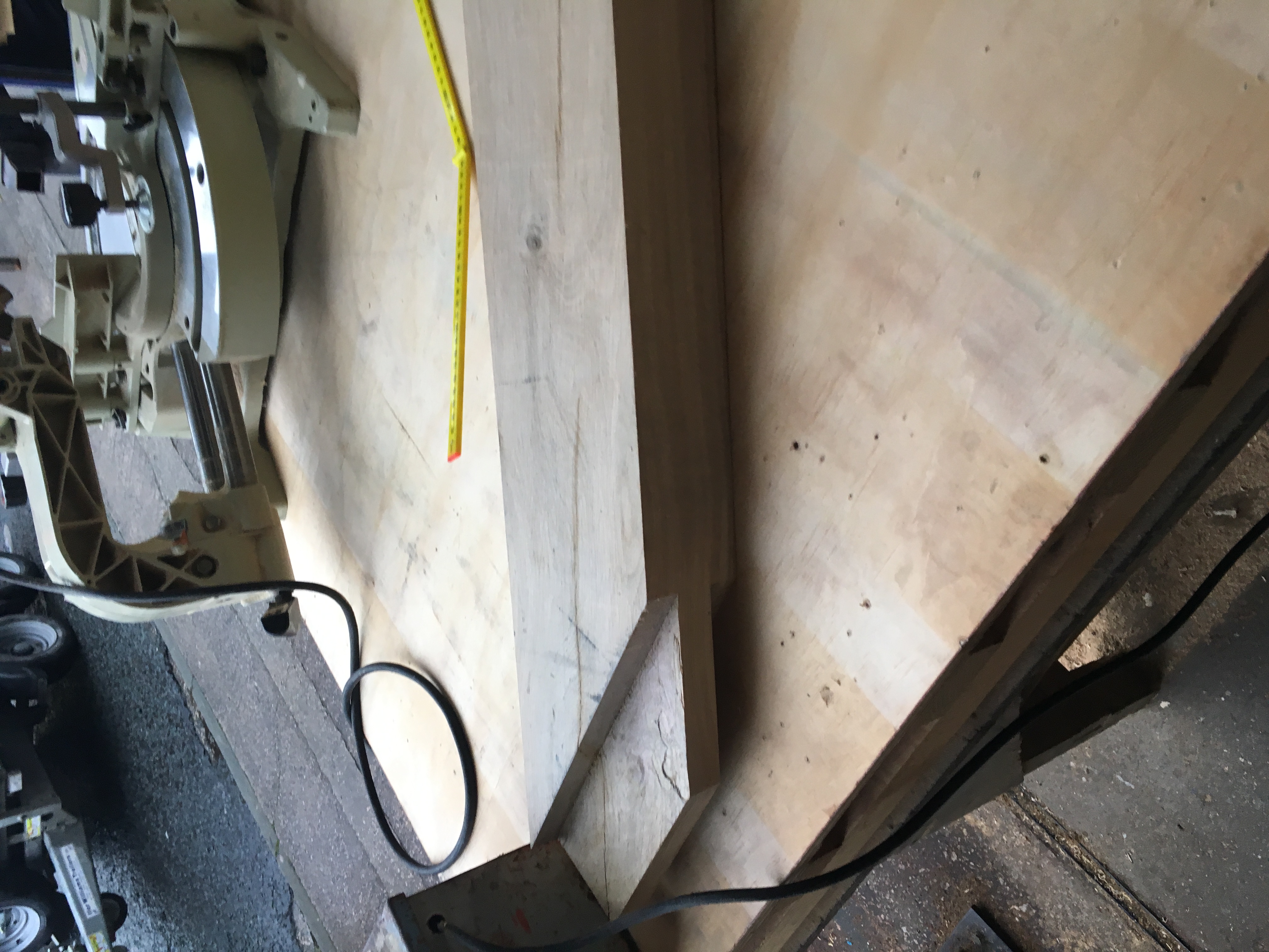

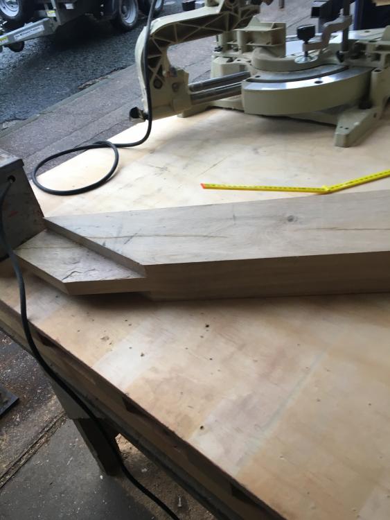

As I’ve previously stated I’m trying to get on with the oak canopy
No chance of fitting in this rain and high winds

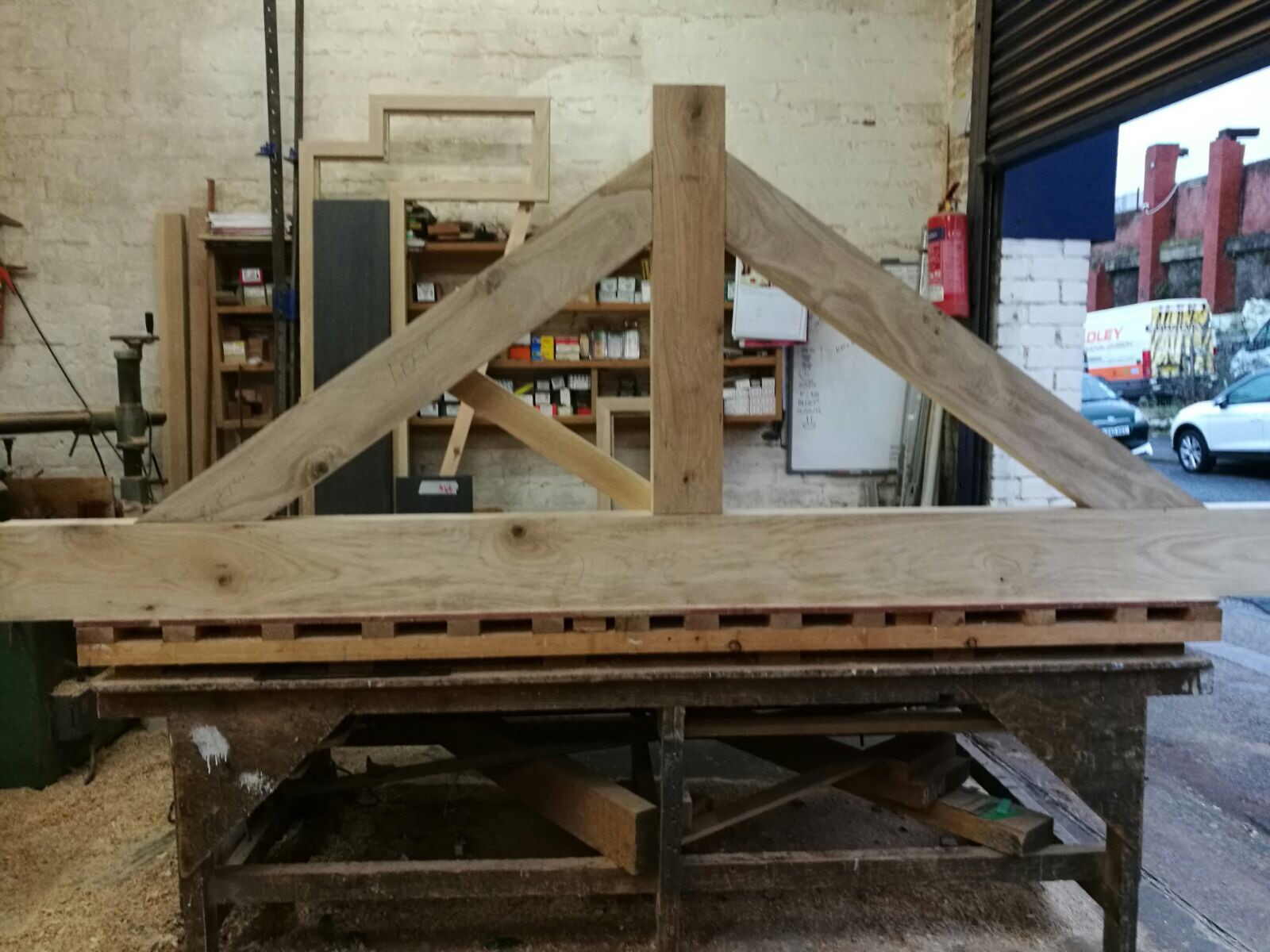

ive had to go back to planners as the Architect had drawn this supported by gallow brackets
The full section pictured Just needs two diagnals then glueing
Two Of is can Just about lift it off the workbench
It will take four of us to lift this one section into place
Ive built two small pillars with square top caps To sit the 6x6 oak pillars on Months ago and asked the Architect to speak to planners
Hes says that he has done simalar designs and never had any issues
I spoken to the engineer today
He was a great help
He said if I build it out of bolder wood I should be ok
He did a quick calc and said the Gallow brackets would have to extend virtually down to the floor to have any chance of supporting it
and to push on and get it fitted
