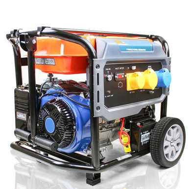

No it doesn't for a new build house, a 7.9kW geny isn't big. It will allow heat pump to start stop and run while the hob is on cooking the tea. Any Watts excess can go into the battery.
Maybe not for you but our 2.2kw honda unit is as much as I'd want to carry around when the lights go out. A backup heat source other than the HP also covers you for heat pump failure.
It's on wheels, pull out of shed, use proper extension to plug into house (external socket), flick the change over relay, full house has power.
£700 for geny, £50 for changeover switch, lots cheaper than an oil boiler, tank etc.
