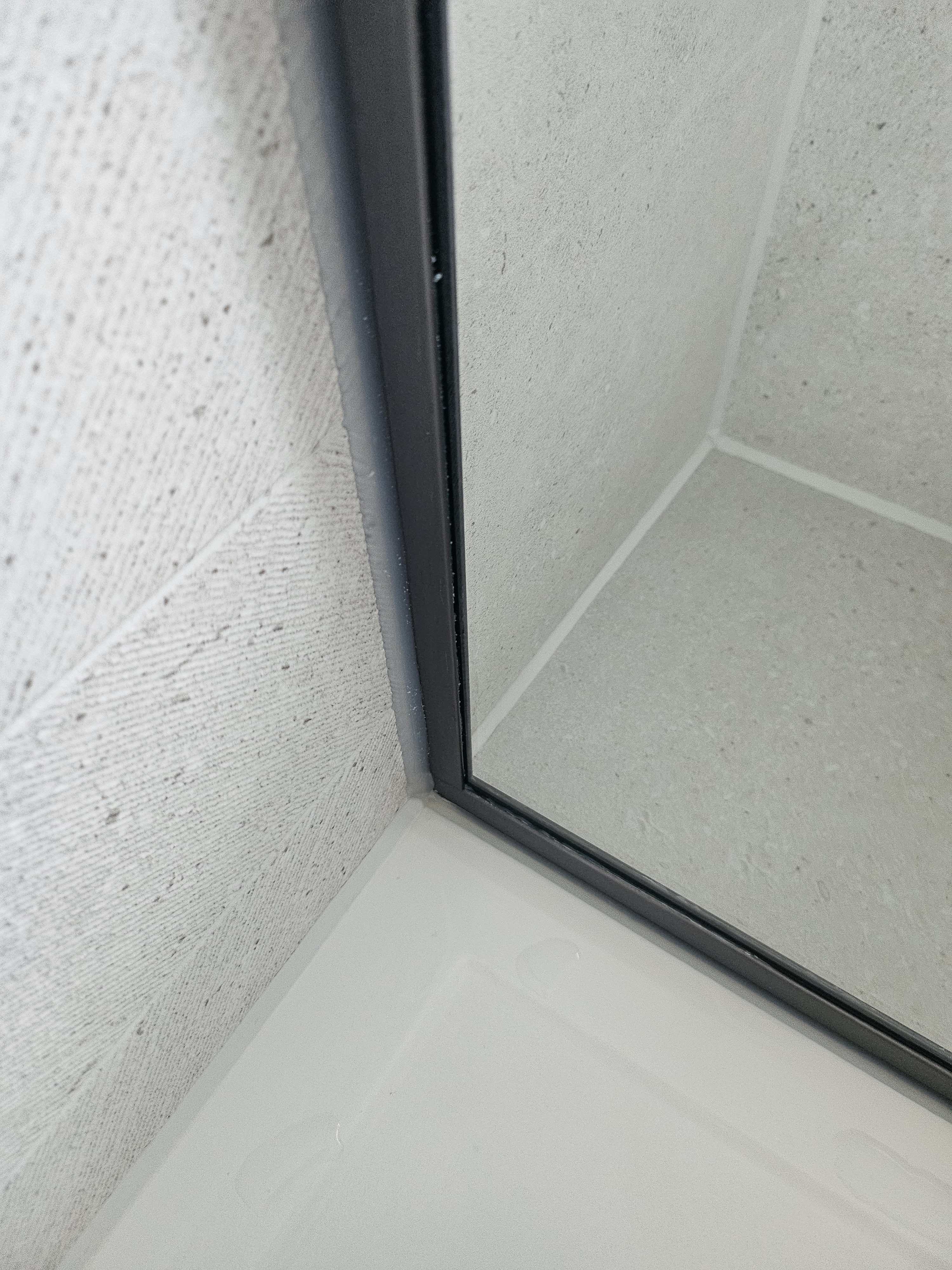

It's driving me nuts.  Had a shower screen installed. The shower glass has water seeping through. It's not seeping from the tile and behind the channel, it seems to be seeping from where the glass meets the channel towards the middle of the wall.
I had a profession silicone guy come and seal the whole shower also. Why is water coming out from a gap in the shower screen and channel frame?
Btw I have the same glass installed on the other side and don't have issue.

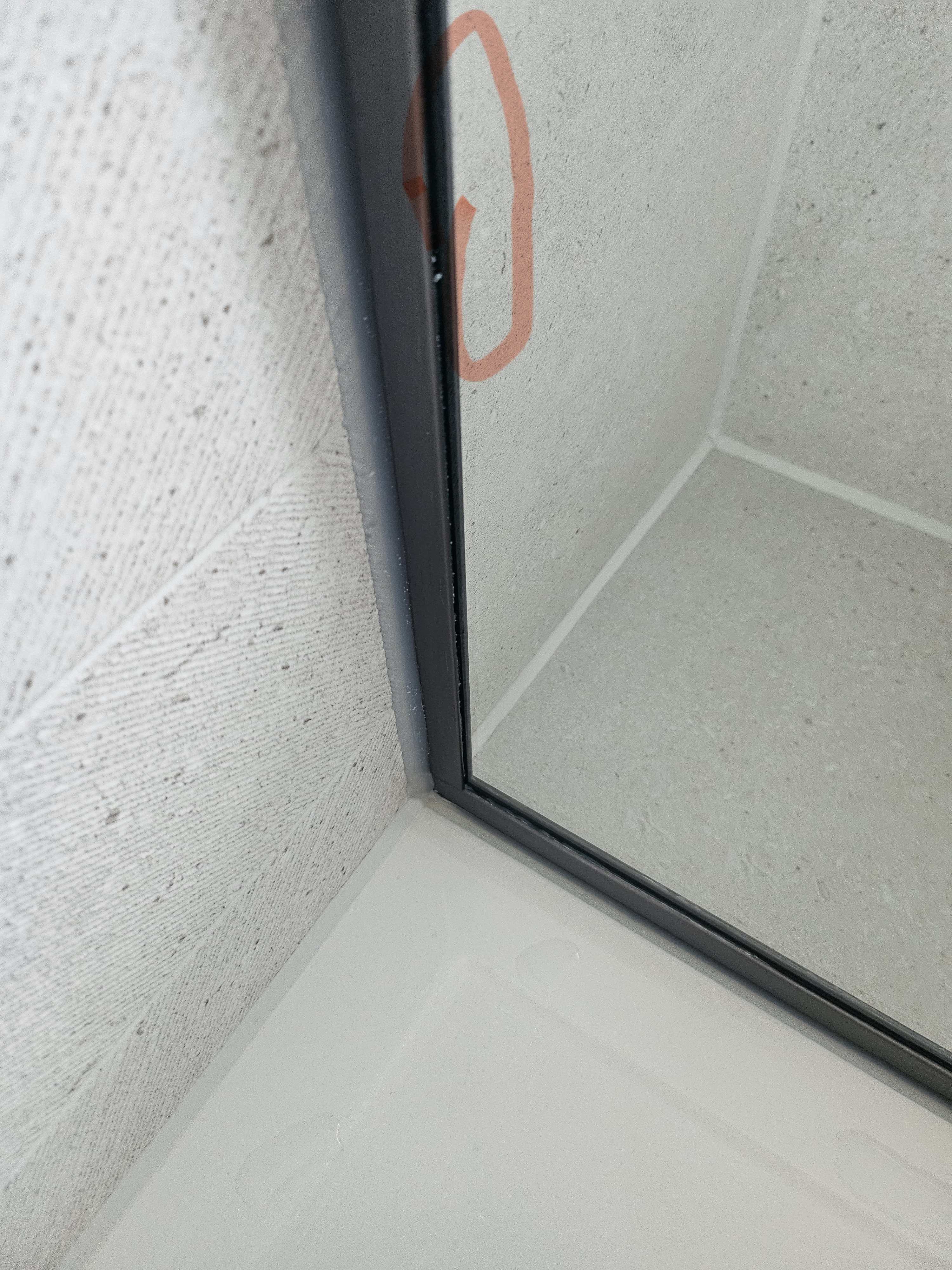

Where the red circle is where the leaks occurs, it seems water enters this area where the glass meets the channel frame.

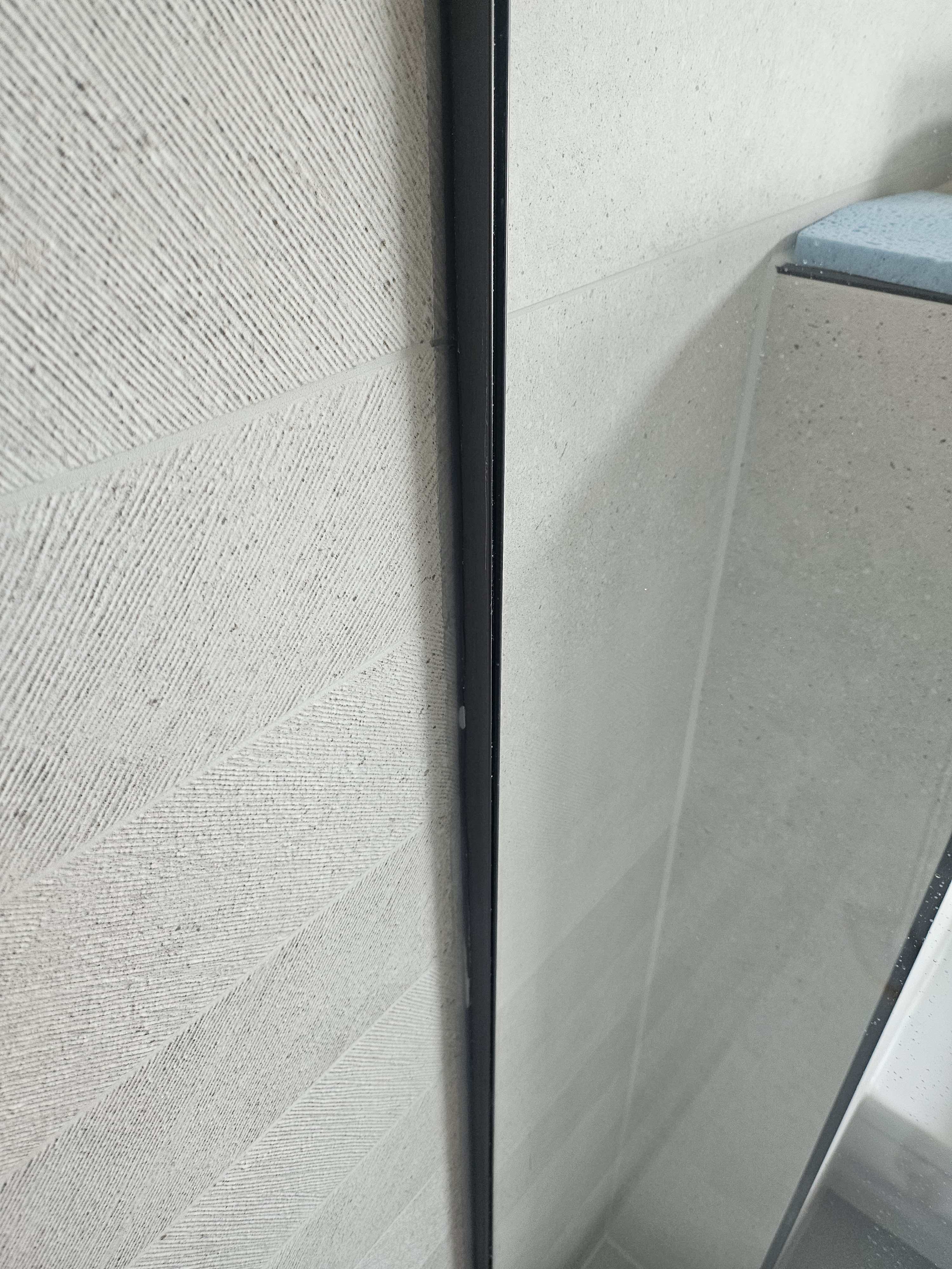

It's not happening where the channel frame meets the tile that's fine.
What's the fix here? I cant take the glass out. The installers fitted the channel frame using ct1 and screws. They also put silicone inside the channel frame and pushed the glass into it.
You normally don't seal the frame on the wet side, just the dry side. This is so any water that gets in to the channel will drain out on the wet side. Same for the bottom on the wet side, my instructions said to leave this clear so water can drain out. Yours appears all sealed up, so water that gets in will build up until it finds the easiest way out.

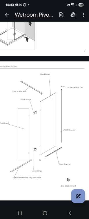

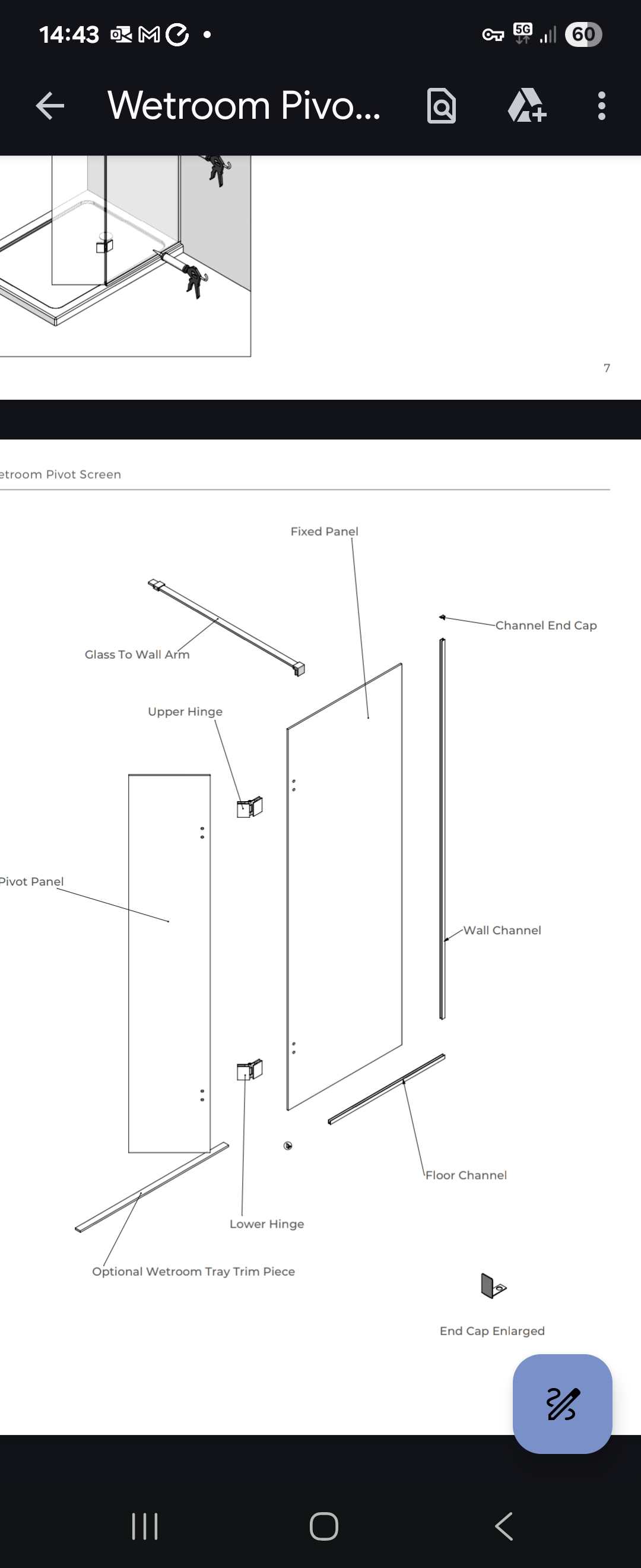

I'm assuming there is a rubber strip seal between the frame and glass? That is how it normally works. it should be well pressedd in, with no bumps or dips. There's no need for any silicone etc within the channel.
Edited by Conor
I don't think there is any rubber strip seal that was installed by the plumbers.  I dotn think one was supplied.
Well, there's your problem. There should have been. Glass needs to be removed, channel cleaned out and proper seals installed. Call the manufacturer for replacement seals and proper instructions.
The seals not only keep water out, they anchor the glass in place.
