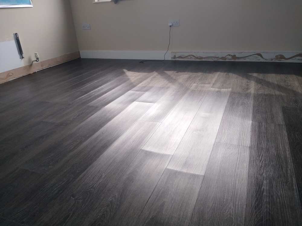

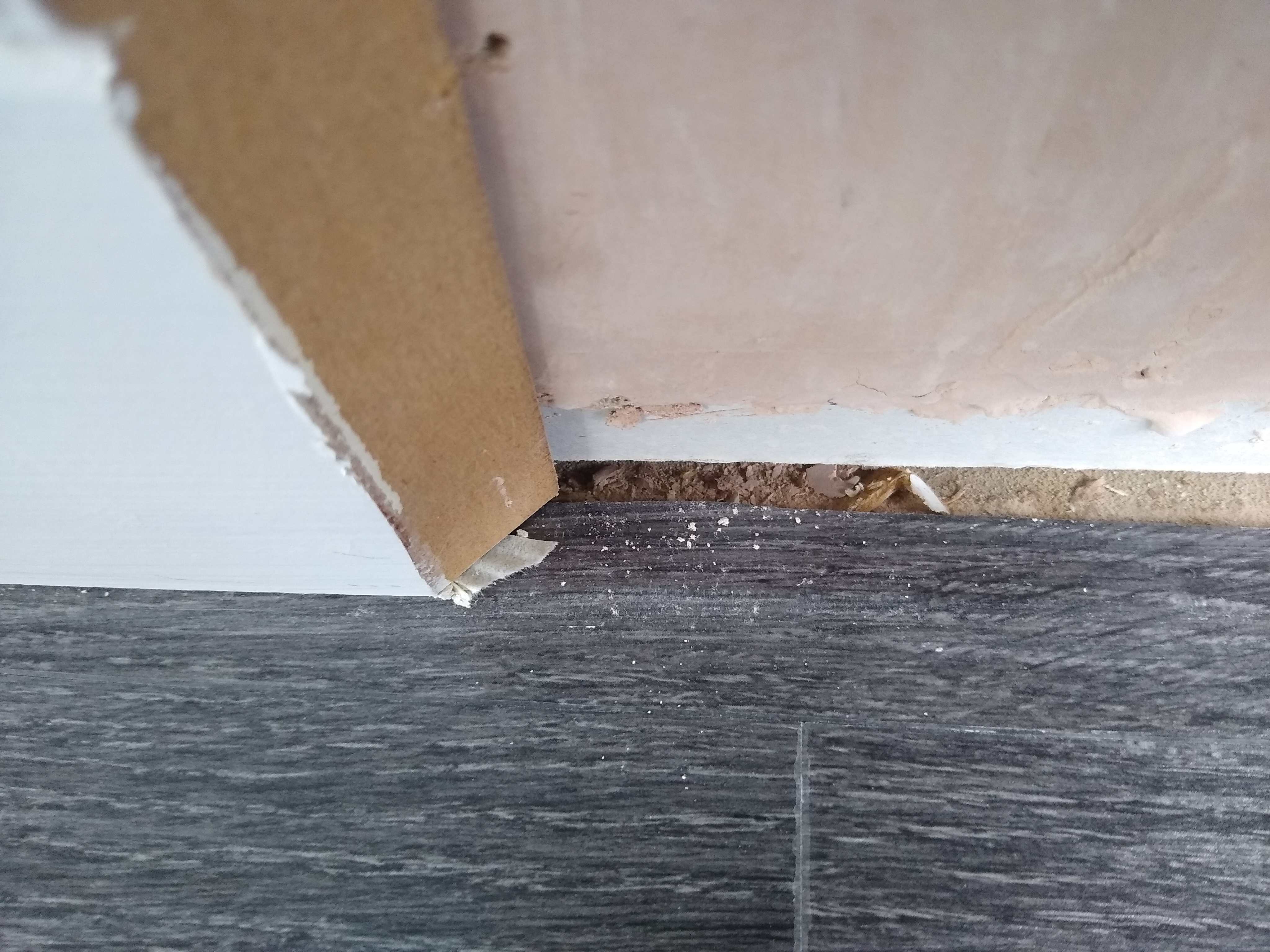

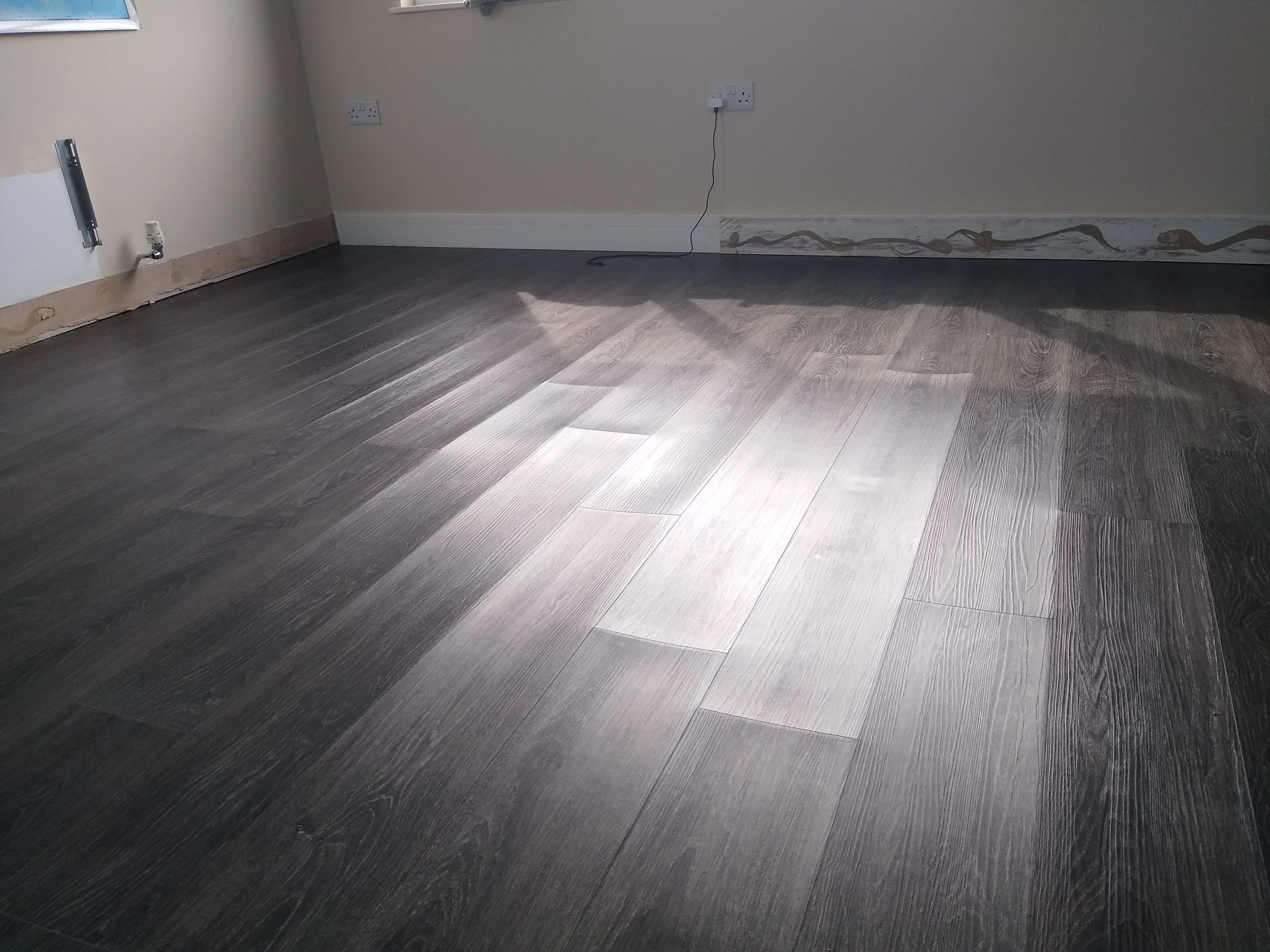

dscoll Posted June 7, 2025 Posted June 7, 2025 Hi all. I've got some Kardean LVP in my loft (6M x 4M), which is a very warm room. It's been down for 4 years and it's started to warp (about 2 - 3mm), width ways only, see attached picture. I assumed that the builder must have not left the required 5mm gap to the wall , so I removed the rad and a section of the skirting on 1 wall to have a look. Turns out the gap is there, so i'm puzzled? My thought are There is always a table tennis table in the middle of the room and it's very heavy, 100Kg, could this be preventing the lvp from expanding into the gap? Note, yesterday I took the table down but suprise suprise the floor didn't magically go flat. I tried pushing it flat with my feet but no good. If this is causing the problem how do I now flatten it out? Or could the skirting be too tight to the floor , anyone seen this before and do i need to take the rest of the skirting off to confirm this (please say no) or is there a simpler way of checking? Any other thought ideas? Thanks DS
YorkieSelfBuild Posted December 12, 2025 Posted December 12, 2025 Hi, did you ever find the cause as I'm about to install Karndean rigid LVT? It could be the high temperatures as the recommended temps during and after installation is 18-27C
Nickfromwales Posted December 12, 2025 Posted December 12, 2025 5 hours ago, YorkieSelfBuild said: Hi, did you ever find the cause as I'm about to install Karndean rigid LVT? It could be the high temperatures as the recommended temps during and after installation is 18-27C What areas are you using it in?
YorkieSelfBuild Posted December 15, 2025 Posted December 15, 2025 (edited) Upstairs, bedrooms and landing, there's no attic. I think I'll be ok but wondered if you ( @dscoll ) found the culprit Edited December 16, 2025 by Nickfromwales
