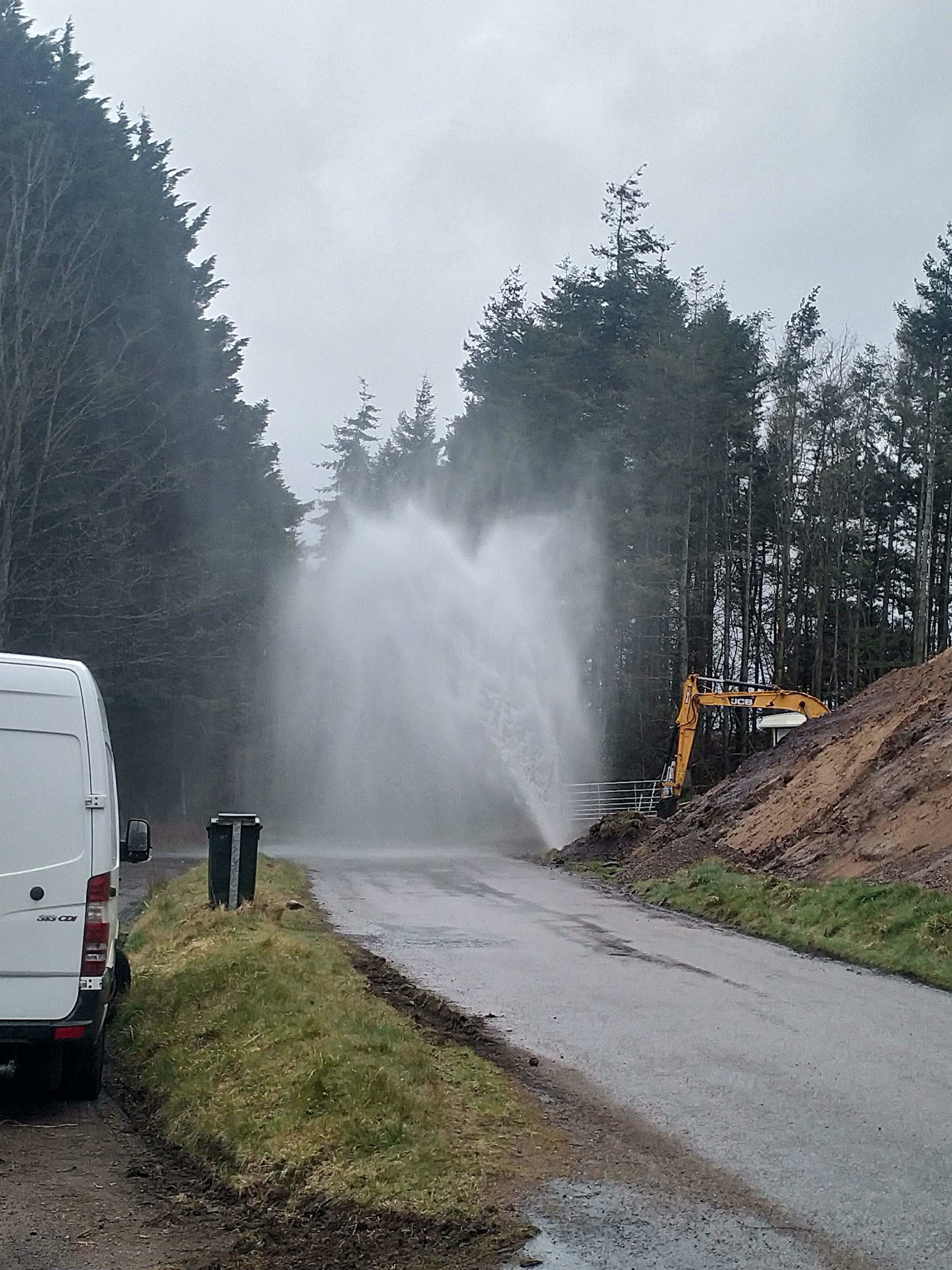

No idea of the answer but don't hit it - our grind contractor did, got a huge fine. Makes quite a mess
