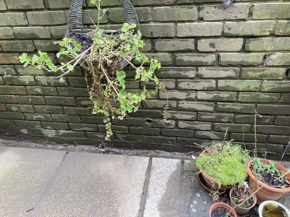

The retaining walls in our garden are about 50 years old. Showing signs of age where the grout is loose or missing. Moisture seeps out which then leads to frost damage and more loose grout.
We have a choice to repair the poor sections or replace all the grout for the sake of not having to do it again in 10 years.
Could anyone give me an idea of cost / sq meter for fully regrouting as that's the one my OH is tending towards. I'd like to have a ballpark idea before we commit (if we can find someone)

At a guess, £100/m2.  At least it is easy access.  I know a bricklayer who uses a piping bag and can get a fair bit done.  If the wall always looks that wet, you have some drainage issues.

Wall has been power washed and the old grout taken out. Builder suggested that we do the whole wall rather than patches as it would likely need to be done again if patched. Bit the bullet and agreed.

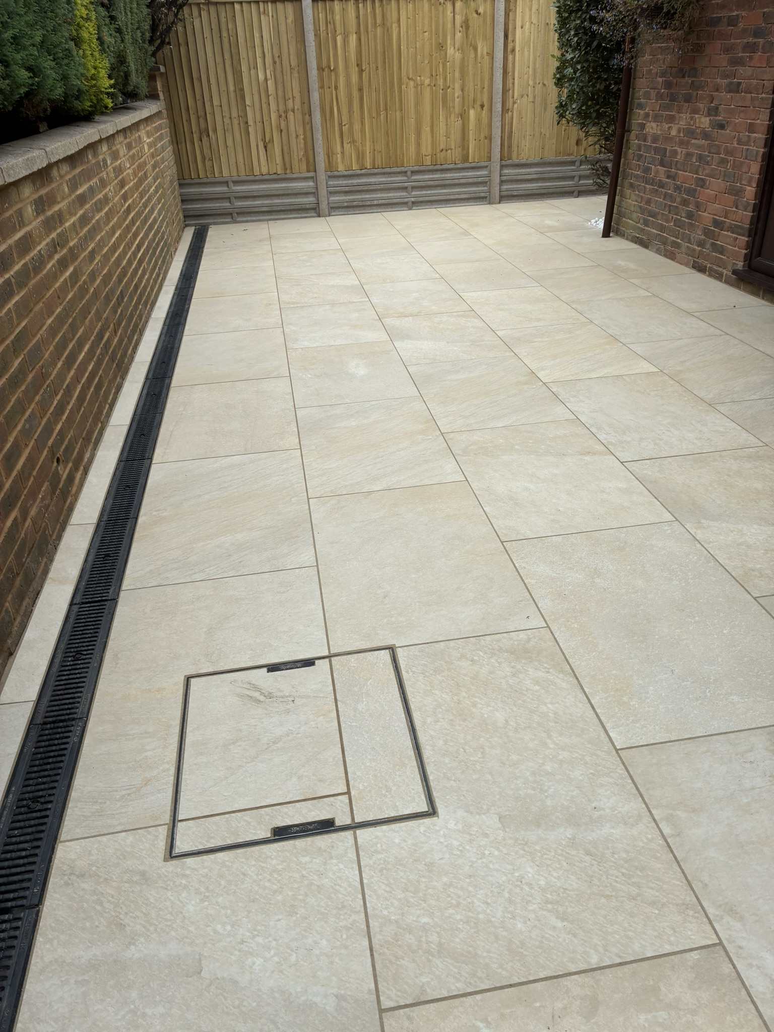

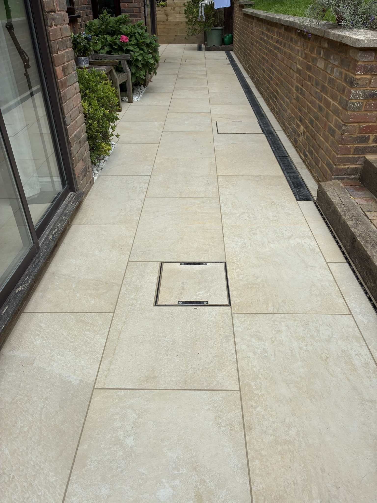

Job now complete. Retaining wall repointed, fence replaced and patio slabs replaced with porcelain ones. Lots of additional drainage installed but will have to wait until Spring to see if it can cope with the more frequent rain we seem to be getting.
