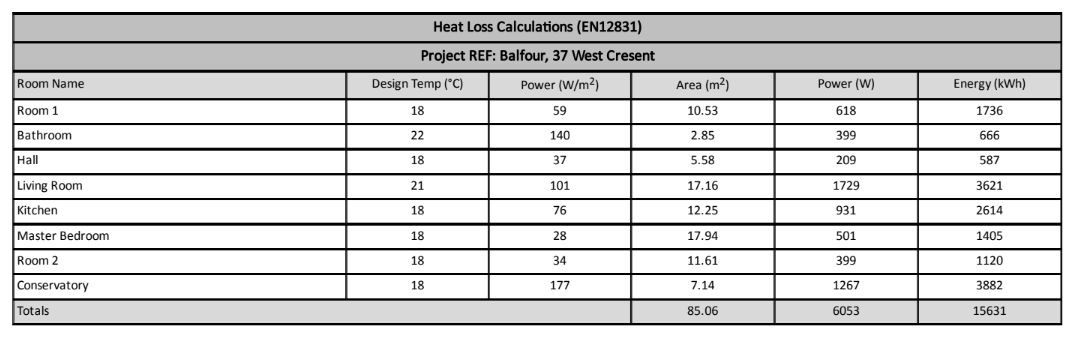

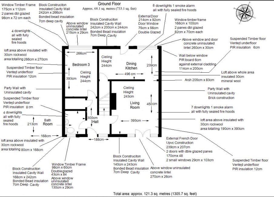

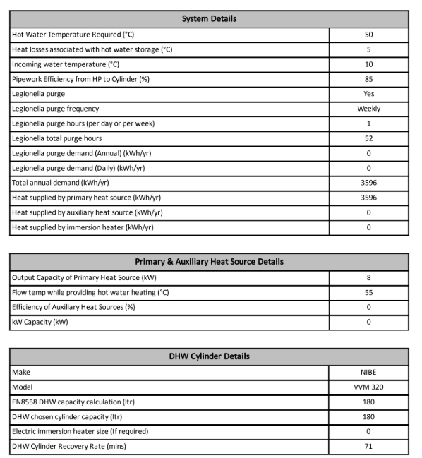

Hi, I had an installer fit an ASHP to my existing heating system. They advised i should upgrade my radiators at the time as it was about 30 years old and micro bore etc. I was a bit strapped for cash at the time of installation so I had no choice but to refuse and come back at a later date to fit new radiator system. As a result I have left my self unsure as to how to scale the radiators for the rooms and what BTU they need to be. I was hoping to run the ASHP as low as possible around 35-40 degrees to reduce long term strain on the system, so have no issue over sizing the radiators. How would I calculate the sizes? I was left with these documents and I am unsure if they are what I need to calculate this out. Also attached is a detailed floor plan of the area needing heated in case that helps. Thanks in advance for any replies, help and support offered.

You use the power in watts to size each room radiator, so room 1 needs 618W output from radiator.
Now you need to convert the radiator size from manufacturer data to your chosen flow temp. There is a calculation on here somewhere so do Google search on buildhub.

On 02/06/2025 at 12:17, Joshua Graham said:
I am very confused, some sources say 2.5 times the BTU (I would imagine watts would work also) for ASHP but this just sounds a bit loosey-goosey advice and could lead to cold rooms. Is this advice sound? It doesn't seem to take into account that I would like to run the system at lower temperatures.
If you have a heat loss (w) required by the room then it really is simple
Lets take the example of the Room 1 - from the table you supplied heat requirement/loss is 612w
So you need a radiator that supplies 612 w at your target flow temp
Radiator outputs are normally stated at Delta 50 (Flow temp 75, Return Temp 65 so mean rad temp 70 Deg minus room temp 20 gives difference of 50 Deg.
Rad outputs by size and type can be found here
https://www.stelrad.ie/wp-content/uploads/2015/08/Compact-K3-Technical-Specification-Brochure.pdf
Taking a T22 Rad (double panel / double convector) which is 600 mm tall and 1400 mm wide it has an output of 2.425 kW (2425 w) at Delta 50

At Flow temp 45, Return Temp 35 so mean rad temp 40 minus room temp of 20 gives a difference of 20 Deg (or Delta 20) so the correction factor for that is multiply the original rad output by 0.304
2355 multiplied by 0.304 is 737 w so a little over what the heat loss required is so you could reduce the size a little but I'd go a little bigger everywhere and then tweak the flow temp back a smidge.
