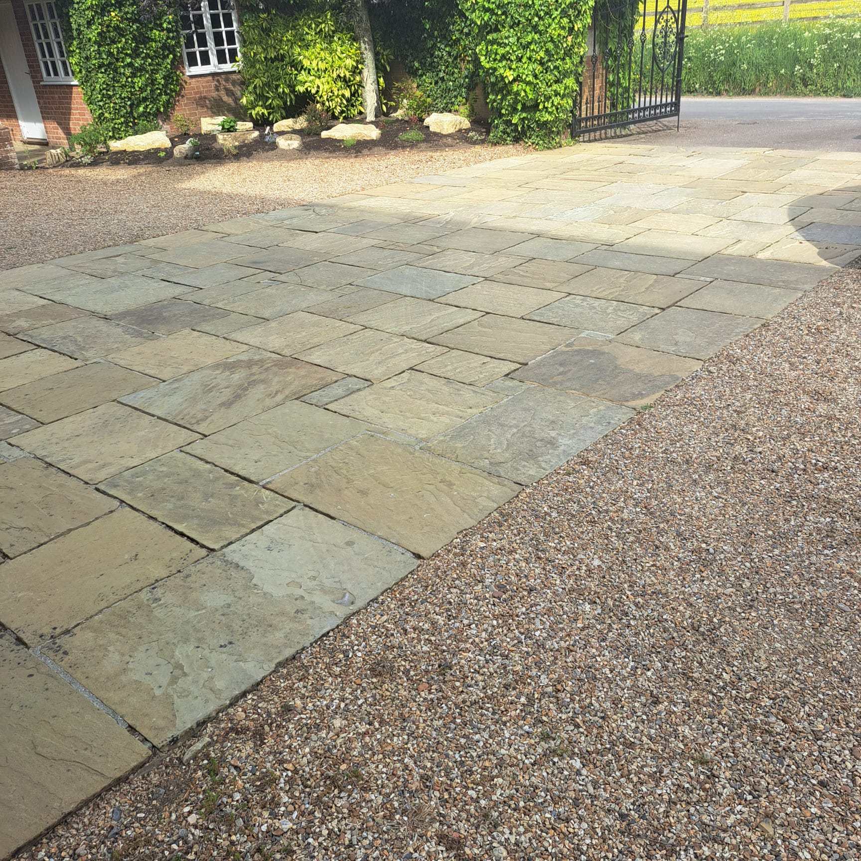

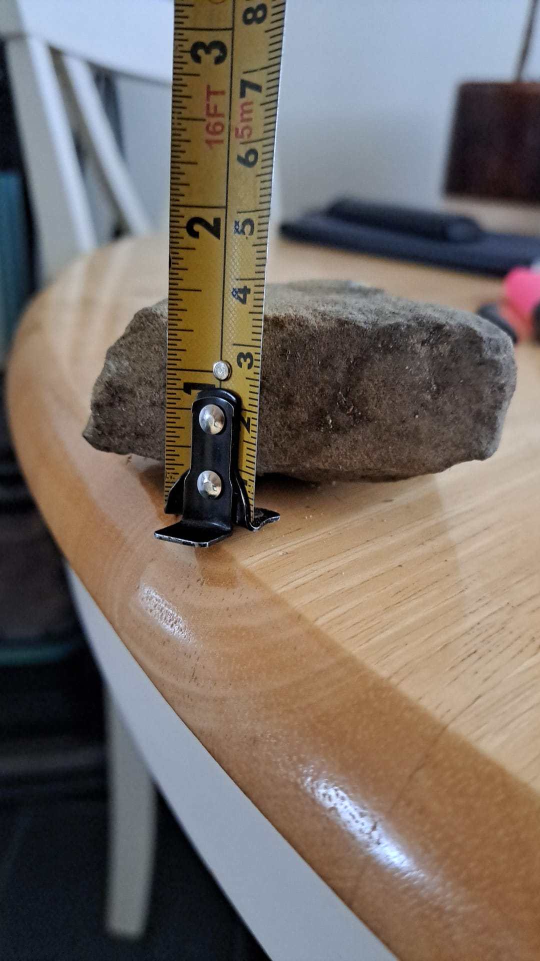

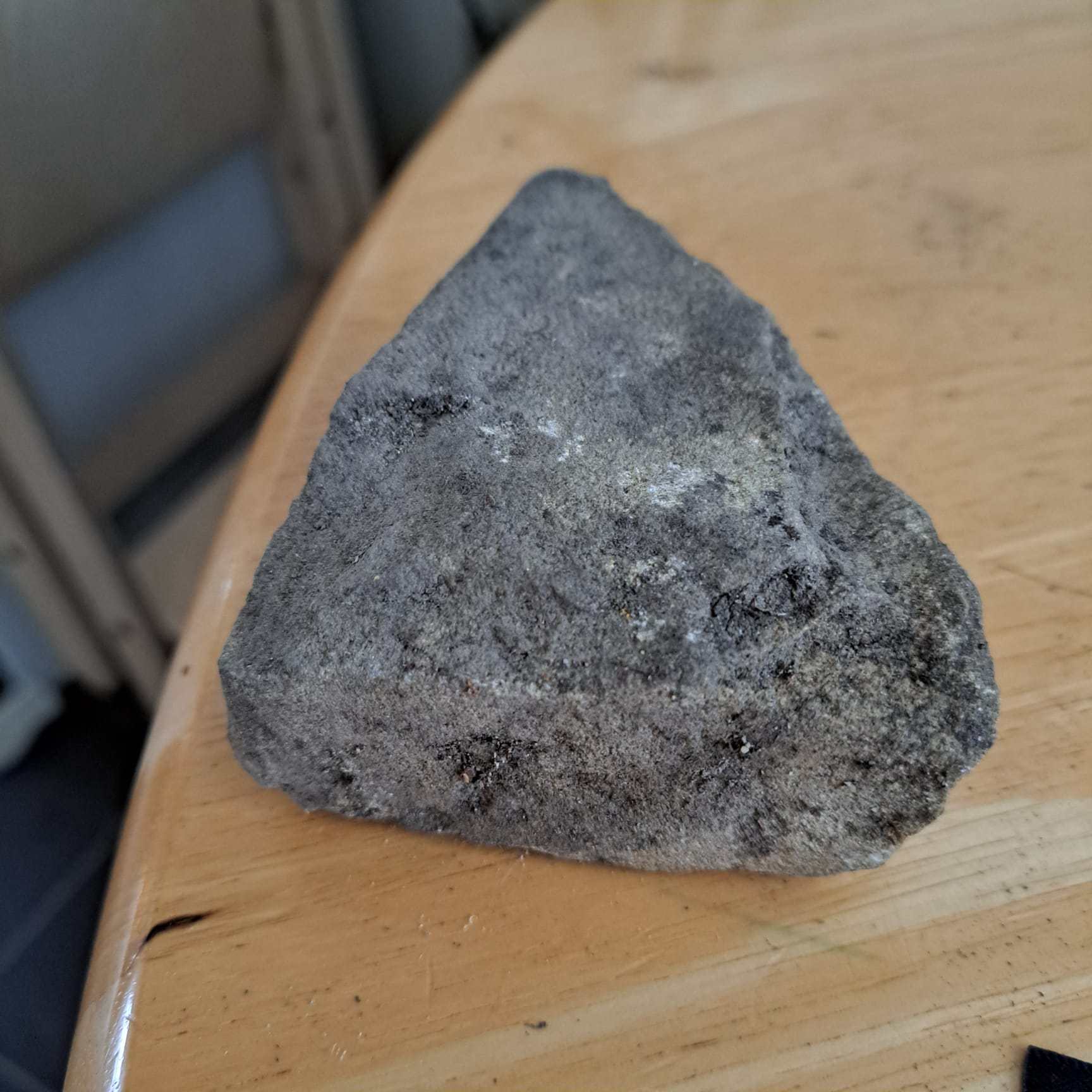

rah212 Posted Tuesday at 11:07 Posted Tuesday at 11:07 (edited) Good afternoon Everyone, I hope you may be able to help please I have to replace a few of these slabs and im not too sure what they are exactly.. Maybe yorkstone slabs? This job is in salisbury Wiltshire whether that helps. Ive attached a couple pictures and one picture is of a small piece of the slabs. Really appreciate any advice, Many thanks in advance Edited Tuesday at 11:09 by rah212
Bonner Posted Tuesday at 13:24 Posted Tuesday at 13:24 Looks like Indian sandstone which is quite thin 25-35mm and available in various colours. York stone slabs are normally thicker 45-60mm.
