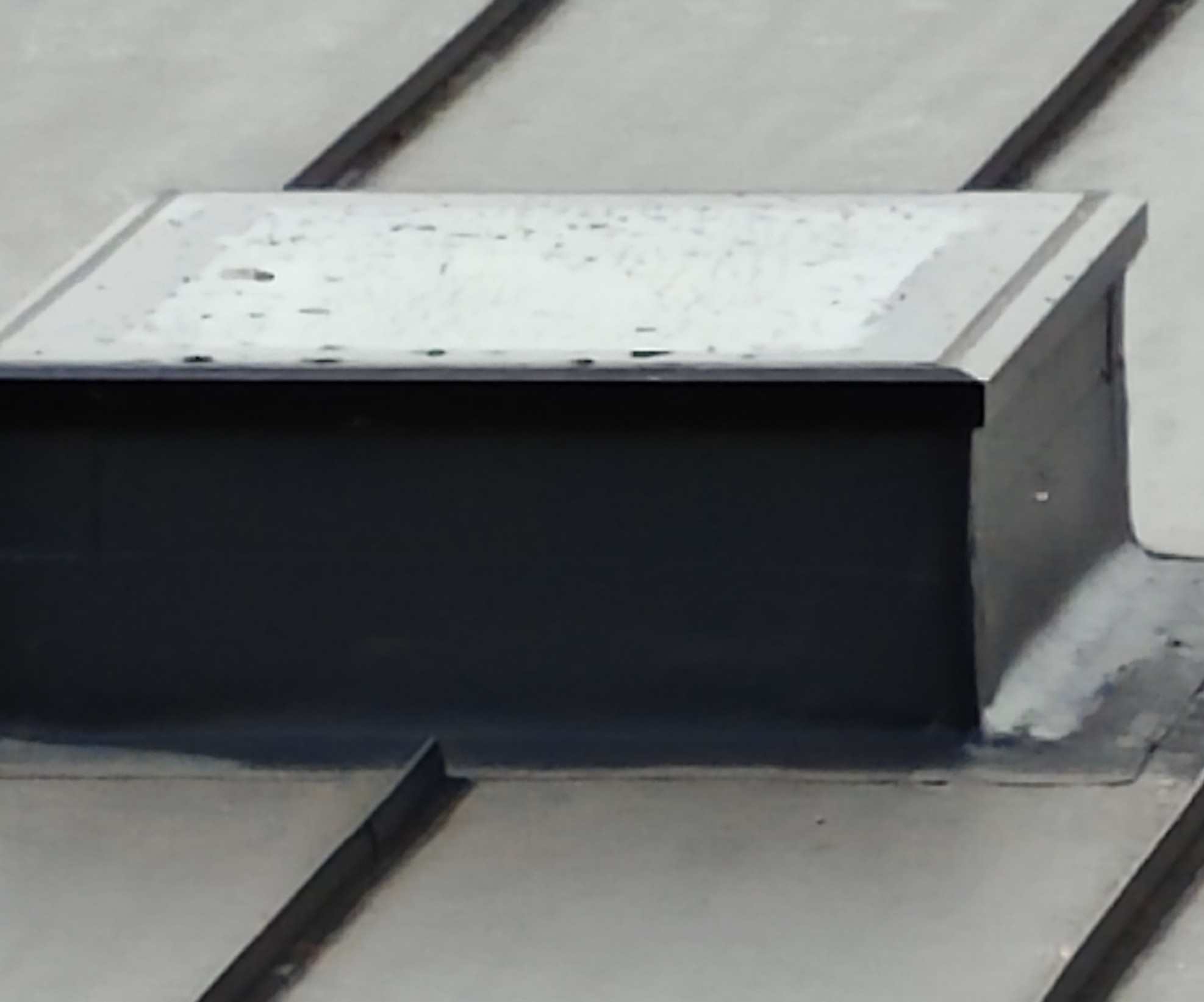

We have fixed Roof Maker skylights.
These are the passivhaus spec ones, but just about frameless. IMG202505041147432.thumb.jpg.582bb7d979934a2d60c2e2ca3ca8f9f0.jpg
