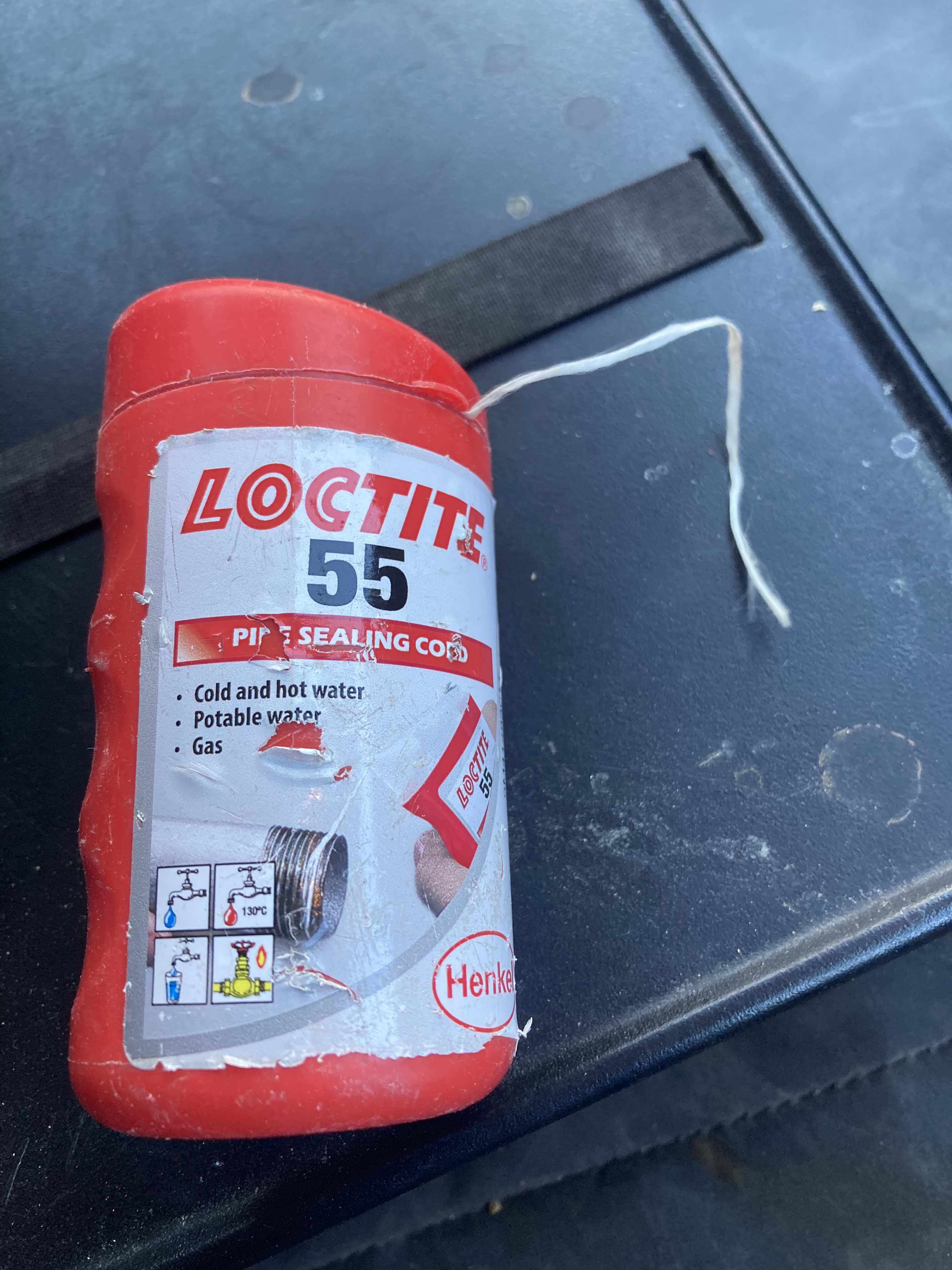

I’ve used a paste on ours without any issues and locktite on the rad thread
