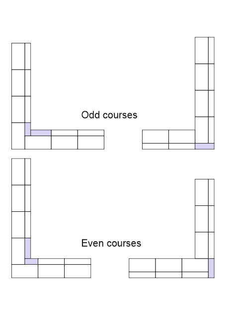

OldieNewbie Posted April 16, 2025 Posted April 16, 2025 How would one bond out 325mm thick block work? I assume 2 blocks are is laid on their width and another on its edge upright. If you had a corner how would you set it up so you would still have stretcher bond?
Mr Punter Posted April 16, 2025 Posted April 16, 2025 Like this? Cut block are coloured. Flat blocks laid mum and dad. A bricklayer might have a better idea though!
OldieNewbie Posted April 16, 2025 Author Posted April 16, 2025 2 hours ago, Mr Punter said: Like this? Cut block are coloured. Flat blocks laid mum and dad. A bricklayer might have a better idea though! Thanks for that. Where did you get that diagram? What I find confusing is that on odd course’s and even courses the block on edge is on the same side. Would that not alternate every course?
Mr Punter Posted April 17, 2025 Posted April 17, 2025 20 hours ago, OldieNewbie said: Thanks for that. Where did you get that diagram? What I find confusing is that on odd course’s and even courses the block on edge is on the same side. Would that not alternate every course? I drew it. I am shite at bricklaying though. 1

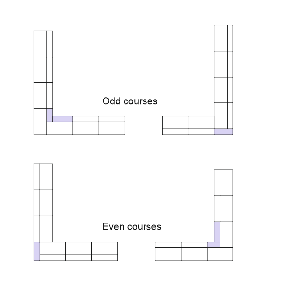

OldieNewbie Posted April 17, 2025 Author Posted April 17, 2025 3 hours ago, Mr Punter said: I drew it. I am shite at bricklaying though. Drew it? How? It is excellent 👌🏼 Can you do it in 450 mm work as well please? With corners.
