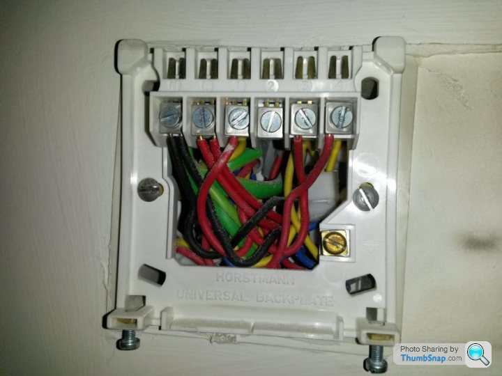

Posted
  On 20/03/2025 at 16:08, Bramco said:
I'd be surprised if the TADO units fitted onto the Honeywell backplates but I guess someone out there will know.
Expand
If manufacturers don't use universal back plates I wouldn't use them out of principle you shouldn't need to be an electrician to change a controller.
My old Danfoss programmer from the mid 90's was on a universal back plate and I remember well the headache I can converting to that from an old clockwork timer (if anyone remembers them)
But when it died and I changed to a Wiser system all I had to do was
1. power down.
2. Loosen two screws under the Danfoss unit to remove it from the backplate
3. Replace with the Wiser Hub
4. Do up two screws
5. Power Up
6. Connect the hub to the Wifi
7. Pair the "Smart" TRV's
8. Pair the "Roomstat"
9. Set up the schedule for one room and copy to all the other rooms
Absolute doddle to do.

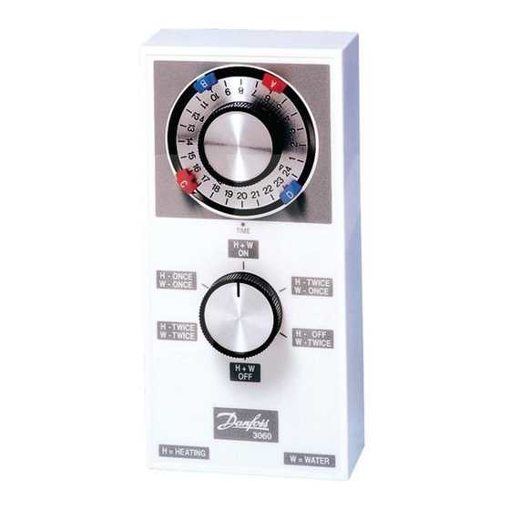

Posted
Found the pictures I wanted
When we bought the house this was the HW and CH timer
It was fine for years until someone used the toaster that lived under it without bothering to move it forward - the resulted melted mess necessitated replacement

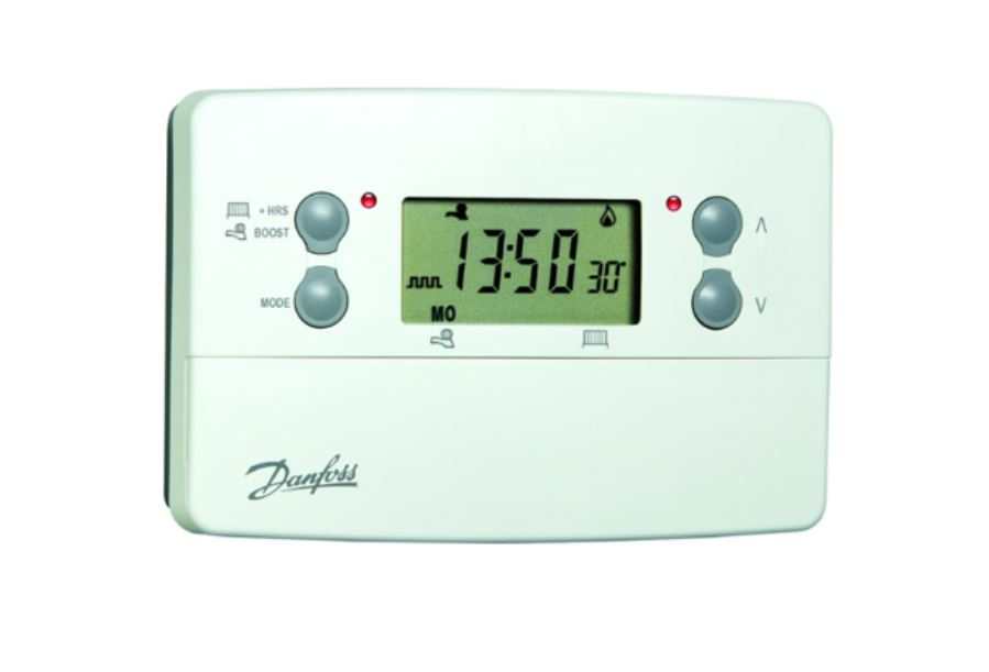

I fitted this Danfoss Unit
It came with an Industry std backplate (often called universal backplate cos that's molded into it too)
Eventually it died - kept losing display and sometimes the programme
So I purchased a Wiser Hub, 13 "smart" TRVs and a "smart" Roomstat there is nothing "smart" about any of it but the fact I could fit the Wiser Hub on the existing backplate with no changes of wiring was a big plus for me
