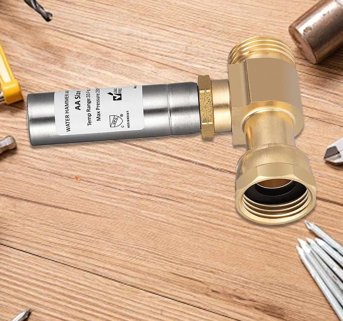

Stevenwithav Posted March 17 Posted March 17 Morning all, I have an issue with my unvented system boiler I’m hoping one of you could give me a heads up on what it could be, When the washing machine is in on I can hear the hot water tank make a thud noise every so often, it also sometimes happens when I turn on the taps, definitely coming from the hot water tank
DamonHD Posted March 17 Posted March 17 Water hammer, when the washing machine starts and/or stops drawing water?
Stevenwithav Posted March 17 Author Posted March 17 Water hammer? How can I fix it? Anything I can do or is it to complicated? Thanks a video attached to hear the thud IMG_7294.mov
stu w Posted March 17 Posted March 17 (edited) On 17/03/2025 at 12:47, Stevenwithav said: Water hammer? How can I fix it? Anything I can do or is it to complicated? Thanks a video attached to hear the thud IMG_7294.movFetching info... Expand A PRV may help depending on your current water pressure. A shock arrestor will help also on the fees whats causing the problem. Listening to you recording, It sounds like there is a pipe what hasn't been clipped back properly somewhere Edited March 17 by stu w
