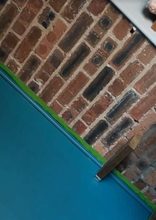

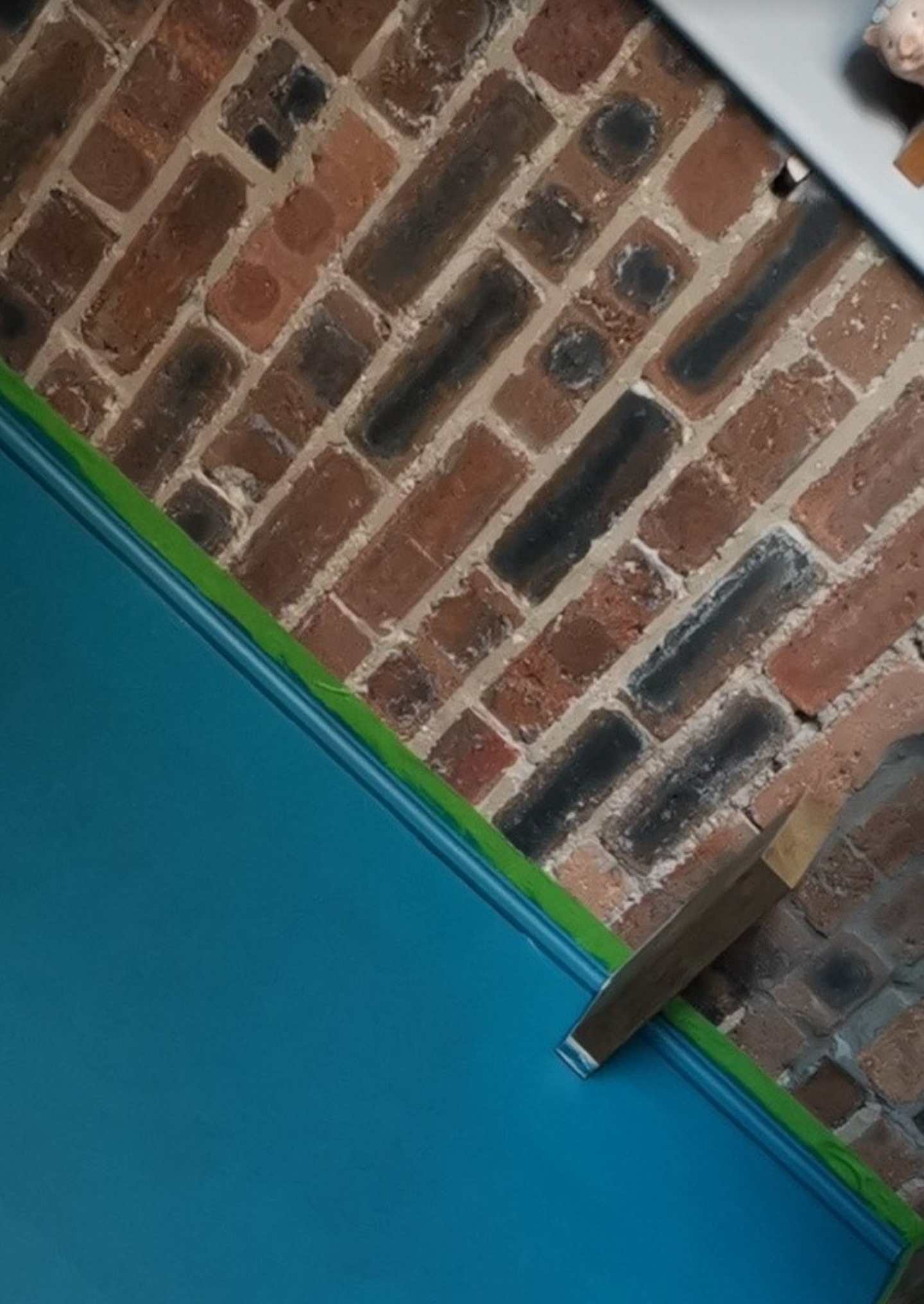

I have exactly this in the original 1930s part of the house. It's what you think it is, a long wooden dowel that is nailed to wedges in the corners of brick work. I have exposed a wall and recreated the detail with the original method, see attached in an awful photo you can see the wedge top right. Brought back memories of painting that wall that blue/green and then 2 days later painting it back over again with something less sh1te.
