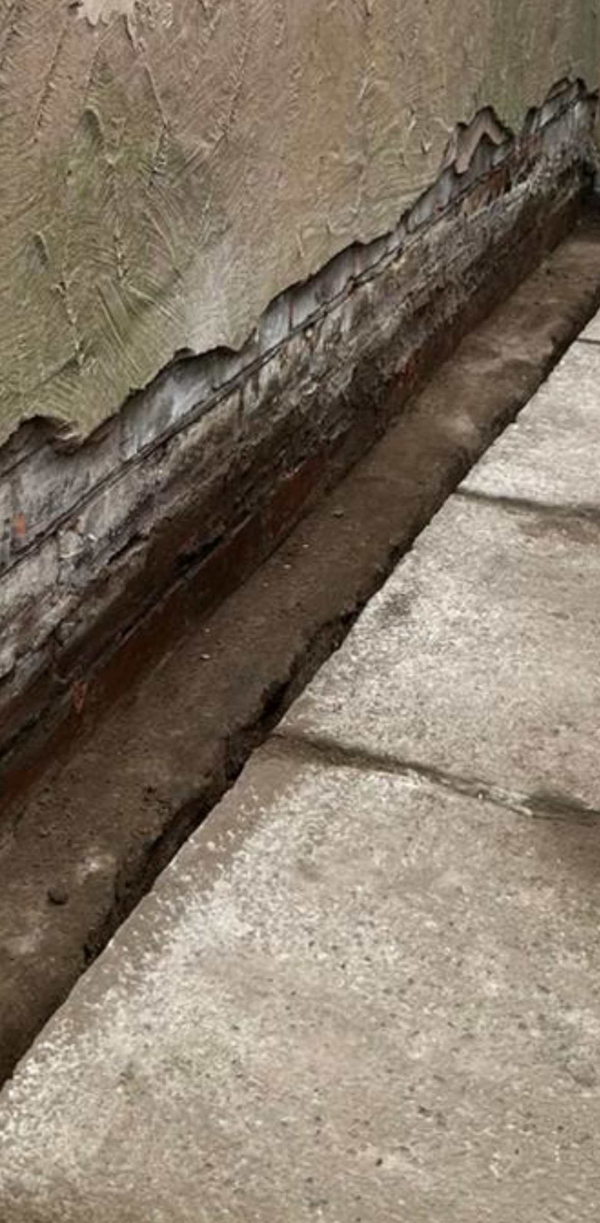

I dug a trench around the back of my house as I was recommended it by a damp specialise as the pavement water was splashing above the DPC.
I have done this now and the foundations are exposed causing leaks through the ground concrete floor.
I was planning to fill with gravel (as advised) but my worry is that the water will then still sit on top of the foundation and wall.

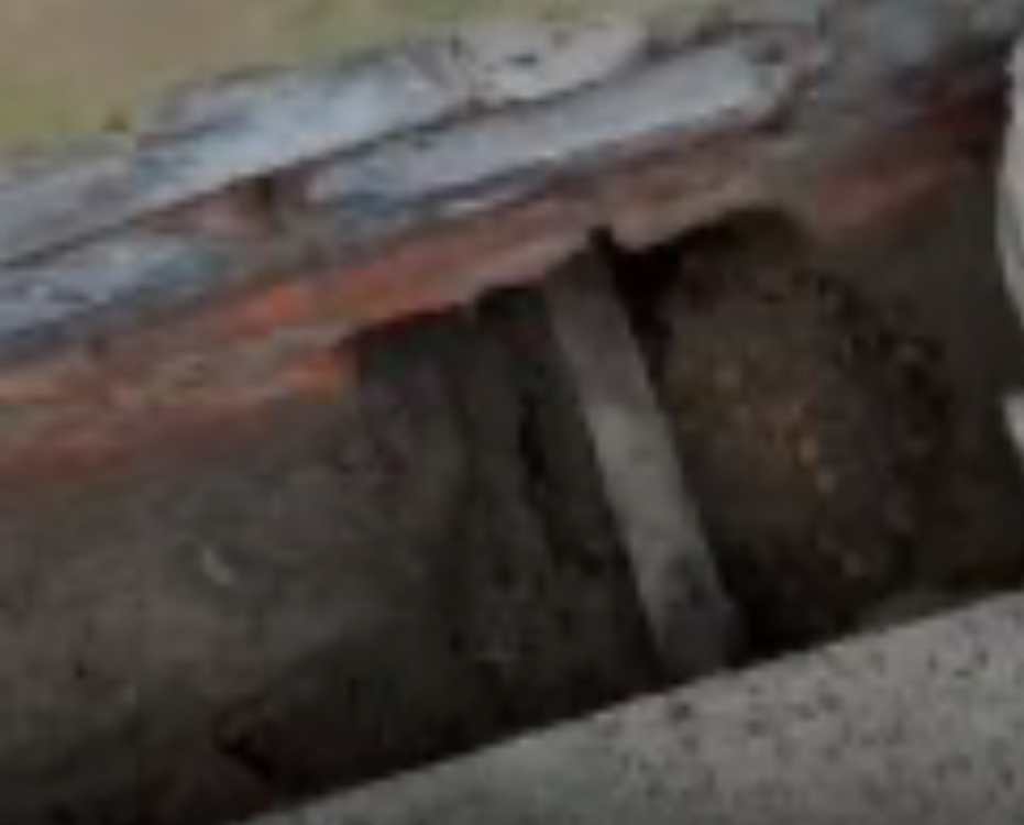

i have considered a perforated pipe and connecting it to the drain but the drain is cast iron and there is an old dead gas pipe in the way, which I did not expect to see so high up.
Can anyone guide me to a solution here? Appreciate any help in my dilemma
Thank you IMG_7480.thumb.jpeg.2a1f695db78f825a582f90512110d105.jpegIMG_7481.jpeg.1964d5afc887a419422ab5baacddf311.jpeg
Posted
I don’t see how digging out like you have would cause leaks in your concrete floor? If anything any water would come out and pool in the bottom of the trench.
I did the same dig out when installing external wall insulation and didn’t have any issues.
what makes you think this has caused it?
