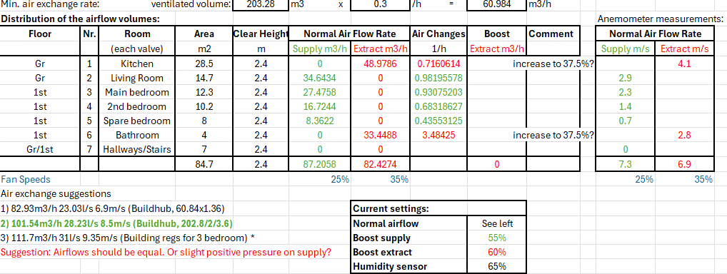

 So with 4 supply vents and only 2 extract vents, I'm confused as to how to equalize the flows. Here's a chart I've adapted from another post:
1) I'm not exactly sure what my whole house ventilation rate should be for the normal supply speed. As you can see from my rough notes at the bottom, I've noted suggestions from 3 different sources and this is conflicting. Should I just aim for the middle? The building regs guidance seem way too high. Currently, the system is near silent and condensation has disappeared from bedroom windows and the front room wall. Maybe placebo but the old house smell in the entrance hall has also disappeared.
2) From the unit's defaults, I've increased extract to 35% and supply decreased to 25% . I've read you don't really want to imbalance the supply and extract fans too much - but it looks like with only 2 extracts I'd need to increase the speed even more until they equalize. Is this correct? Or best to have the fan speeds closer and just restrict the flows from the supply vents themselves?

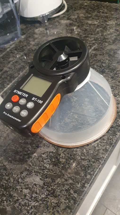

Here's my adapted anemometer which works really well with the right seals (yes, that's the kitchen funnel) The conversions from m/s are specific to the meter using https://www.engineering.com/resources/air-flow-calculator/. 32.5mm radius if anyone's using that model.

Your main bedroom I would do 40m³/h other bedrooms 20m³/h. That gives 80m³/h. I will get to lounge in a latter
Extract, kitchen 48m³/h and bathroom 32m³/h. So fully balanced and not over ventillated.
Lounge depends on your layout. Ideally you would've as through flow. That is excess air from upstairs (48m³/h) would flow through the lounge to the kitchen. For this to work you need a path from the stairway through lounge to kitchen. If that doesn't work because of layout, you need a supply in lounge and extra extract in bathroom and kitchen to balance flows.
Boost set 20% above normal
Have you undercut doors?
Hi John. The layout doesn't work as the doors from living room to kitchen are very close, so it wouldn't get much through flow. The lounge (living room) already has a supply vent so I'll either increase extract flows for kitchen and bathroom or consider adding an extra extract vent perhaps in first floor hallway to help with balancing and minimise fan speed differences.
Yes, all doors undercut to 10mm.

Hi Jigs, Does BT100 gives accurate readings ? what funnel you have used to make cone please?

Hi Jigs,
Did BT100 anemometer give accurate readings and what did you use to make the funnel?
TIA

To calculate the flow from speed, multiply the m/s by the area of the anemometer vane opening and then 3600 to m3/hr
To calculate the area of the anemometer vane opening use the formula A = π r2, r being 1/2 of the diameter.
There are calculators online where you can enter the radius or diameter and it does the calculation for you.
Alternatively, spend a few minutes working out a small range of m3/hr values using the vane opening measurement so you have a ready reckoner to check.
As well as a cone, you ideally need a flow straightening section, although this is less important with a vane-type anemometer.
With a vane type unit, you ideally need to ensure that most of  the airflow goes through the vanes, as long as that doesn't cause too much of an obstruction.  For domestic scale measurement a 100mm diameter measurement section is usually OK -  it's a reasonable compromise between getting the flow velocity up to a measurable level whilst not impeding the flow enough to significantly change it.
Here's a photo of the unit I made up with a 100mm length of duct:
This shows the Testo being used, and the reading is in m/s.  To convert this to l/s, then take the internal cross sectional area of the measurement point (in this case it happens to be 0.007354m², allowing for the bit blocked by the sensor probe), and use this formula:
Flow rate (l/s) = flow velocity (m/s) x 0.007354m² x 1000
