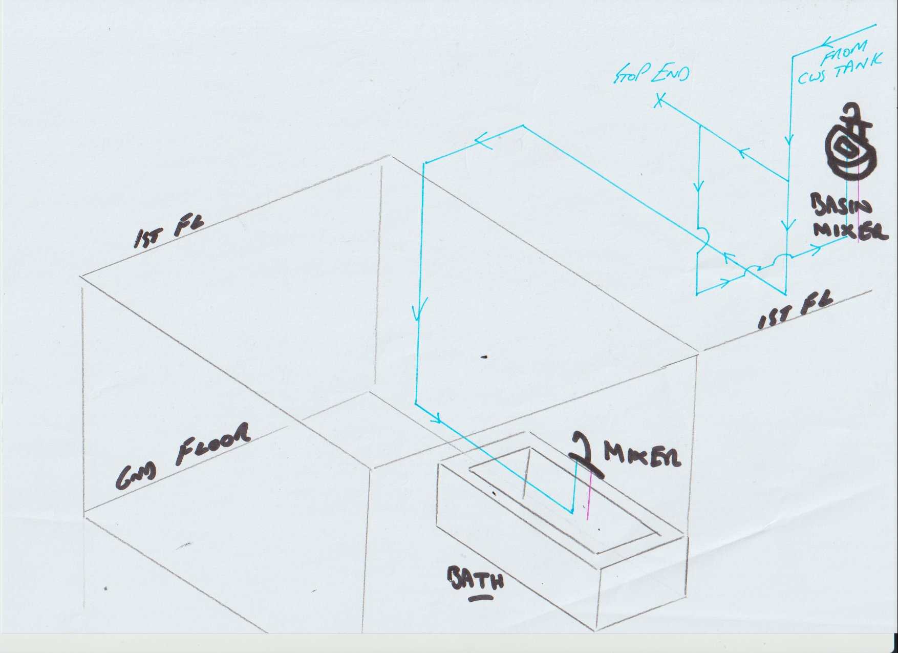

I've a cold water storage tank one end of the house that feeds a downstairs bathroom bath cold and upstairs ensuite basin cold.
It runs in 22mm from the cws tank then drops in 15mm to a tee. It runs in 15mm to the basin cold via a ball valve, it runs in 15mm to the bath via a gate valve.
Periodically the upstairs basin cold slows to a trickle then stops altogether.
To get the basin cold going I have to run the bath cold then shut it off at the gate valve after the tee then open the basin cold.

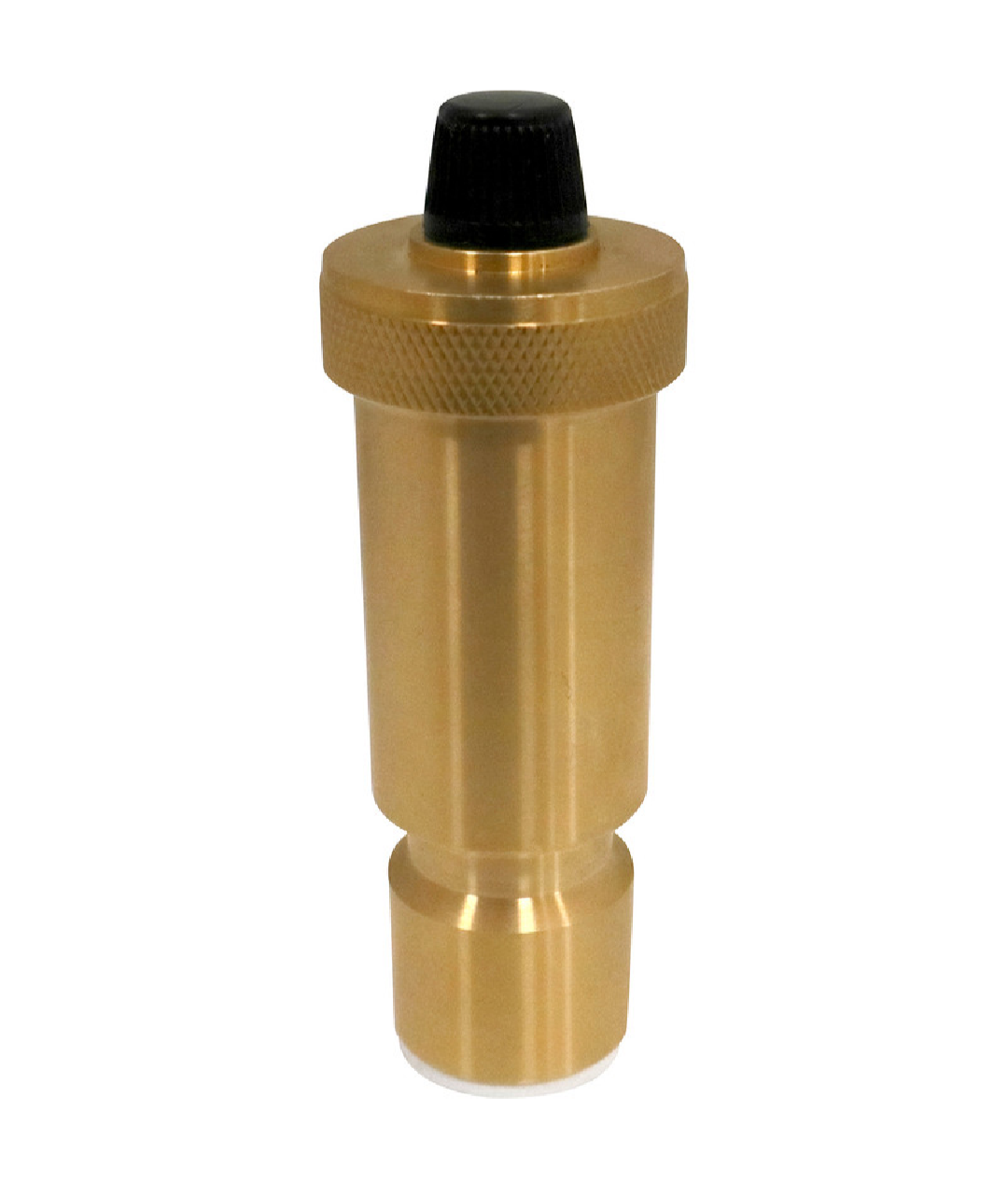

There's a stop end mark X just floating in mid air in the loft. If I put an air release valve there would that alleviate the problem?

Posted
Fixed it by fitting a non return valve where the red dot is. I need at some point to ditch the dead end mind.
