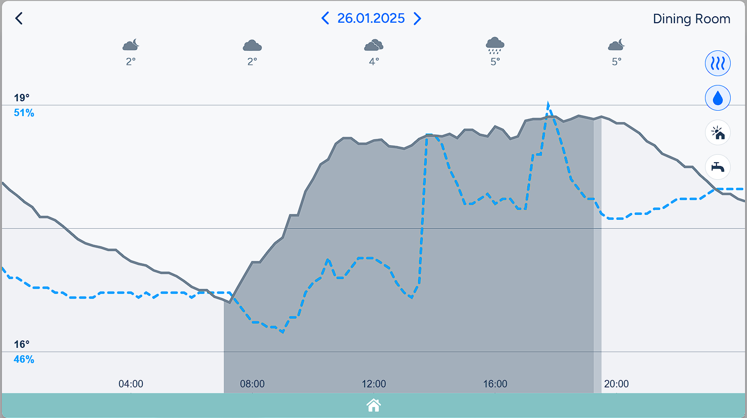

I have one area which is quite large in total, covered by a fairly big double vertical radiator, i was hoping once i'd finished and everything was fully insulated and sealed up, it would be up the job of heating the whole space, but I think the kitchen lets it down (furthest away from the rad), which is dot and dab (which i've tried to foam behind, but still get air leakage, probably due to thermalite blocks shrinking), and poorly fitting spot lights (which is on my to-do list), with 4 double glazed circa 2011 velux windows.

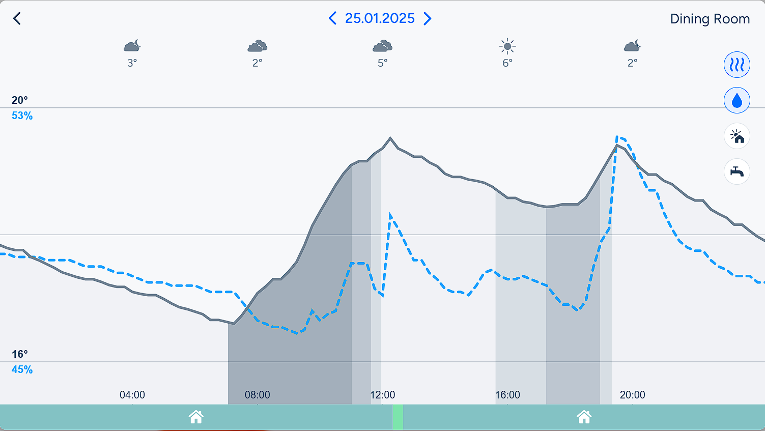

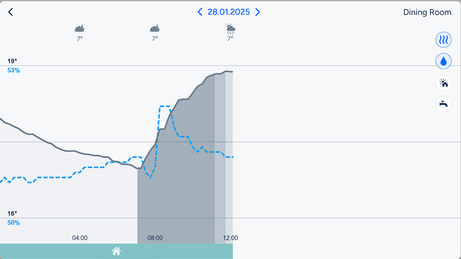

Heating graph shows a fairly normal, dark winters day:
When its sunny the thermal gain is good enough to help heat the room quickly:

What is the target room temperature? How many thermostats are in the house?
Run less setback overnight and during the day, then the radiator and boiler has less work to do next morning. Try running the same temperature 24/7 does that fix the issue? You may find the boiler in general has less work to do so operation is at a lower max temperature and uses less gas.

Target temp is 18.7C which I find more than warm enough, today is another miserable day but milder, and already above this target.
Overnight i've had it set to Off for some years now, which works in most cases, its just the cold cold days where it struggles a bit. This year, from 1st to 28th (so far), this room has consumed 347.51 kWh in gas according to the Tado calculation. I'll have a mess with overnight temps rather than it being off completely, and see how it compares.

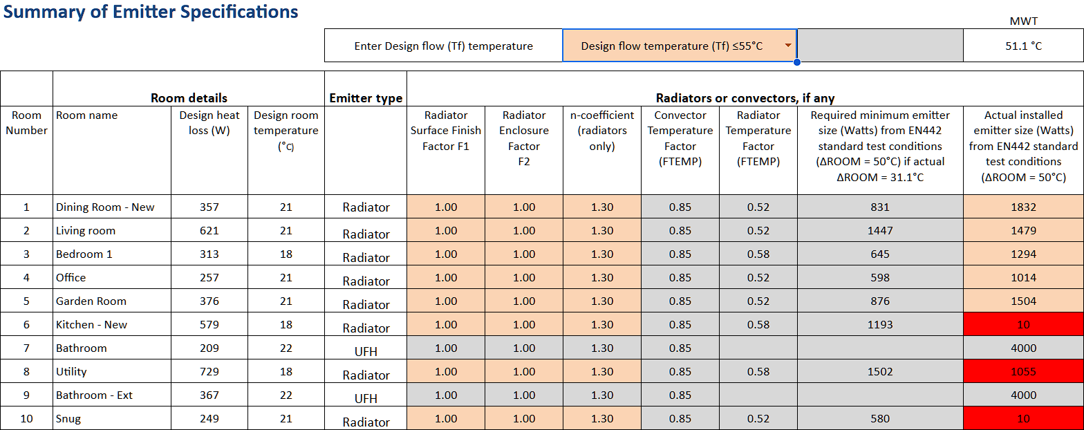

I hadn't heard they were poor, they were amongst the highest in heat output when i was looking at new rads for a given size. Wouldn't be able to swap for anything else really as don't want to mess with flooring and break airtightness, so restricted with width. There is the possibility of getting a triple version of the vertical, currently have double.

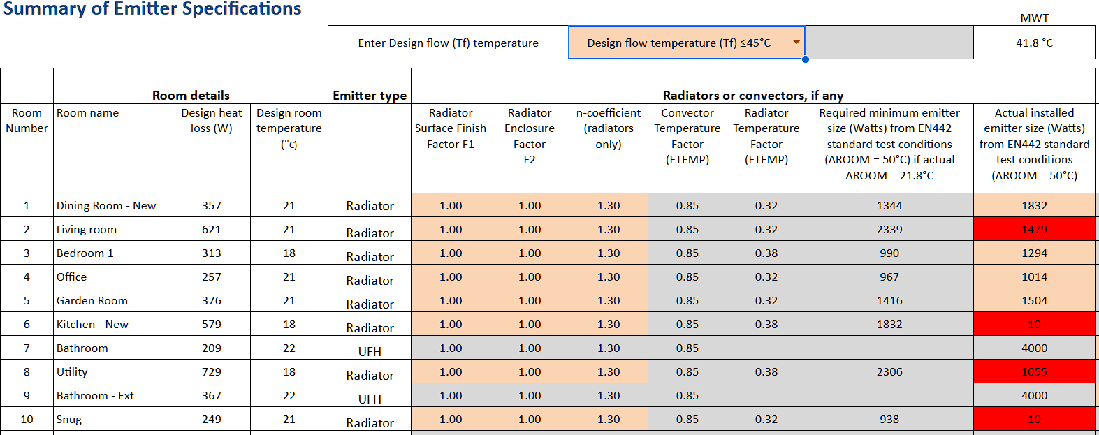

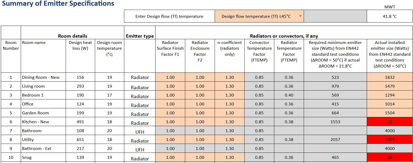

This was the calculation I did a while ago, but the flow temperature has been reduced 10C compared to 55C which i was originally aiming for.
Having lived in it, i don't think it needs a huge amount more output, which is why I was wondering if a small radiator branched off of the flow run would work, and not compromise flow to the rest of the system? And this is more future planning than anything else.
Went through this spreadsheet, as i'd got some incorrect values in there, and also changed the room temperatures to what i like them at

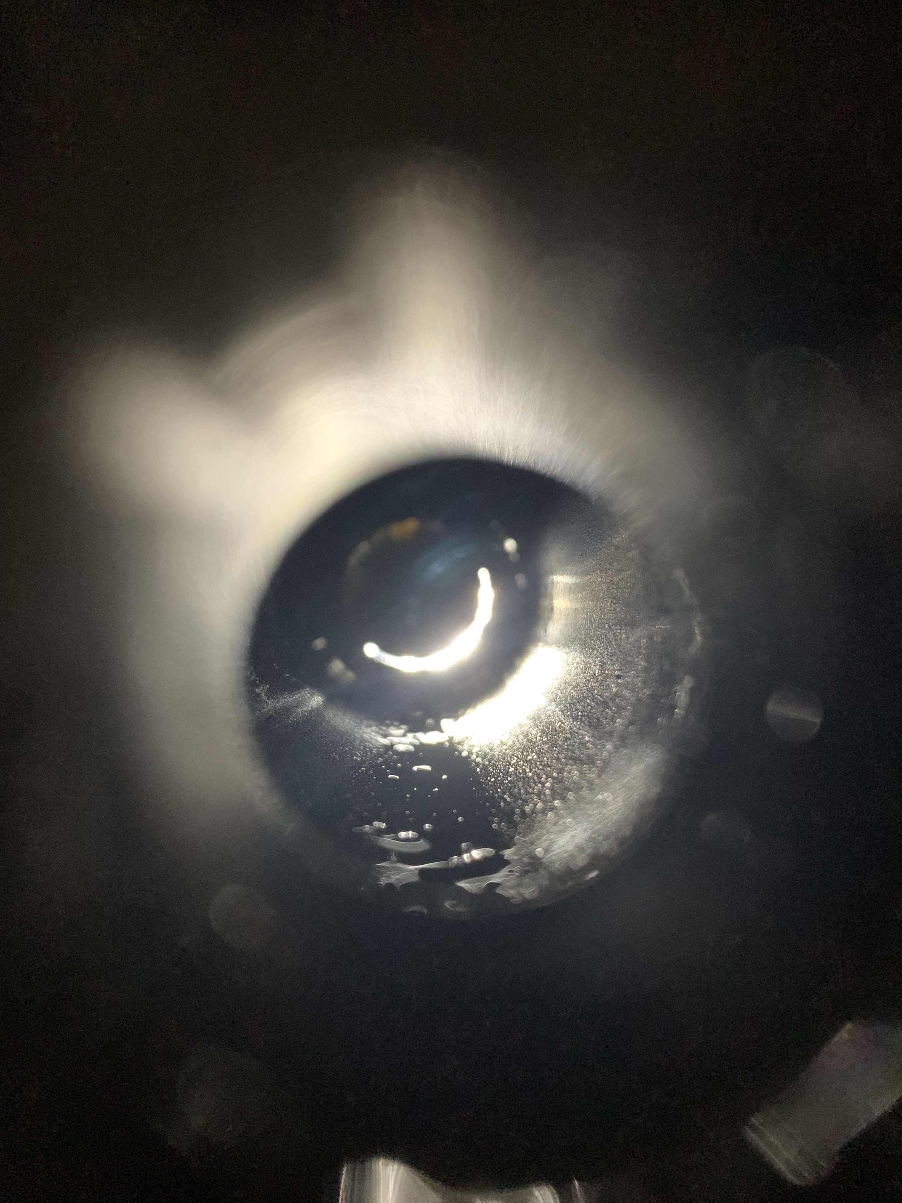

I'm not sure if it helps but I put vertical rads in two bath rooms (the towel rail ladder type rads just weren't cutting it) They were heating the rooms fine at higher flow temps (~55 plus) but one was bloody awful at lower flow temps {~40 deg C)
They were both had equally poor delta T between the flow and return at either higher flow temps or lower flow temps but one definately wasn't much of an improvement on the old ladder type towel rail.
I took the worst one off the wall removed the lockshield and trv and shone a torch down it whilst taking a picture from the other end
That light you can see is the clearance around the inbuilt diverter
I knocked it out and fitted one of these (trimmed it to size)
Difference was like night and day you could feel the first 3 columns getting warm the flow rising to the top and the the cooler water leaving the rad down the columns on the other side.
It was so effective I did the same to the other identical rad - and that one was better too and now they heat the bathrooms to 22 deg C fine even at ~30 deg flow temp

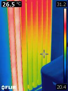

Had a look other day with the Thermal Image camera, and could see a point on the bottom bar around half way where the temperature differed on each side, so I'm guessing there must be a flow restrictor in there. The big ones of these are 8 bars wide, the first 4 bars were slightly hotter than the second 4 bars, which married up with the point where it seems there is a flow restrictor, so it seems in my case this may not be the issue, and the whole of the rad generally showed quite evenly hot.
If they ever come off for any reason, i'll be sure to check this, very useful thank you

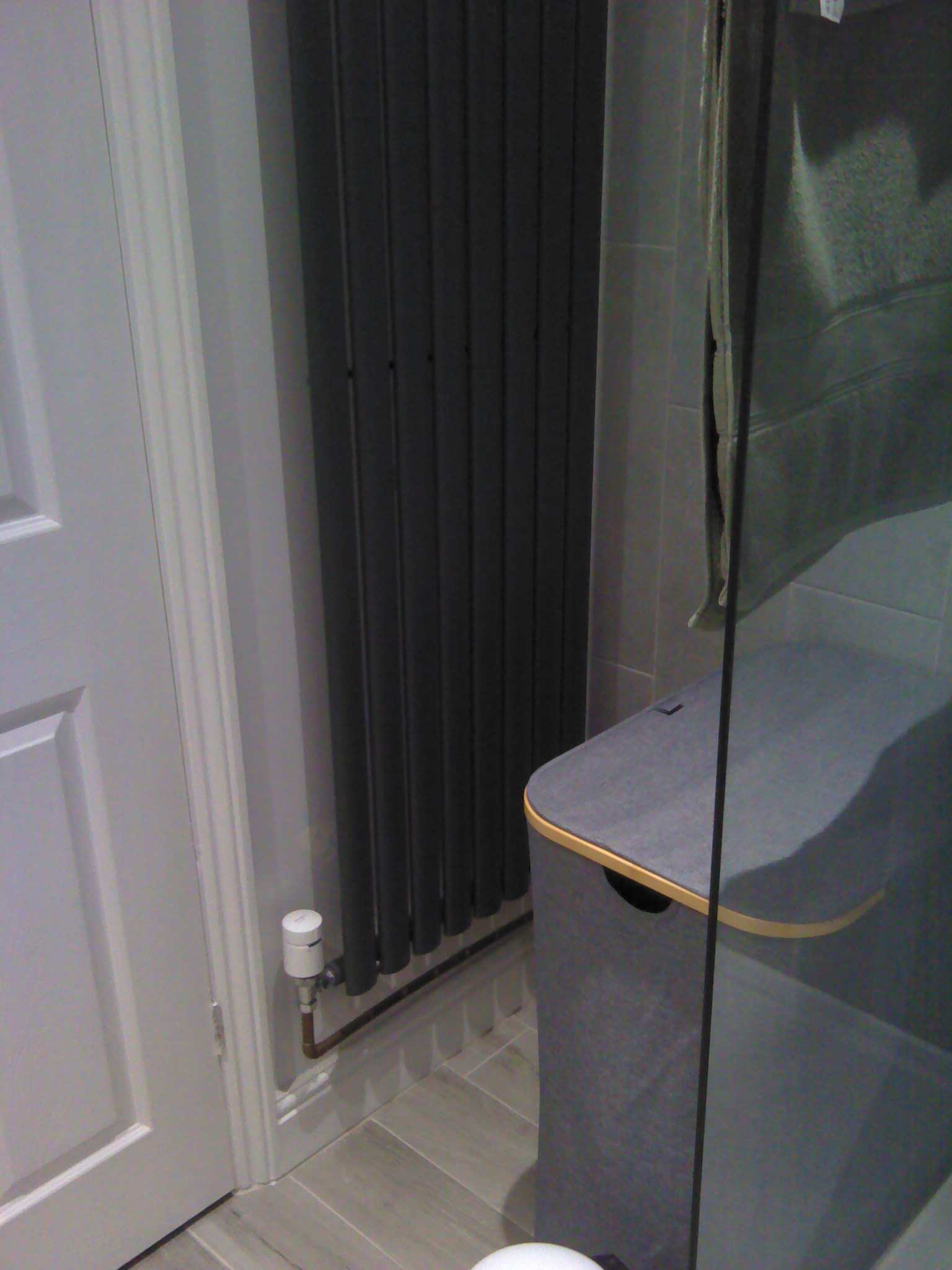

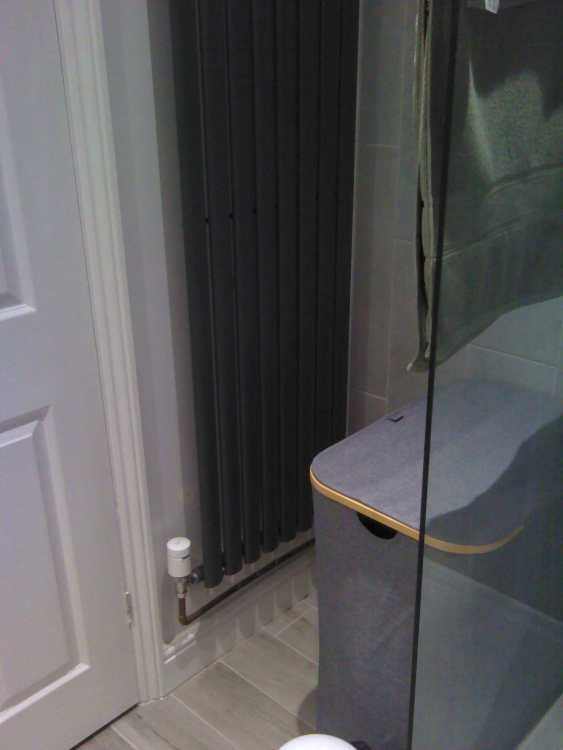

The diverter only actually stops the flow past the first two columns
Here's the rad in situ
And here's the thermal image
10 hours ago, marshian said:
Just because of continuity (and a bump for a question unanswered)
I too got the thermal camera out on my verticals and could clearly see the diverter. In my case it was half and half, diverter was clearly visible in the centre of the bottom horizontal
good tool - I should have borrowed this one sooner

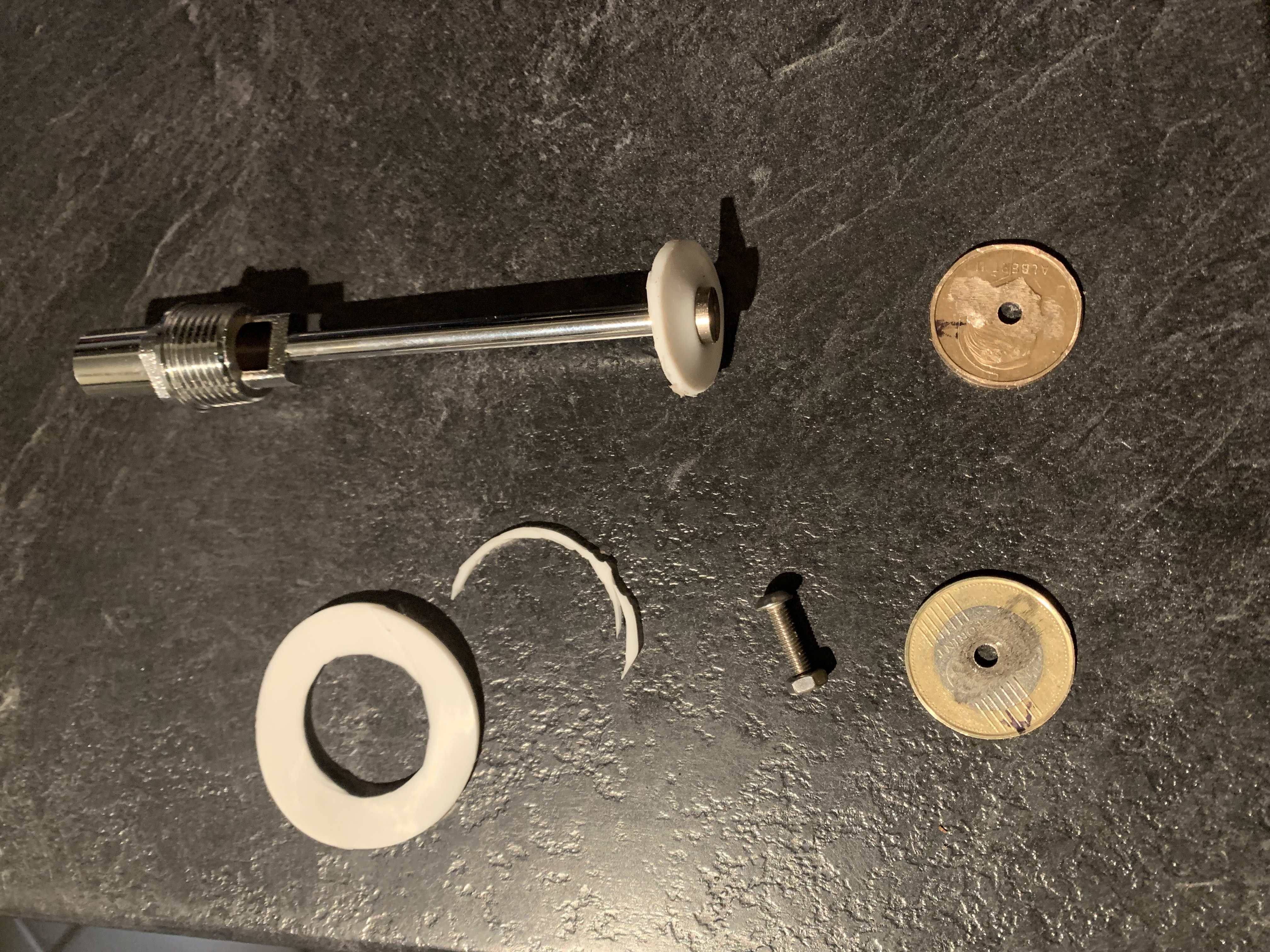

Adding to this - after just under a year of working perfectly I suddenly had an issue with the bathroom room temp - it was sitting at 16 deg C rather than the 20 to 21 that it normally was.
Classic short circuit symptoms - only the bottom horizontal section was warm rest of the rad was cold (I'm running flow temps from 26 to 34 Max so rads are never what you would call hot).
I isolated the rad and drained it down and looking from the opposite end to the diverter it was clear it had inverted and water was passing by.
So I've piped it up TBOE like the rest of the normal rads and normal service has been resumed as far as bathroom temps are concerned.
I don't like the visual appearance of a TBOE set up on a tall vertcal rad so I'll re-do the plumbing in the summer to hide the pipe behind the rad
Having had the diverter failure I'll re-do the identical one in the ensuite as a "planned activity" rather than an activity provoked by Mrs Alien saying "it's bath night the bloody bathroom is freezing what are you going to do about it"
