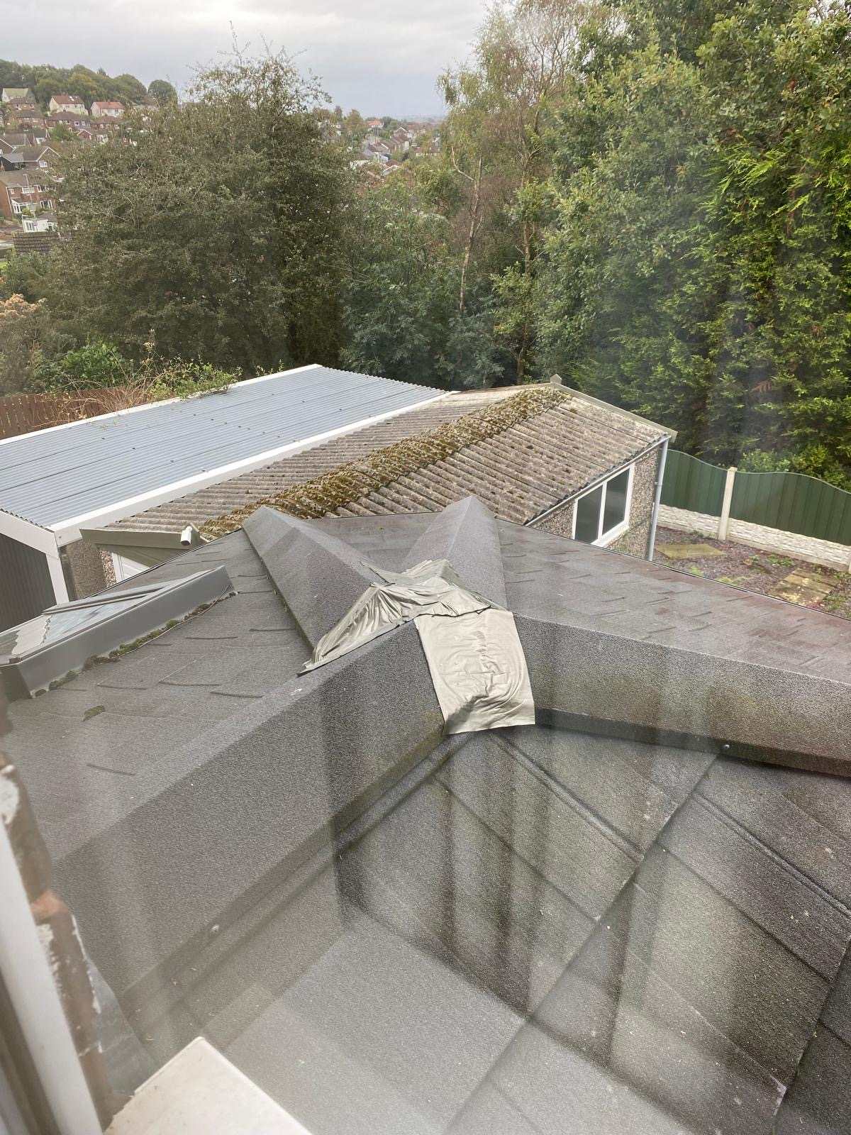

Hi there,

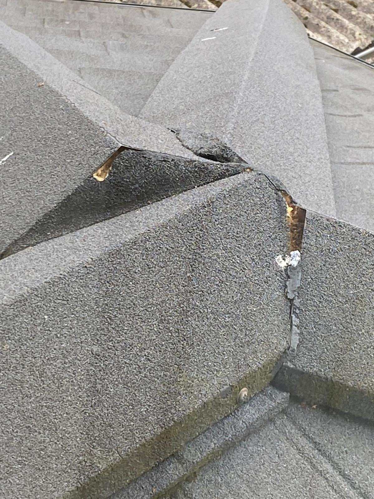

I have a Supalite roof that had some cracks in the ridge joins and I had a roofer come out to stop any potential leak. Unfortunately their solution involved adhering some horrible looking tape (flashband?) over the cracks. I’ve been looking for standalone Supalite replacement parts but it doesn’t seem any stockers / companies cater for repairs.
Does anyone have any suggestions for how best to remedy this in a way that will no longer be an eyesore- either fixing what is already there or covering it up somehow?
Thanks
I have used Lead R which is a bit like flashband but tougher and a darker colour. Take your time to mark and cut the pieces and it should look OK.  That flashband looks awful.
