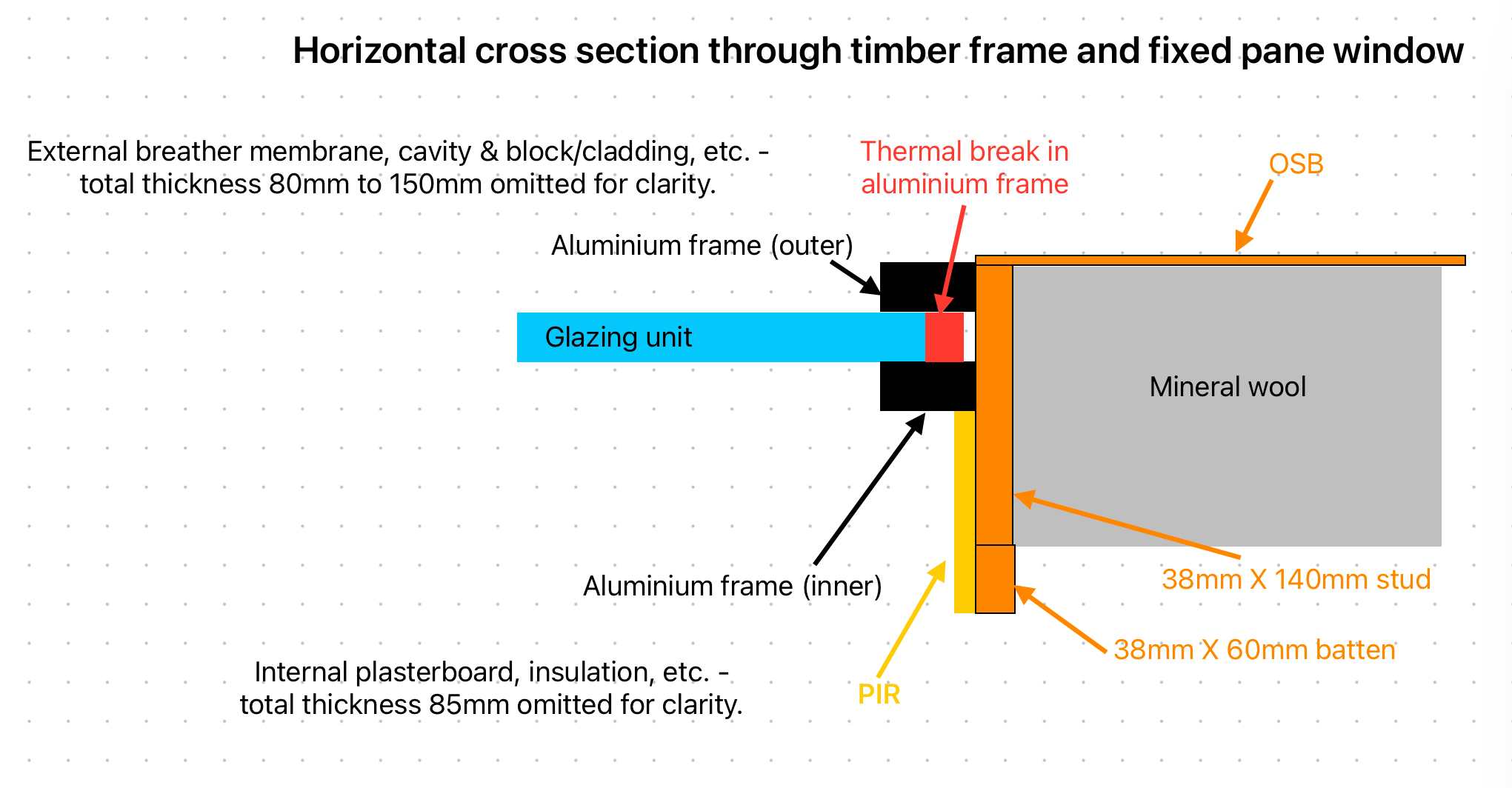

G and J Posted January 15, 2025 Posted January 15, 2025 I’ve a number of questions swirling round in my head re our windows. We will have a traditional timber with a block skin downstairs and wood cladding upstairs. Doors and windows are going all aluminium. I've to date assumed that the outside of the window frames will be more or less flush with the outside of the frame, like this: Is that the best place to put the windows both thermally and for any other factor I can’t imagine?

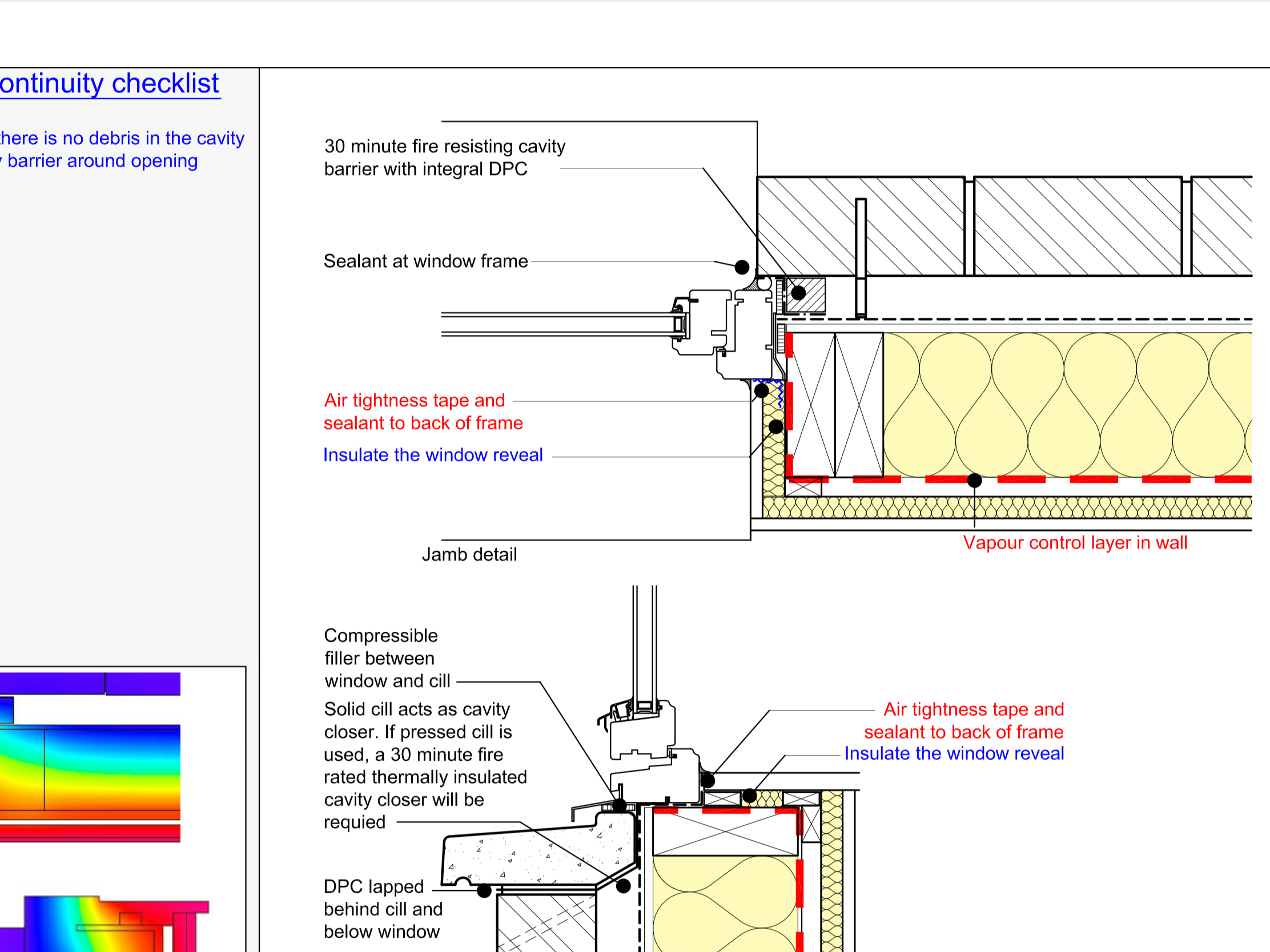

G and J Posted January 16, 2025 Author Posted January 16, 2025 J found a post by @ETC “PART 3 -Timber Frame Junction Detail” from which I’ve found: So it looks to me like behind blockwork I effectively use the windows to close the cavity. Is that correct?
