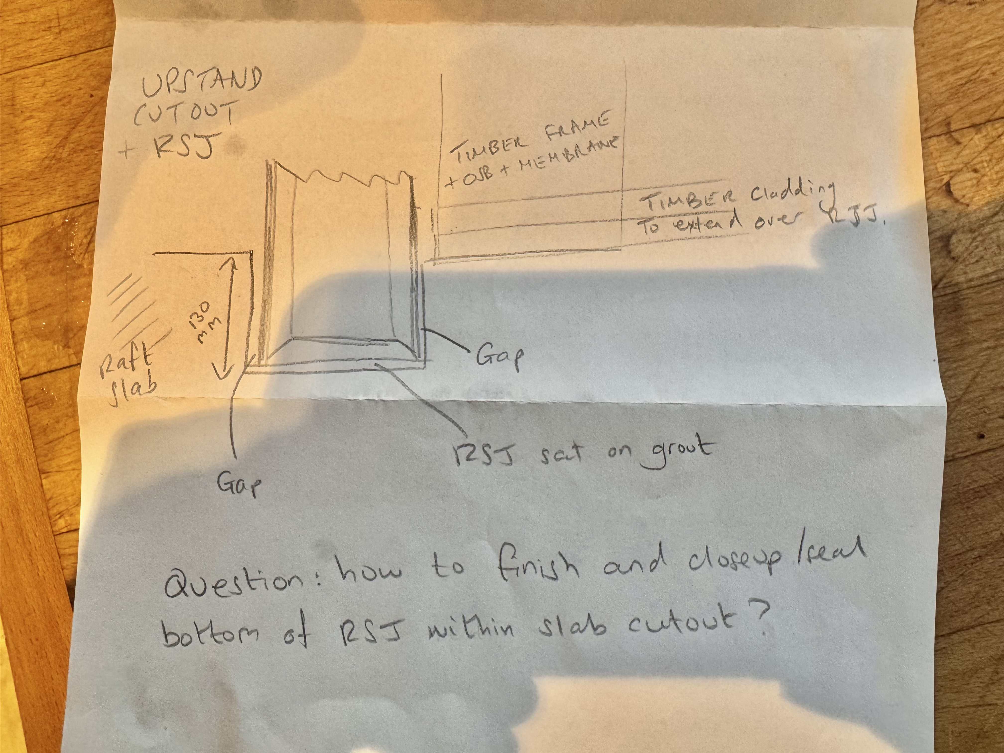

junglejim Posted Saturday at 12:53 Share Posted Saturday at 12:53 (edited) The upstand around our slab is cut for RSJ to fit into at slab level. I’m wondering how best to finish the exterior around this as will be closer to ground level and below the cladding. Presumably it could somehow be sand cement rendered? Thanks Edited Saturday at 12:53 by junglejim Link to comment Share on other sites More sharing options...
nod Posted Saturday at 15:42 Share Posted Saturday at 15:42 You can shot fire a piece of SS mesh to it Then render over it Link to comment Share on other sites More sharing options...
junglejim Posted Saturday at 15:53 Author Share Posted Saturday at 15:53 (edited) 11 minutes ago, nod said: You can shot fire a piece of SS mesh to it Then render over it Thanks, that’s useful. The side facing outwards is the ‘I’ shape so not a face. I’m thinking of insulating, adding noggins and then osb with dpc over but wondering if I’m better off covering in render board and extending down to overlap the slab? Edited Saturday at 15:53 by junglejim Link to comment Share on other sites More sharing options...
nod Posted Saturday at 17:49 Share Posted Saturday at 17:49 Cement board is perfect for render But you still need mesh or a fibre mesh on top of the board Link to comment Share on other sites More sharing options...
junglejim Posted Saturday at 21:43 Author Share Posted Saturday at 21:43 3 hours ago, nod said: Cement board is perfect for render But you still need mesh or a fibre mesh on top of the board Slightly concerned this could be a way for moisture to ingress (around edges of the RSJ) any tips on sealing? Considering expanding foam + mortar to fill gaps. Link to comment Share on other sites More sharing options...
nod Posted Saturday at 21:48 Share Posted Saturday at 21:48 4 minutes ago, junglejim said: Slightly concerned this could be a way for moisture to ingress (around edges of the RSJ) any tips on sealing? Considering expanding foam + mortar to fill gaps. I would use a PU glue Link to comment Share on other sites More sharing options...
junglejim Posted Sunday at 08:19 Author Share Posted Sunday at 08:19 14 hours ago, nod said: Cement board is perfect for render But you still need mesh or a fibre mesh on top of the board Figured a drawing would be useful as still a bit unsure of the best way to finish this. Thanks for all the tips. Link to comment Share on other sites More sharing options...

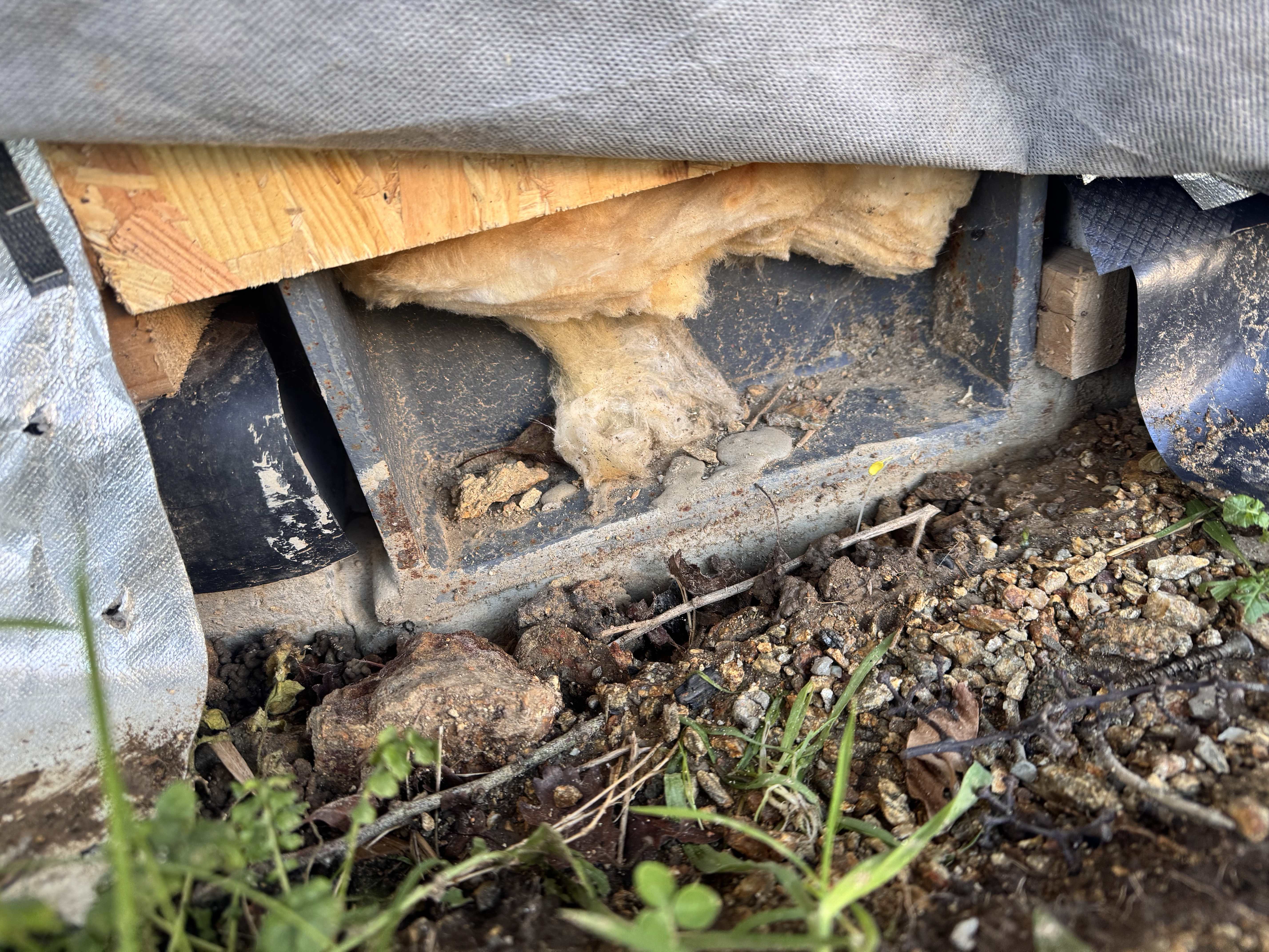

junglejim Posted Sunday at 12:07 Author Share Posted Sunday at 12:07 Here’s a photo of how it is currently. Will obviously need to dig out the ground as well. Link to comment Share on other sites More sharing options...
junglejim Posted Sunday at 21:41 Author Share Posted Sunday at 21:41 I’m wondering if there’s any mileage in filling the base of the RSJ with mortar? But probably not ideal from a cold bridging perspective. Link to comment Share on other sites More sharing options...

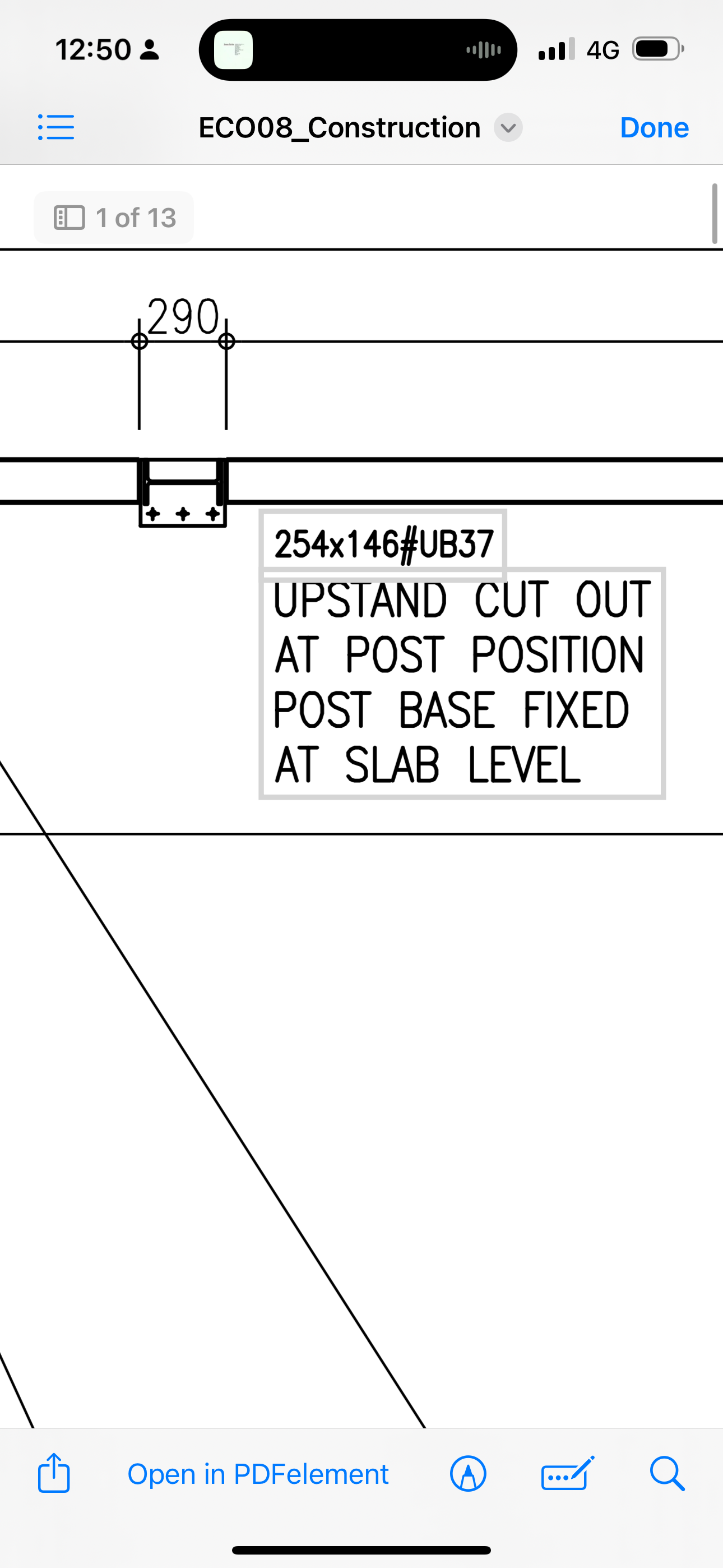

Eric Posted Monday at 22:46 Share Posted Monday at 22:46 What is on the drawings? I would of expected pir infill of the rsj before the osb. Link to comment Share on other sites More sharing options...
