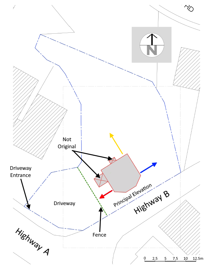

Dre4891 Posted January 3, 2025 Posted January 3, 2025 Hi, Would an extension towards the red arrow (see attached pic) fall under permitted development or would that elevation be classed as fronting a highway? I've had a read through the 'PD Technical Guidance' but the section below is not clear/defined: The extent to which an elevation of a house fronts a highway will depend on factors such as: (i) the angle between the elevation of the house and the highway. If that angle is more than 45 degrees, then the elevation will not normally be considered as fronting a highway; (ii) the distance between the house and the highway - in cases where that distance is substantial, it is unlikely that a building can be said to front the highway. The same may be true where there is a significant intervening area of land in different ownership or use between the boundary of the curtilage of the house concerned and the highway. What is classed as a substantial distance? The distance between the 'original' house and highway is roughly 18m. Thanks for any help.
