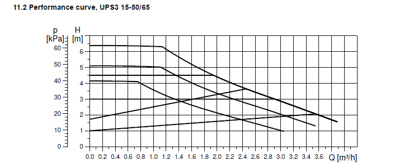

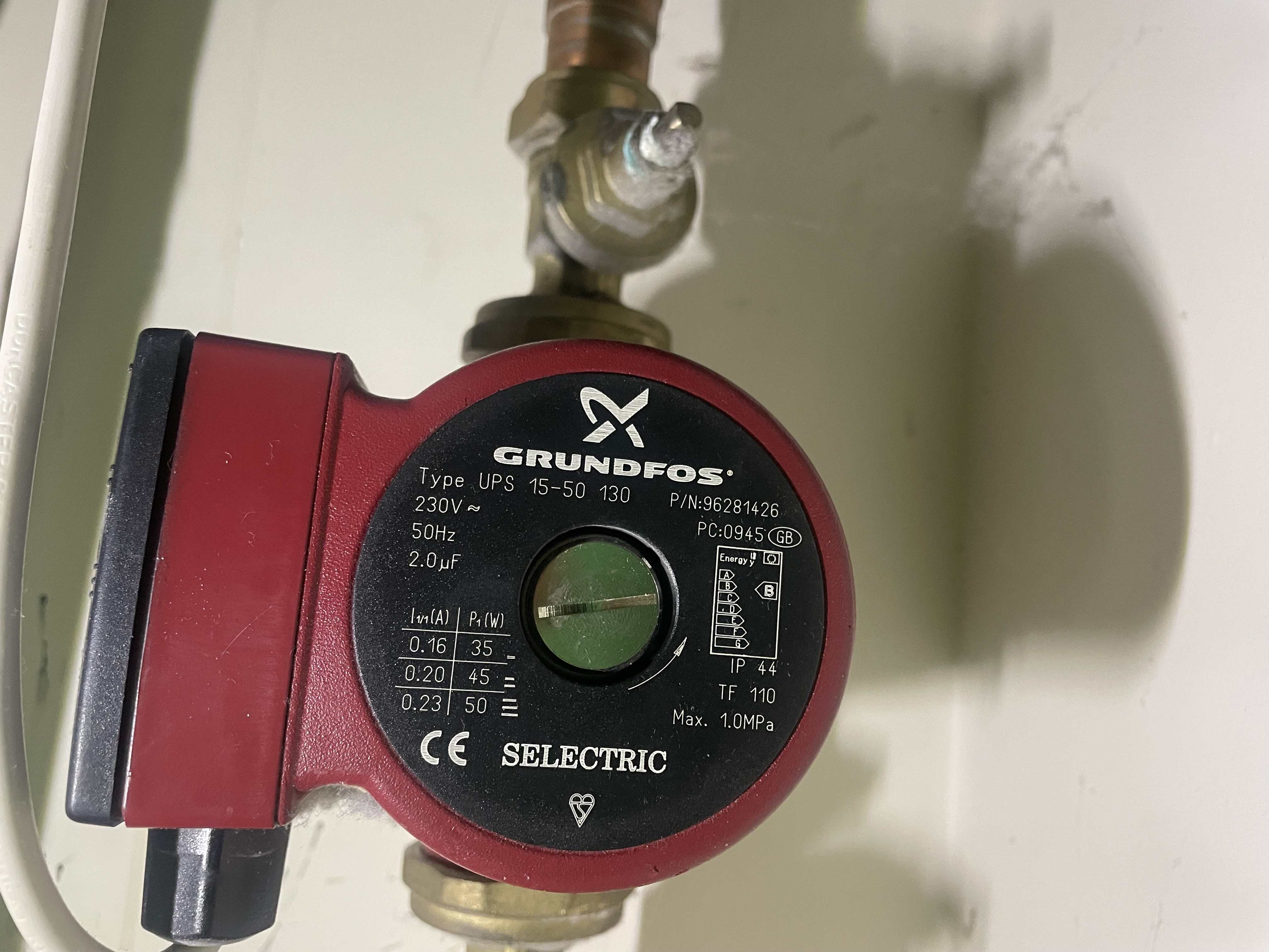

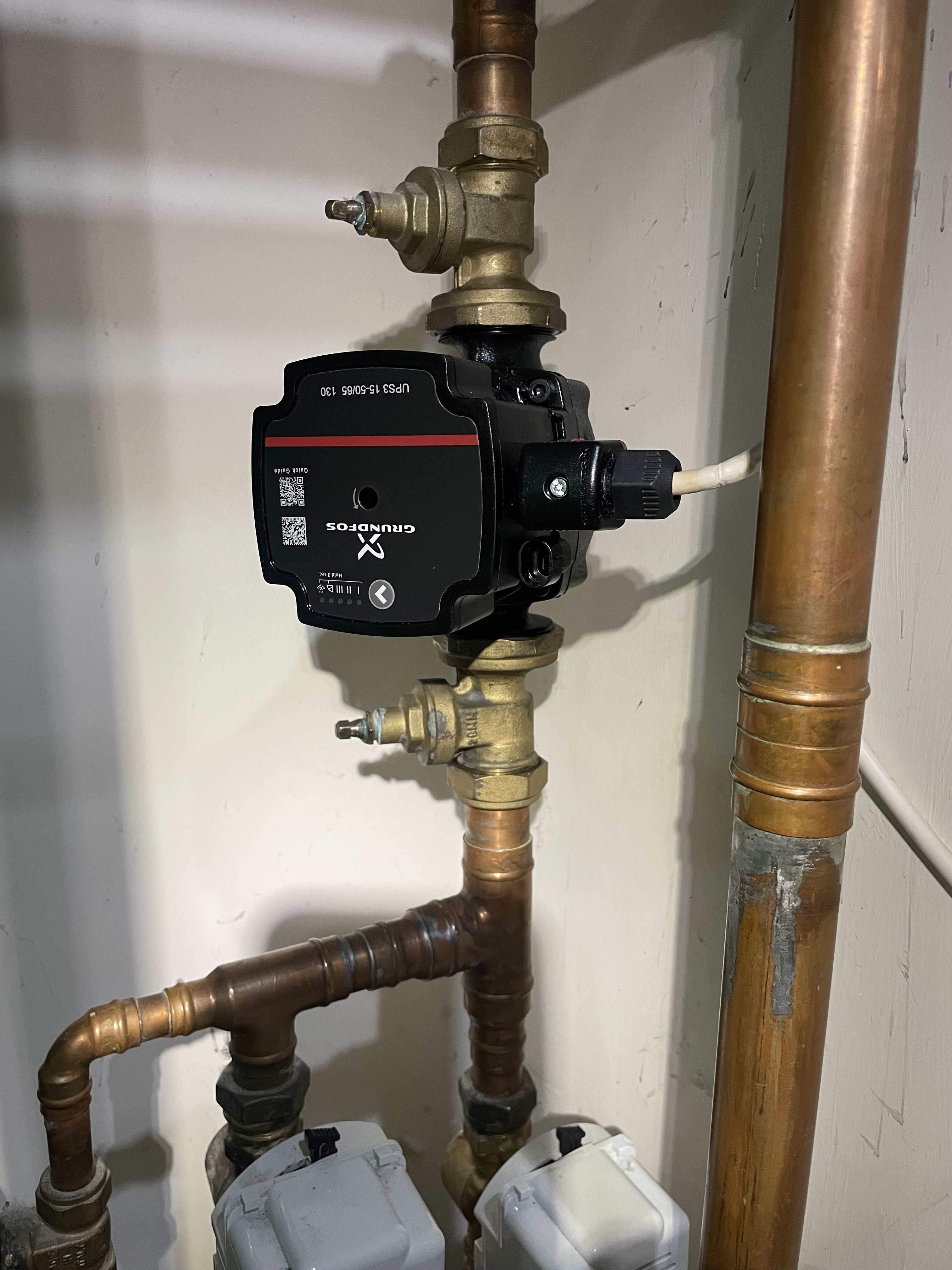

John Carroll Posted January 2 Share Posted January 2 Its a pity that the UPS3 doesn't at least display the pump power in watts, W, from which the flowrate that then easily be read off from the pump cuves, most A rated pumps now not only display this but display the flowrate as well in m3/hr, very useful for trouble shooting, however, a plug in energy monitor which are very accurate can be bought for £15/£20, the pump cable is removed from its JB after noting the ter. numbers/locations, a short length of cable with a socket is then connected to these ter. points, the energy monitor is plugged into the socket, a 3 pin plug is attached to the pump cable and plugged into the energy monitor, I installed one of these a long time ago for someone and its still permanently monitoring the pump power. Link to comment Share on other sites More sharing options...

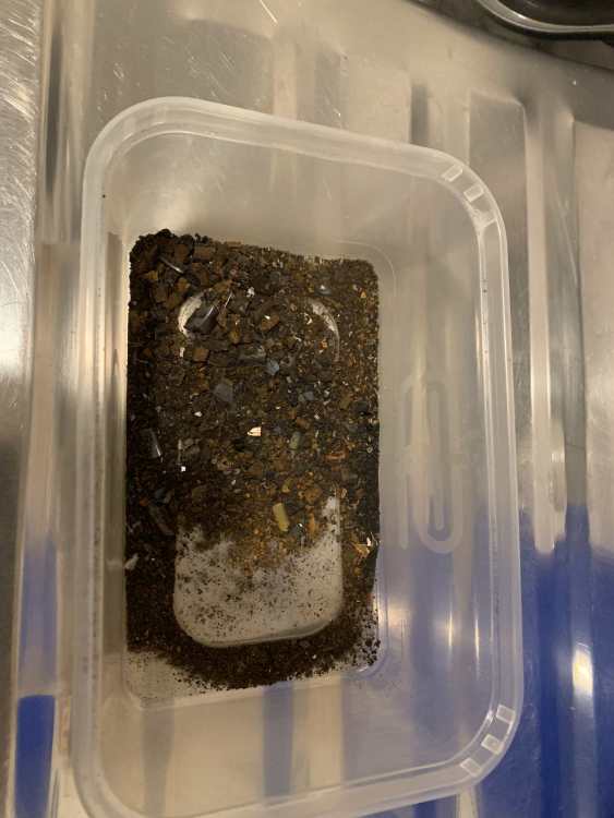

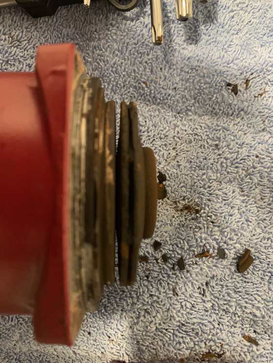

Peaklander Posted January 2 Author Share Posted January 2 (edited) Hi, thanks for the ongoing advice and comments. After plumber #1 had visited and then couldn’t return for a week, I managed to get the radiators hot by a combination of new pump, some bleeding and a little bit of lock shield adjustment at one radiator. Later, plumber #2 advised a flush and fitting of a mag filter. When we refilled it was very hard to get the air out and good circulation but eventually we did. That was done on 21/12 and the heating has worked since then but with venting. The boiler temp has been decreased and it modulates nicely although the temperature is still quite hot at the radiators, which is a little surprising. Today I managed a quick visit and tests that have been suggested. With HW only, there was little change. I didn’t leave it long but nothing obvious happened and venting continued. Switching the pump to ‘constant pressure #1’ caused immediate increase in the water over the vent. This was inspite of the pump sounding slower. So I reverted to ‘constant curve 1’. That’s how I have left it. I’m now wondering if that 150mm pipe between the vent and feed Ts is the culprit. Hopefully plumber #3 will listen before giving advice. Edit. I will reiterate that I don’t know when the venting began but it may well have been since the new pump. The header didn’t have a lid, just a loose fitting bag of insulation and the condensation in the loft was excessive. Edited January 2 by Peaklander Link to comment Share on other sites More sharing options...
John Carroll Posted January 2 Share Posted January 2 The plot thickens but first this pump over conundrum. Expansion effect first, a system with 100L of water and a average flow/return temp of 60C will expand by 1.62%, so 1.62L, this will increase the level in the F&E cistern and in the vent by equal amounts (since its a U tube) so ~ 10 to 15mm as 99% of the expanded volume is taken up by the F&E cistern (well named) but the U tube effect means the level in the vent pipe will rise by the same amount even though the vol of water is tiny. With a perfectly clean system there will still be a very very slight pressure loss in that short piece of pipe in the H as the full circulating flow passes through it, if, for any reason a restriction start building up in that pipe then the U tube starts to become unlalanced with the level in the vent rising and the level in the cold feed falling, eventually, if the restriction becomes very bad, the water will reach the top of the vent and start "filling" the F&E cistern, and water will start flowing down the cold feed. Re UPS pump settings, this is very strange, on CC1 the pump head (4.2M) will be greater than 3.0M (CP1 constant setting) until the flow rate reaches 1.3m3/hr, 21.7LPM, and will not fall below 3.0M until the flowrate is 1.4m3/hr, 23.3LPM so there is no logical reason for this behaviour IMO. However, that as it may, one could fill a small book with pump over problems just because the circ pump was changed, As I said previously a few have changed to my 52 year old system exactly as it is, see below, problems disappeared even though there were no blockages apparent in the H. Link to comment Share on other sites More sharing options...

marshian Posted January 2 Share Posted January 2 5 hours ago, John Carroll said: Its a pity that the UPS3 doesn't at least display the pump power in watts, W, from which the flowrate that then easily be read off from the pump cuves, most A rated pumps now not only display this but display the flowrate as well in m3/hr, very useful for trouble shooting, however, a plug in energy monitor which are very accurate can be bought for £15/£20, the pump cable is removed from its JB after noting the ter. numbers/locations, a short length of cable with a socket is then connected to these ter. points, the energy monitor is plugged into the socket, a 3 pin plug is attached to the pump cable and plugged into the energy monitor, I installed one of these a long time ago for someone and its still permanently monitoring the pump power. Bloody ingenious - I wish I'd have thought of that before I fitted a replacement pump - still got the info anyway now but it would have been nice to compare the old grundfos 3 speed pump - pretty sure the new one uses less electrickery but pumps harder. Actually I still have the old pump but the speed control is broken - if I can get a second hand pump with a working speed controller I could swap it over and refit it - perhaps I should sling a wanted post up. Link to comment Share on other sites More sharing options...

John Carroll Posted January 2 Share Posted January 2 5 hours ago, Peaklander said: Hi, thanks for the ongoing advice and comments. After plumber #1 had visited and then couldn’t return for a week, I managed to get the radiators hot by a combination of new pump, some bleeding and a little bit of lock shield adjustment at one radiator. Later, plumber #2 advised a flush and fitting of a mag filter. When we refilled it was very hard to get the air out and good circulation but eventually we did. That was done on 21/12 and the heating has worked since then but with venting. The boiler temp has been decreased and it modulates nicely although the temperature is still quite hot at the radiators, which is a little surprising. Today I managed a quick visit and tests that have been suggested. With HW only, there was little change. I didn’t leave it long but nothing obvious happened and venting continued. Switching the pump to ‘constant pressure #1’ caused immediate increase in the water over the vent. This was inspite of the pump sounding slower. So I reverted to ‘constant curve 1’. That’s how I have left it. I’m now wondering if that 150mm pipe between the vent and feed Ts is the culprit. Hopefully plumber #3 will listen before giving advice. Edit. I will reiterate that I don’t know when the venting began but it may well have been since the new pump. The header didn’t have a lid, just a loose fitting bag of insulation and the condensation in the loft was excessive. Right, if possible, before your plumber arrives tomorrow??. Just to be sure to be sure, check that the pump is on CC1 as shown by the one green LED. Then change to PP2, as shown by the combination of flashing LEDs on the right, see if you've still got pump over. 1 Link to comment Share on other sites More sharing options...

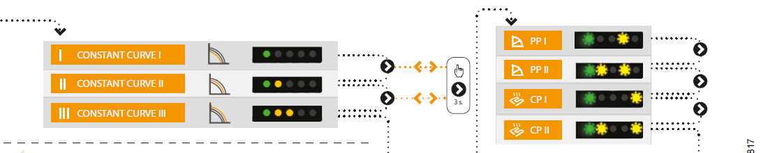

Peaklander Posted January 3 Author Share Posted January 3 (edited) Thanks for the feedback; I'm not surprised by it and it seems to be sensible. I did try the PP2 setting this morning but again only for a short time. The noise from the vent water sounded louder from the bottom of the loft ladder, so I changed back to the (slow) CC1. This is the pump that was replaced. And the new one Edited January 3 by Peaklander Link to comment Share on other sites More sharing options...
Peaklander Posted January 3 Author Share Posted January 3 1 hour ago, John Carroll said: you can try and establish the blockage What do you mean John? Link to comment Share on other sites More sharing options...
John Carroll Posted January 3 Share Posted January 3 (edited) 27 minutes ago, Peaklander said: What do you mean John? By running the UPS3 at its lowest setting PP1 then if you are stlll getting pump over, you have a serious blockage problem, a few other thoughts, those UPS3s have a very poor reputation around here, I know several people who will not install them but I would be a bit surprised if it wasn't running properly in its requested mode. That 50W model of 5M Selectric is one of the lowest head pumps so wouldl expect little or no pump over with it. Are you absolutely sure that there isn't a circ pump in the boiler and that is being boosted by the UPS3 . Anyhow try PP1, if still pumping over then problems. Can you post a photo of the pump LEDs when running in CC1 just now and also when/if running in PP1. Also check both isolating vaves on pump fully open. Edited January 3 by John Carroll Link to comment Share on other sites More sharing options...
Peaklander Posted January 3 Author Share Posted January 3 I'm not there now but there's no internal pump. The best I can do is a screenshot of the page in the manual. Also I appreciate that I might be incorrectly setting the pump mode and so I will go in the morning and try again and gather evidence! I could put the old pump back... Also, I have just spoken to the plumbing company rep. who visited this morning (I'm sure he's a plumber too BTW) and asked why the HW tank has to come out and why we can't "replace all the H pipework". His answer is that with the full job, the problem would be solved and without it, in his experience, "it's never satisfactory". He said that they wouldn't be interested in the pipework alone. I would like to rid myself of the problem (and so would my wife), as I have been trying to keep things going since a couple of weeks before Christmas and then this week into the New Year is a nightmare for getting anyone interested. I can go to one more company on Monday (who access to several plumbers) and perhaps get a final assessment. I don't want to redo the H pipework myself but I could. The only things I need are a 28mm cutter and the pipe & fittings. My parents would also pay the money for the 'full solution' but something says that's just wrong. I guess it's down to confidence that it's the H pipework only. After all, the radiators all get hot so why not? 1 Link to comment Share on other sites More sharing options...

John Carroll Posted January 3 Share Posted January 3 You could check the H (but requires a bit of care) by installing a isolating valve (if not allready) on the F&E cistern mains supply to the ballcock, make up a few fittings and attach a hose or whatever to the vent pipe end, shut the pump inlet valve and carefully crack open the mains to see what kind of flow you are getting through the H and back into the F&E cistern. Link to comment Share on other sites More sharing options...
