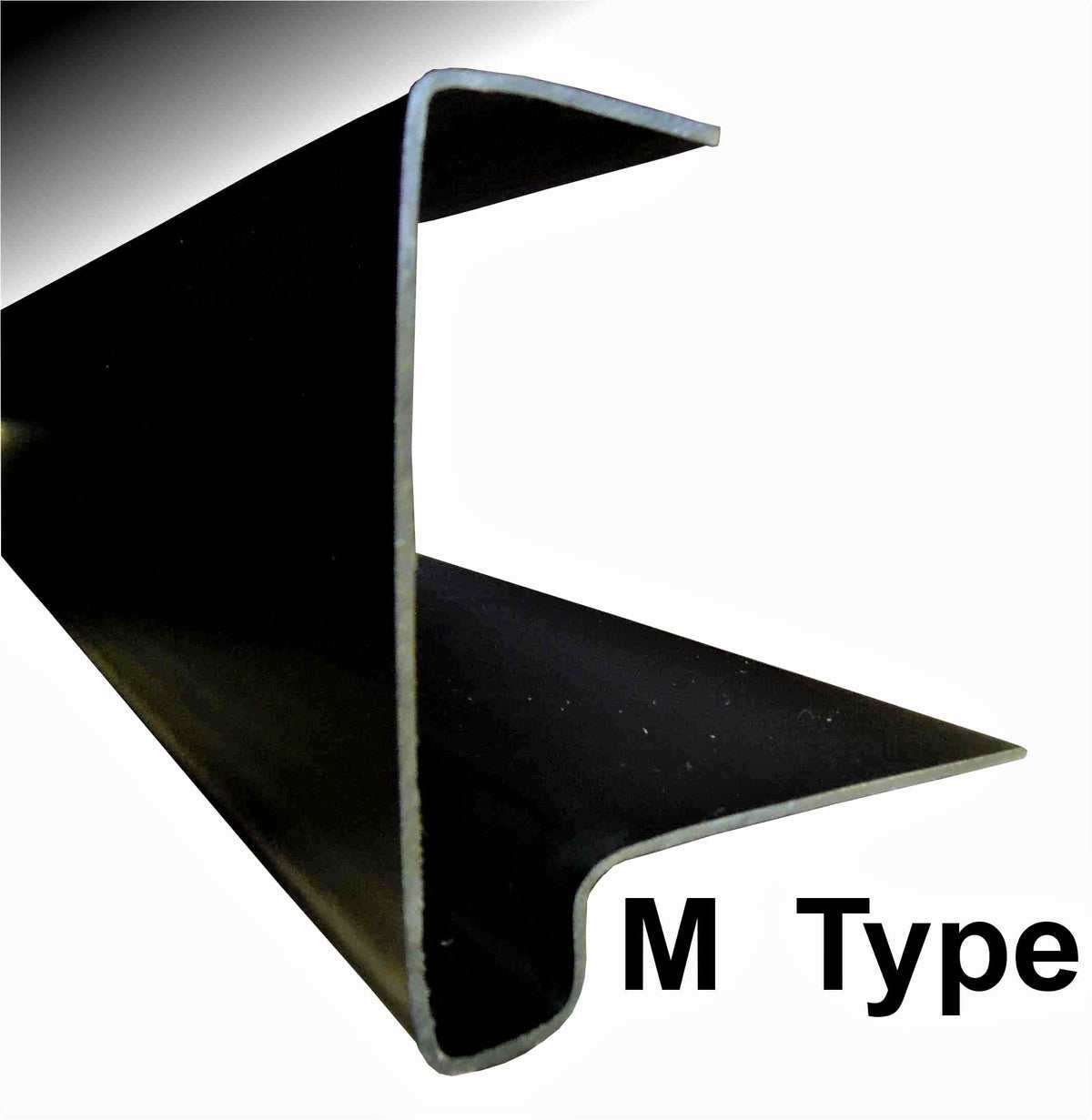

junglejim Posted December 17, 2024 Share Posted December 17, 2024 I’m looking at this dry verge by Kytun for tiles. I can see this working for thin slates but for l tiles (flat profile) there will essentially be a step where each tile overlaps the one beneath which means there would be a large gap into the dry verge where water could easily get in… am in missing something? Link to comment Share on other sites More sharing options...
Chanmenie Posted December 17, 2024 Share Posted December 17, 2024 (edited) Yeah that looks odd, I used a continuous dry verge that had a drainage channel so any water that blows through step gap between tiles is directed under the battens and down the channel Edited December 17, 2024 by Chanmenie Link to comment Share on other sites More sharing options...
