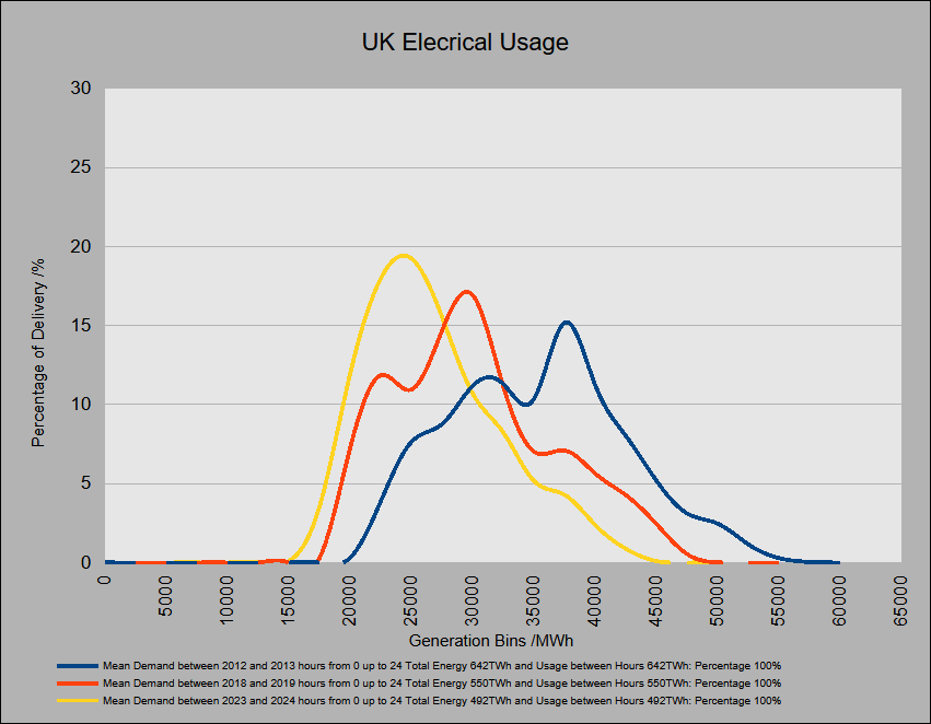

Been off work this week (well almost) so thought I would have a look at how much the nations electrical generation has changed.
So some of my famous charts are coming up.
Basically I downloaded the generation data, created half hour averages (means), then looked at the frequency of delivery to the national grid (the demand).
I picked 3 years, 2012, 2018 and 2023 to save the charts getting too busy.

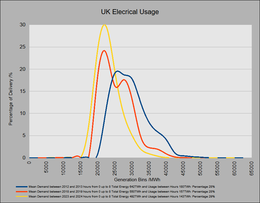

I then did a second batch looking at the usage between midnight and up to 8AM.
I find it interesting how usage has changed and how the distribution is getting smoother.
First chart is all hours of the day.
Second is the 'E7' window.

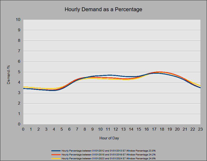

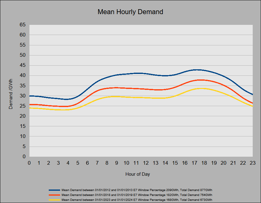

Couple more charts for anyone that is interested.
Hourly demand as a percentage of daily usage and actual energy demand in GWh.
This may be useful if you pay on a variable ToU tariff.
For the 1st two graphs - does that mean that usage has gone down but become more peaky? Are we not expecting usage to go up, or is that the effect of home PV?
Overall generation is down (the energy delivered).
The generation capacity (the power) at the peaks is also down, but the time spent generating at that peak is up by 10%.
(I think, but gridwatch shows energy, not power, but I think I have converted it correctly).
