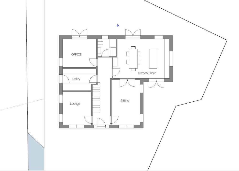

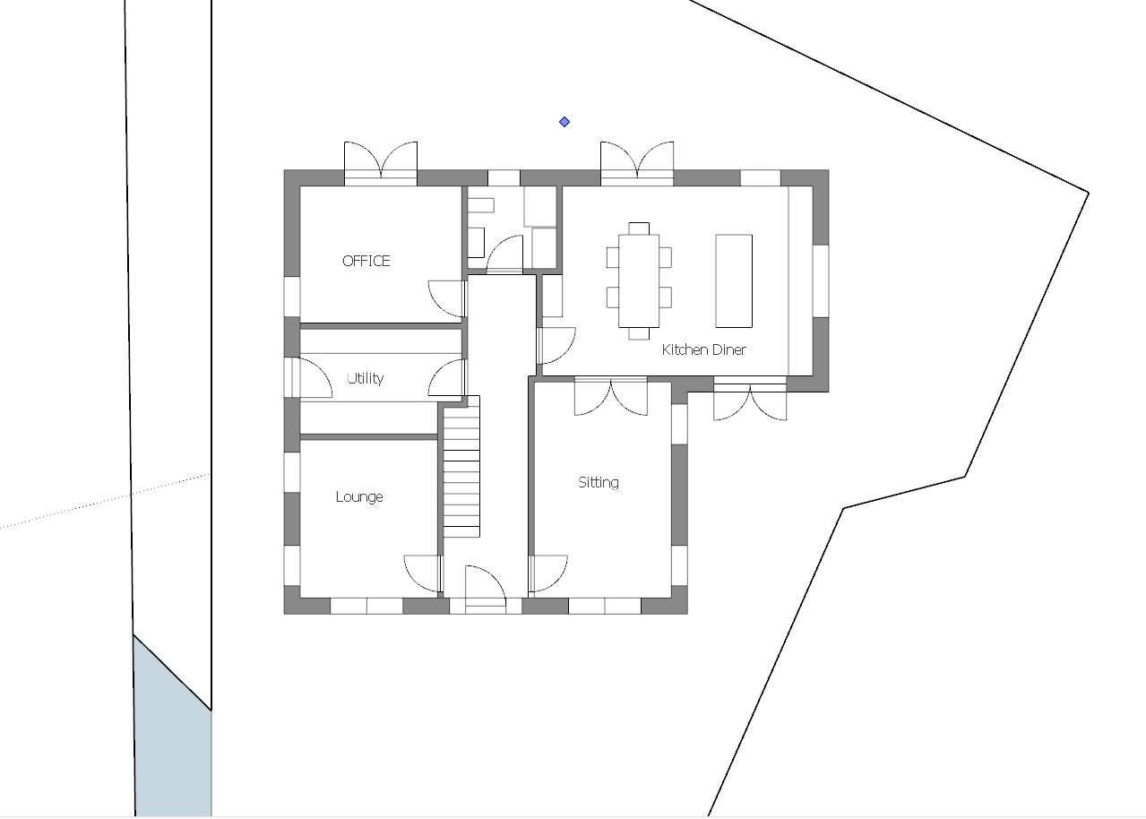

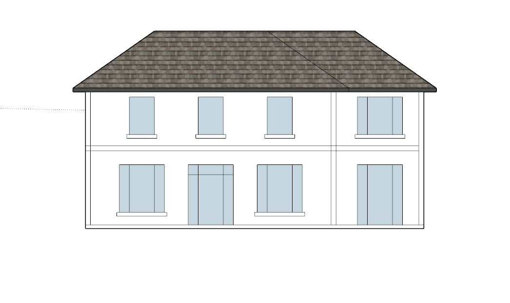

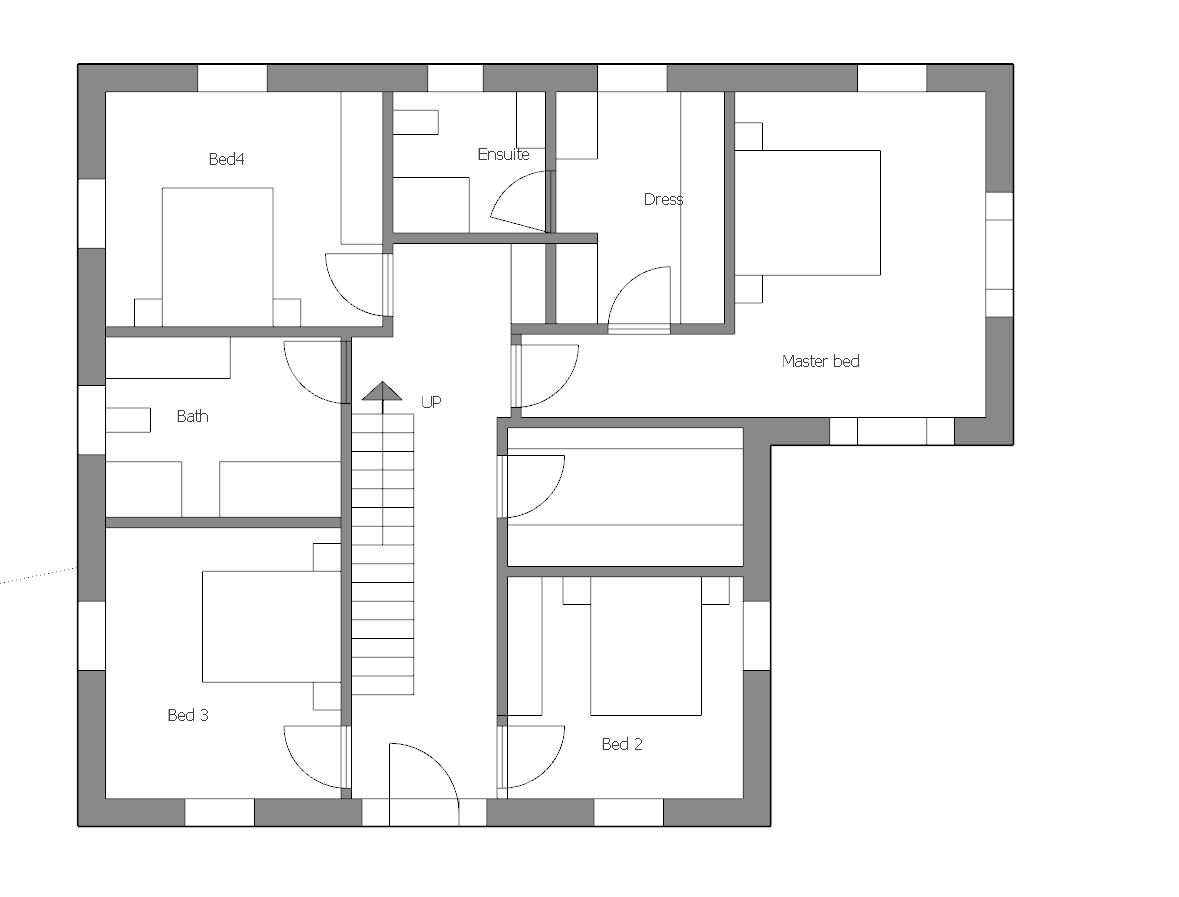

Iceverge Posted December 27, 2024 Share Posted December 27, 2024 (edited) A little rough and ready but i think it works. Should be cheap to build, almost all walls upstairs and down line up. Downstair office has scope to become a bedroom adjacent the downstair WC. Lots of nice southerly light into the kitchen and living rooms. A "wall through" utility to prevent humans cluttering it. I forgot to label the airing/linen store/ laundry upstairs. It's just north of BED 2 The exterior style can be modded easily. Just my default of white walls! . Edited December 27, 2024 by Iceverge Link to comment Share on other sites More sharing options...
