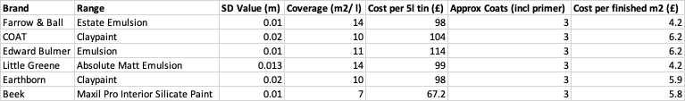

charlieroper Posted November 22, 2024 Share Posted November 22, 2024 We're meant to be using a diathonite thermactive to insulate the walls of our old stone barn we are rennovating. The architect is dead keen on it and from what I read it is great (if expensive and hard to apply). I can't however find anything that goes into any detail about two points: 1) Can you treat it like a normal plaster wall for hanging pictures/putting up shelves? I'm concerned that it's spongy makeup might make it disintegrate if we did. The builder has suggested pattressing with insulation board where we might want to hang heavy things but we want to have flexibility in the future given we don't really own any art now but might want to in the future 2) Given it is "breathable" it needs to be painted with "breathable" paint however there seems to be no universally accepted view of what that actually means. Clay based natural paints seem to be compatible but cost an absolute fortune and we don't want to spend a load of money on the insulation to then ruin it with the wrong paint. Does anyone have any lived experience of using Diathonite Thermactive and can answer these questions? Link to comment Share on other sites More sharing options...

charlieroper Posted December 10, 2024 Author Share Posted December 10, 2024 Thanks @Joshdobbins - that's very reassuring on the ability to hang things, I was wondering if plastic screws for this purpose (given they're not supporting much weight) might be a good option to prevent bridging? On the breathability front I got the technical information which I needed (from 21 degrees which i think is the new name of Ecological Building Systems?). The paint needs to have an SD (steam diffusion) value of 0.0225 or lower for the diathonite to function properly. I did some research as to paint brands/products that fit this criteria, how much they cost, and what their advertised coats/coverage are to give a cost per m2 of finished wall in each case. This is not definitive but might be of some use nonetheless.... 2 Link to comment Share on other sites More sharing options...
