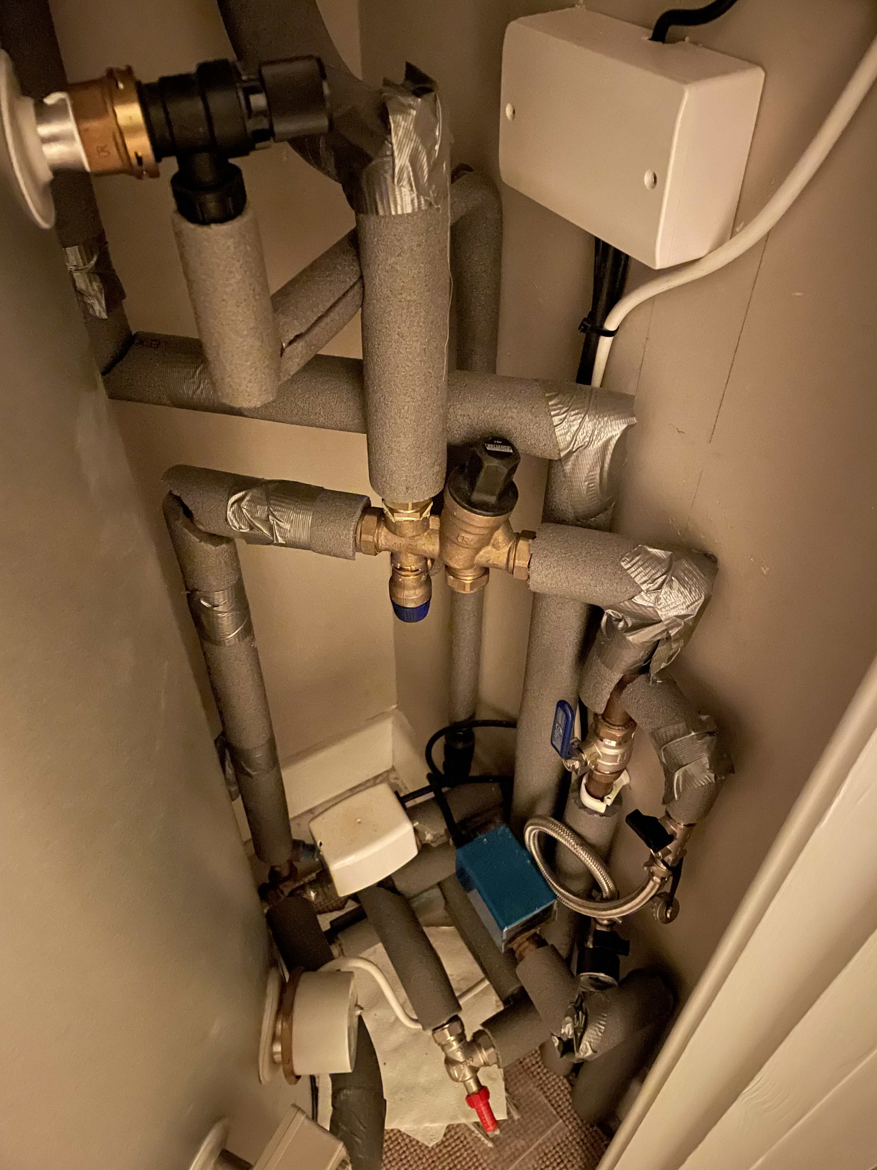

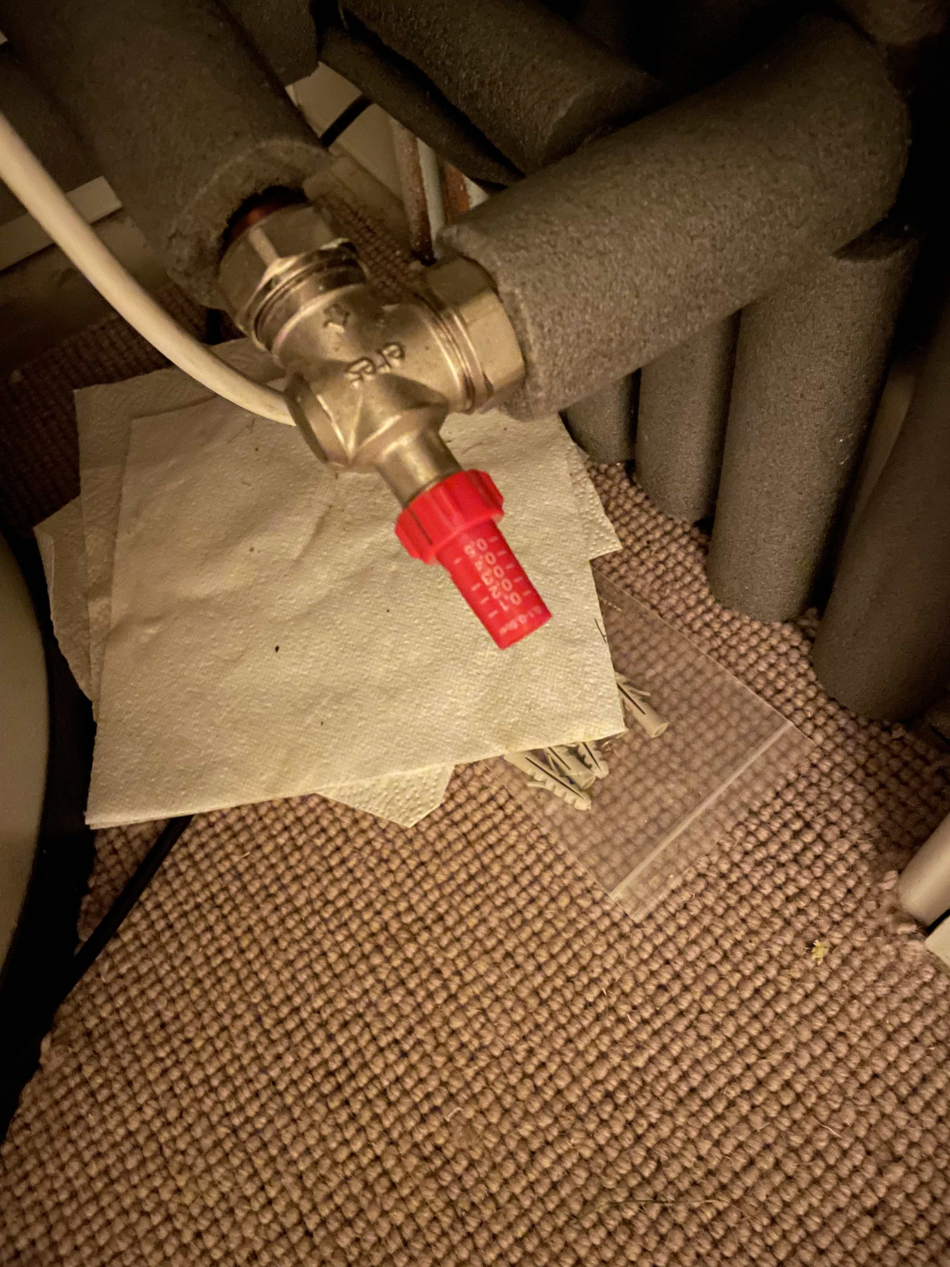

Dan1983 Posted November 20, 2024 Posted November 20, 2024 Evening all, We have been in our build just over 2 years now and had a quick question about the shower flow! When you first put the shower on flow/ pressure is really good, then after about 1 minute it seems to reduce a fair bit. our mains pressure seems to be at 2.5 bar and then drops to about 2 bar with a fully open hot tap Cold seems fine and I’ve often felt upstairs it’s too high as when you flush a toilet some of the initial flush water slightly splashes up It looks like there is a PRV on the mains inlet in kitchen but not sure what I can adjust on the cylinder side of things to maybe give better pressure upstairs?
Mattg4321 Posted November 20, 2024 Posted November 20, 2024 Do you have a problem with flow rather than pressure maybe?
Dan1983 Posted November 20, 2024 Author Posted November 20, 2024 Only thinking not Matt as initial flow seems good. I did take the shower head off last night and the filter/ gauze was about 1/4 clogged with plumbers mate type residue. Its had a water softener from new but maybe the head is slightly blocked?
