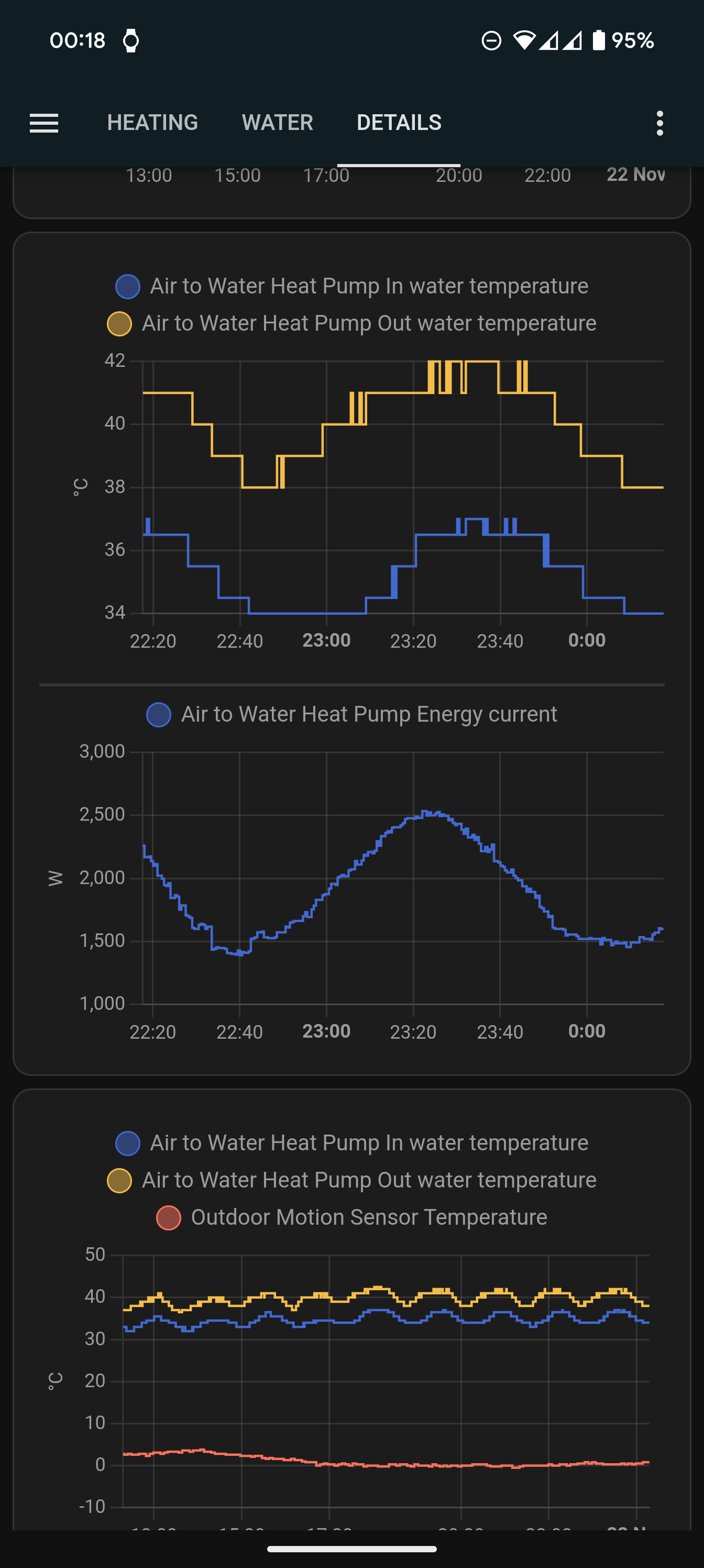

Beef Posted November 22, 2024 Author Share Posted November 22, 2024 Ok, so I have data in home assistant showing the in/out water temps, plus the amount of electricity it's consuming. I have a separate meter for the heat pump (and another for the immersion), and I've confirmed that home assistant is pretty accurate with what it's recording So can I somehow calculate SCOP from that? In these cold days it's running 24/7 - I only have the reused Nest acting as an over-temp cut off. Interestingly, my pump gently cycles up and down during the day; it's not the defrost cycle as that looks different, but I've attached a screenshot showing what I mean. It's not causing any problems - the house is warm - so I'm figuring this is just hysteris, but would like to confirm. Thank you both for your advice and help, it's really appreciated Link to comment Share on other sites More sharing options...

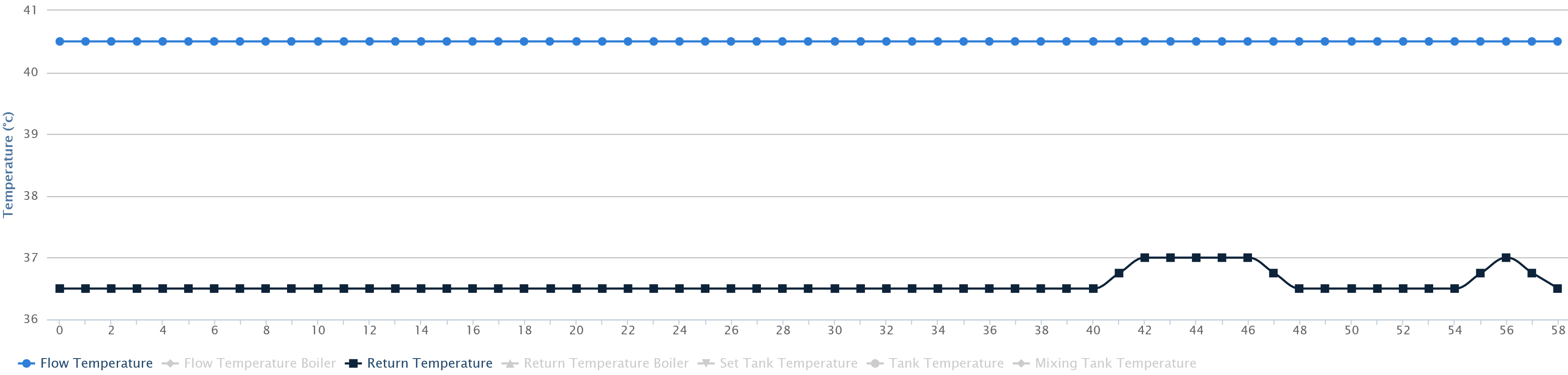

PhilT Posted November 22, 2024 Share Posted November 22, 2024 (edited) 9 hours ago, Beef said: Interestingly, my pump gently cycles up and down during the day; it's not the defrost cycle as that looks different, but I've attached a screenshot showing what I mean Mine does that in the earliest part of the heating season Sep/Oct - it shouldn't be doing that during the last 3 days - In/Out flow temp should be more or less constant, apart from the occasional defrost: Edited November 22, 2024 by PhilT Link to comment Share on other sites More sharing options...
Beef Posted November 22, 2024 Author Share Posted November 22, 2024 Hmm, I might try tuning the hysteris then, see if that has any impact. Link to comment Share on other sites More sharing options...
