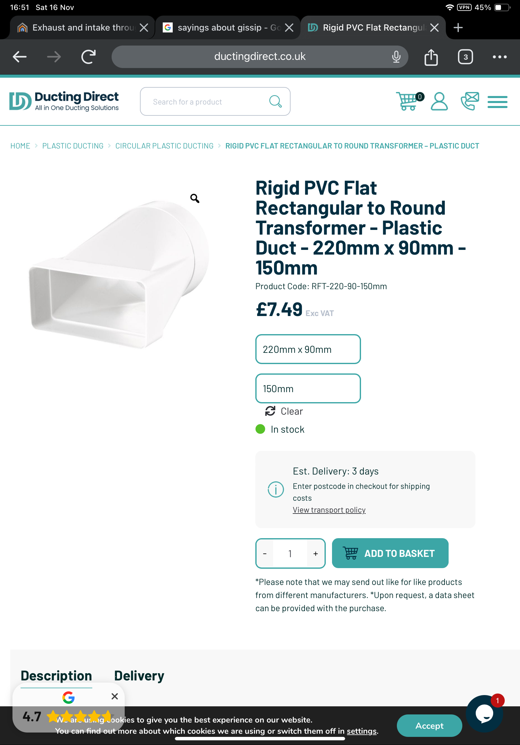

Due to number of issues with getting someone on the roof I'm thinking about running exhaust and intake through soffit. It will also let me clean in from outside through window. Main is issue is the space in soffit so I would want something up to 100mm wide, e.g. 160mm duct to 2x100m vents in soffits.
Has anyone done it? Any recommendations for products to fit it nicely in soffit?

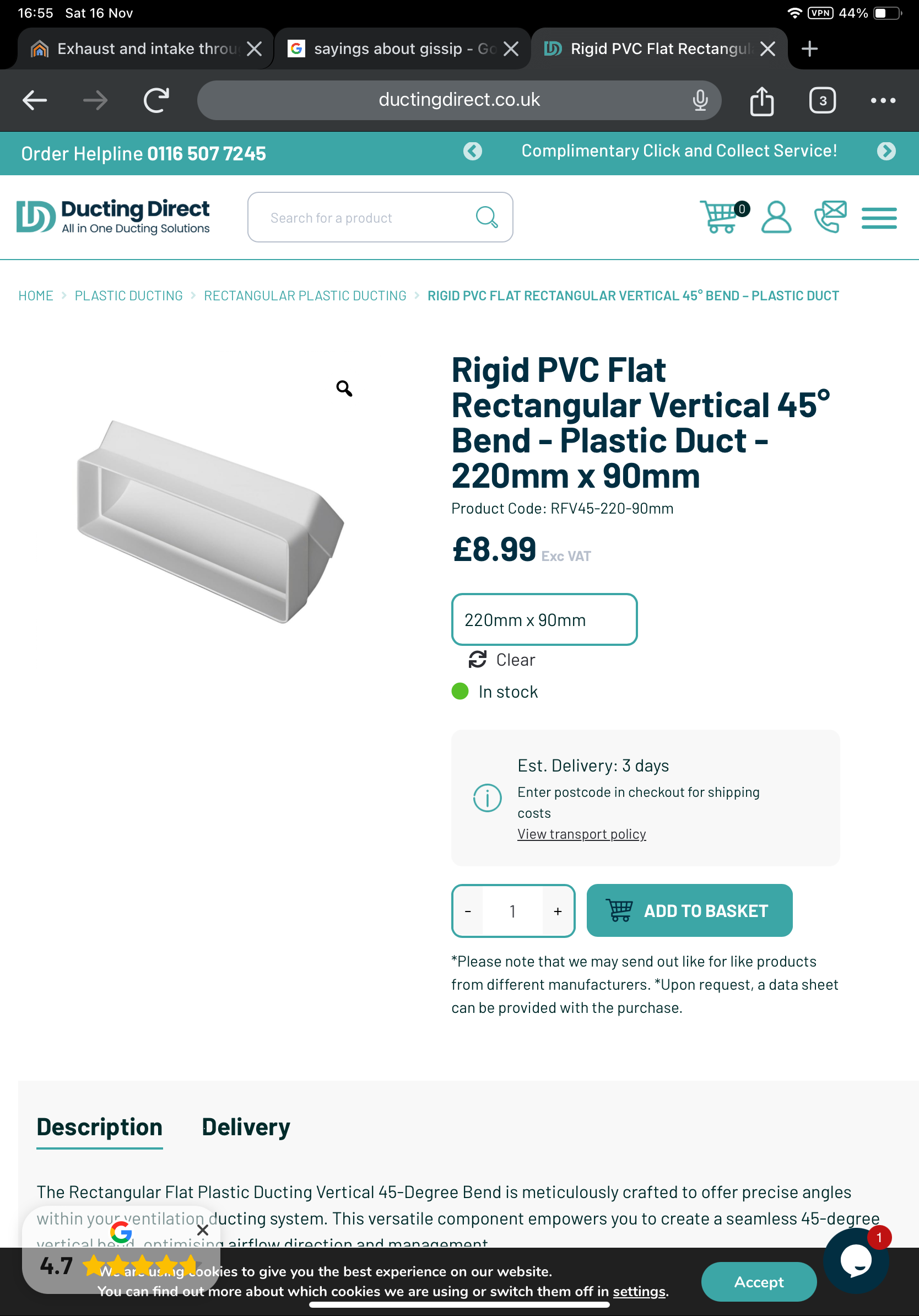

And a selection of appropriate straight sections should work.
220*90 is about the same as 160mm diameter in cross sectional area.
