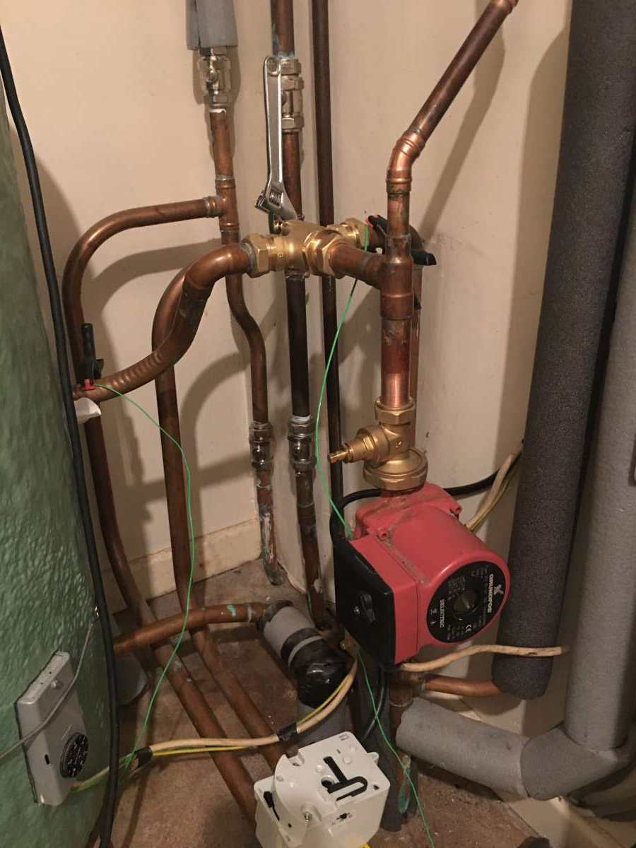

Little Clanger Posted November 12, 2024 Author Share Posted November 12, 2024 In that photo, the flow is from right to left, so hits the 22mm vent first (although of course the pump is on the return, so drawing through the flow rather than pumping). I gleaned the power data from the labels on the pump. Not directly comparable as the Trident is derived from 220v, the Grundfos 240v. The Trident draws more current (0.25 amps compared with 0.17), which at 240v gives 60W compared with 40. Link to comment Share on other sites More sharing options...

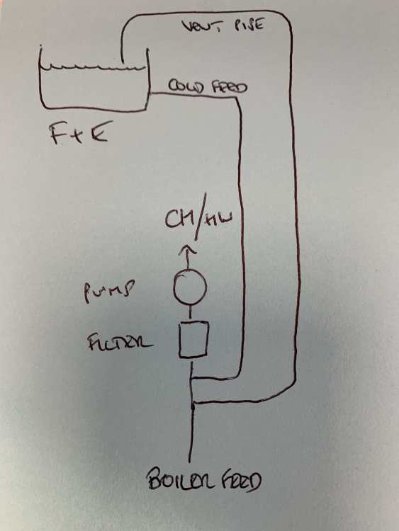

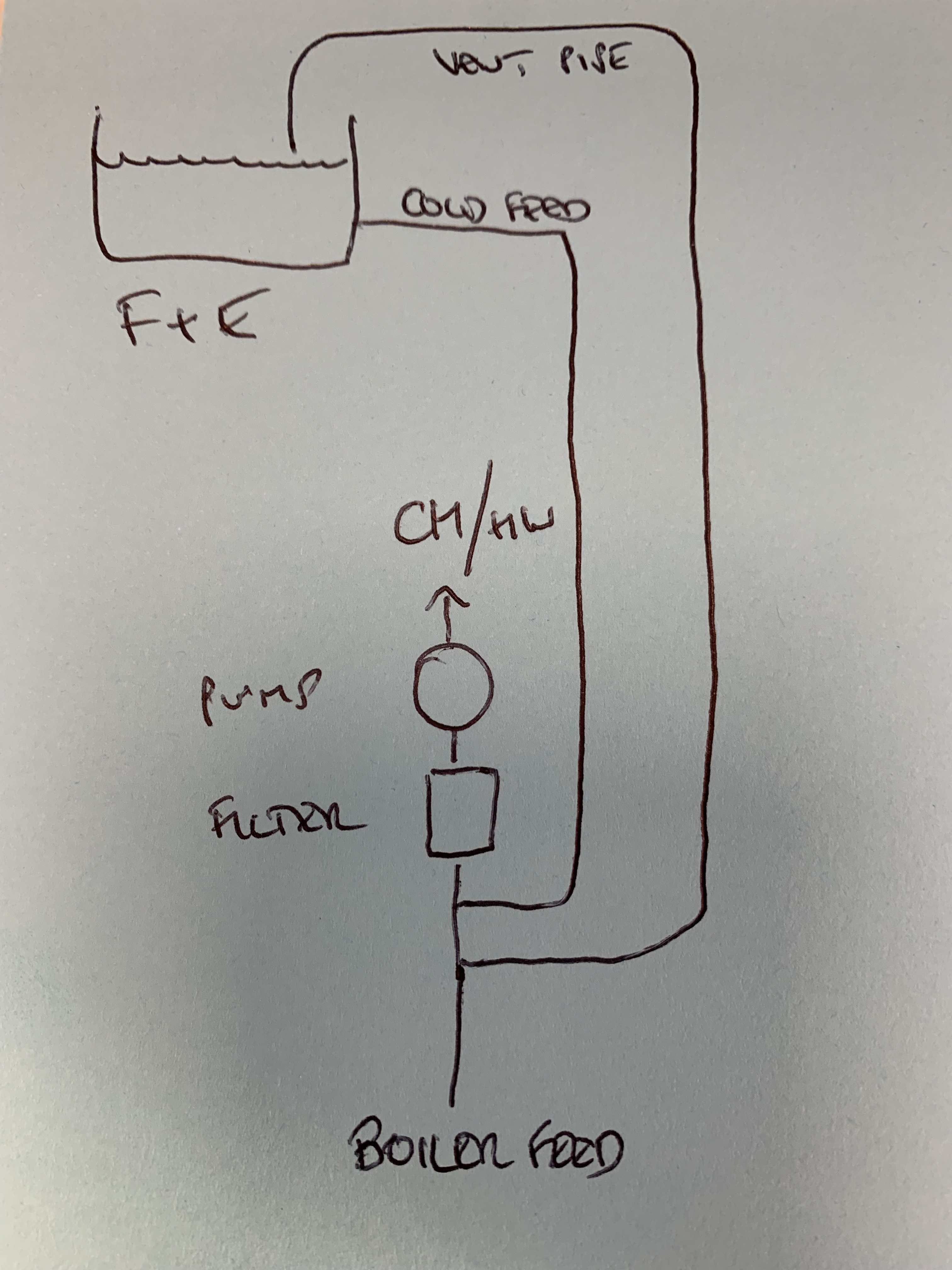

marshian Posted November 13, 2024 Share Posted November 13, 2024 21 minutes ago, John Carroll said: I don't get that, you said, above that, "I've got a pump head of 3.0 m but the actual height of the F&E tank water level to the pump is closer to 2.0 m" ?? can you provide a rough sketch also showing where the cold feed is teed in and position of the vent. Ok see below Link to comment Share on other sites More sharing options...
John Carroll Posted November 13, 2024 Share Posted November 13, 2024 That looks fine, flow from the boiler outlet (hot) with Vent then Cold feed then Pump?. Sometimes the cold feed where its teed into the flow can get partially blocked and cause problems, can you watch the vent for pump over while someone statrs/stops the boiler/circ pump, also try holding that glass full of water with the vent end immersed in it to see if the level falls. What type of filter is installed before the pump?. Link to comment Share on other sites More sharing options...
marshian Posted November 13, 2024 Share Posted November 13, 2024 14 minutes ago, John Carroll said: That looks fine, flow from the boiler outlet (hot) with Vent then Cold feed then Pump?. Sometimes the cold feed where its teed into the flow can get partially blocked and cause problems, can you watch the vent for pump over while someone statrs/stops the boiler/circ pump, also try holding that glass full of water with the vent end immersed in it to see if the level falls. What type of filter is installed before the pump?. Yeah I’ll try the glass of water trick the filter is a magnaclean unit 1 Link to comment Share on other sites More sharing options...
marshian Posted November 14, 2024 Share Posted November 14, 2024 Glass of water results (might have to repeat it with a larger glass) pump on - level stable pump off - load of bubbles followed by a level drop pump on - all the water stolen from the glass Just for info when on HW both cold feed and vent pipes below the pump get hot for a few feet up the wall so there is a level of water in them When refilling the system from a drain down it fills fairly quickly so I think the cold feed is clear I would have expected the vent pipe to have water in it to the same level as the F&E tank Link to comment Share on other sites More sharing options...

John Carroll Posted November 14, 2024 Share Posted November 14, 2024 Yes, something like that. Re your existing set up as per your line drawing, can you give a estimate of the distances starting at the vent.... vent to cold feed, cold feed to filter and filter to pump inlet. Link to comment Share on other sites More sharing options...
marshian Posted November 14, 2024 Share Posted November 14, 2024 22 minutes ago, John Carroll said: Yes, something like that. Re your existing set up as per your line drawing, can you give a estimate of the distances starting at the vent.... vent to cold feed, cold feed to filter and filter to pump inlet. They are effectively stacked (with the absolute min of pipe between all items) Top Zone Valves Pipework Gate Valve Pump (130 mm flange to flange) Gate Valve Magnaclean Unit 22mm T (15mm inlet) Cold Feed 22mm equal T (22mm Vent Pipe) 22mm Flow from Boiler Bottom I can do exact measurements if required but it's all very tightly packaged Link to comment Share on other sites More sharing options...
John Carroll Posted November 14, 2024 Share Posted November 14, 2024 21 minutes ago, marshian said: They are effectively stacked (with the absolute min of pipe between all items) Top Zone Valves Pipework Gate Valve Pump (130 mm flange to flange) Gate Valve Magnaclean Unit 22mm T (15mm inlet) Cold Feed 22mm equal T (22mm Vent Pipe) 22mm Flow from Boiler Bottom I can do exact measurements if required but it's all very tightly packaged So, the magnaclean, cold feed & vent are all very close to the pump inlet (suction end) and the arrow on the pump body is definitely pointing UP?? Link to comment Share on other sites More sharing options...
marshian Posted November 14, 2024 Share Posted November 14, 2024 36 minutes ago, John Carroll said: So, the magnaclean, cold feed & vent are all very close to the pump inlet (suction end) and the arrow on the pump body is definitely pointing UP?? Yes exactly that - 99.9% sure the pump body has an arrow pointing up but I'll check again Link to comment Share on other sites More sharing options...

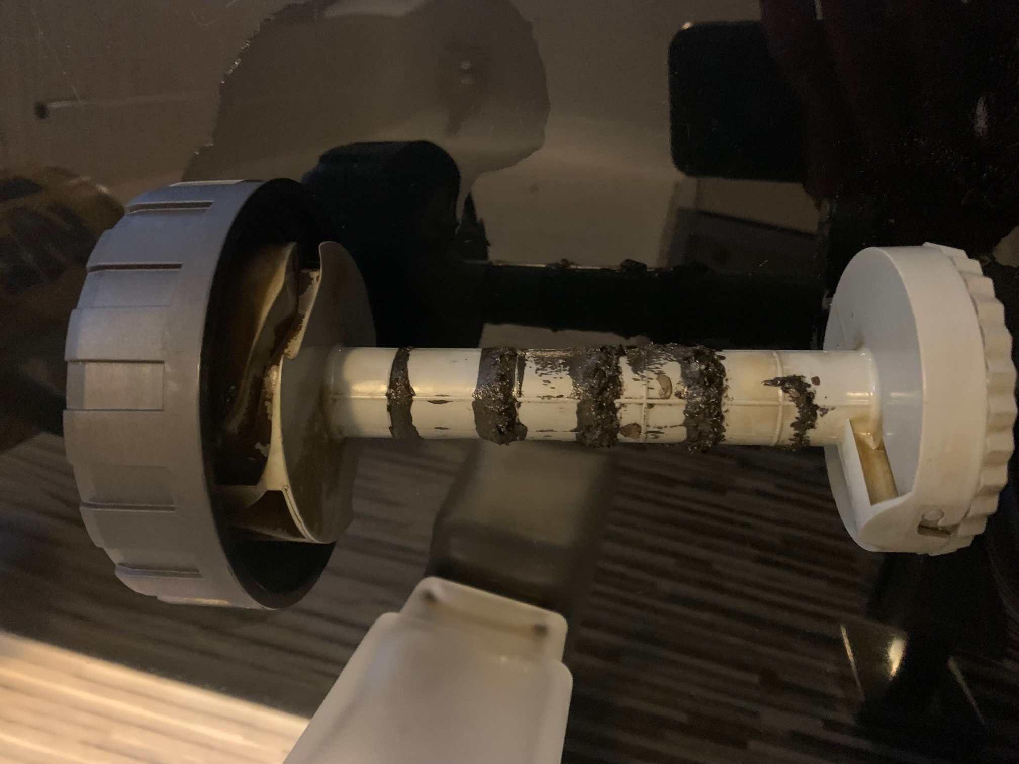

John Carroll Posted November 14, 2024 Share Posted November 14, 2024 (edited) There should be a arrow on the filter body as well, check this is also pointing UP. Is the filter clean? Edited November 14, 2024 by John Carroll Link to comment Share on other sites More sharing options...
marshian Posted November 14, 2024 Share Posted November 14, 2024 1 hour ago, John Carroll said: There should be a arrow on the filter body as well, check this is also pointing UP. Is the filter clean? I'm not aware of an arrow in the filter body but I'll check that too Filter is checked every three months and rarely has much on it - below is as bad as it gets Link to comment Share on other sites More sharing options...
