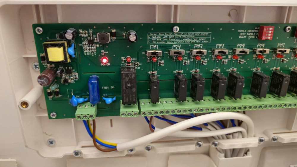

I am replacing Slimline stats for NeoAir for app control.
I have the UH8-RF V2 for controlling the UFH in 5 zones.
Installations states you must find the Channel by looking for the two dials by which the Channel is set. I'm unable to see these anywhere inside the UH8.
So taking a guess at it being one of the 99 channels, the manual states you should select the same Channel in the stat.
Power - then Setup - then arrow down to P2 ( UFH control )
I can't get it to pair at all and as of yet not tried all the 99 channels.
Is there a way to know what channel the UH8-RF V2 is set at where there are no black dials?
Thank you
Lee

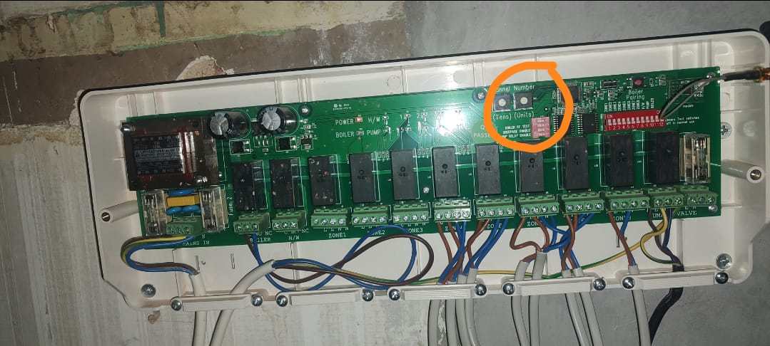

Can you send a pic of the inside of your UH8?
Mine is below with the dials indicated.
Regards
Tet

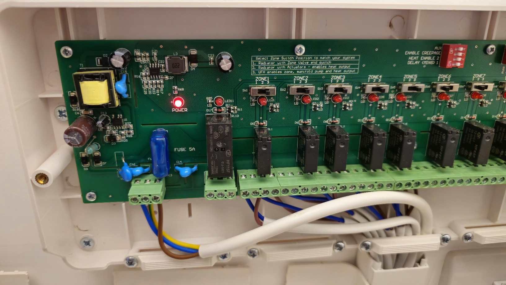

Can anyone see how to select or more tot the point know which channel my UH8-RF V2 is using? Also what are the zone switches for? I can see they are all set to 3. The others which I don't use are set to 1
They are all set to 1 from the factory.
Here’s the manual that should help
https://www.grantuk.com/media/5179/uh8-rf-v2-15-lr-manual.pdf
