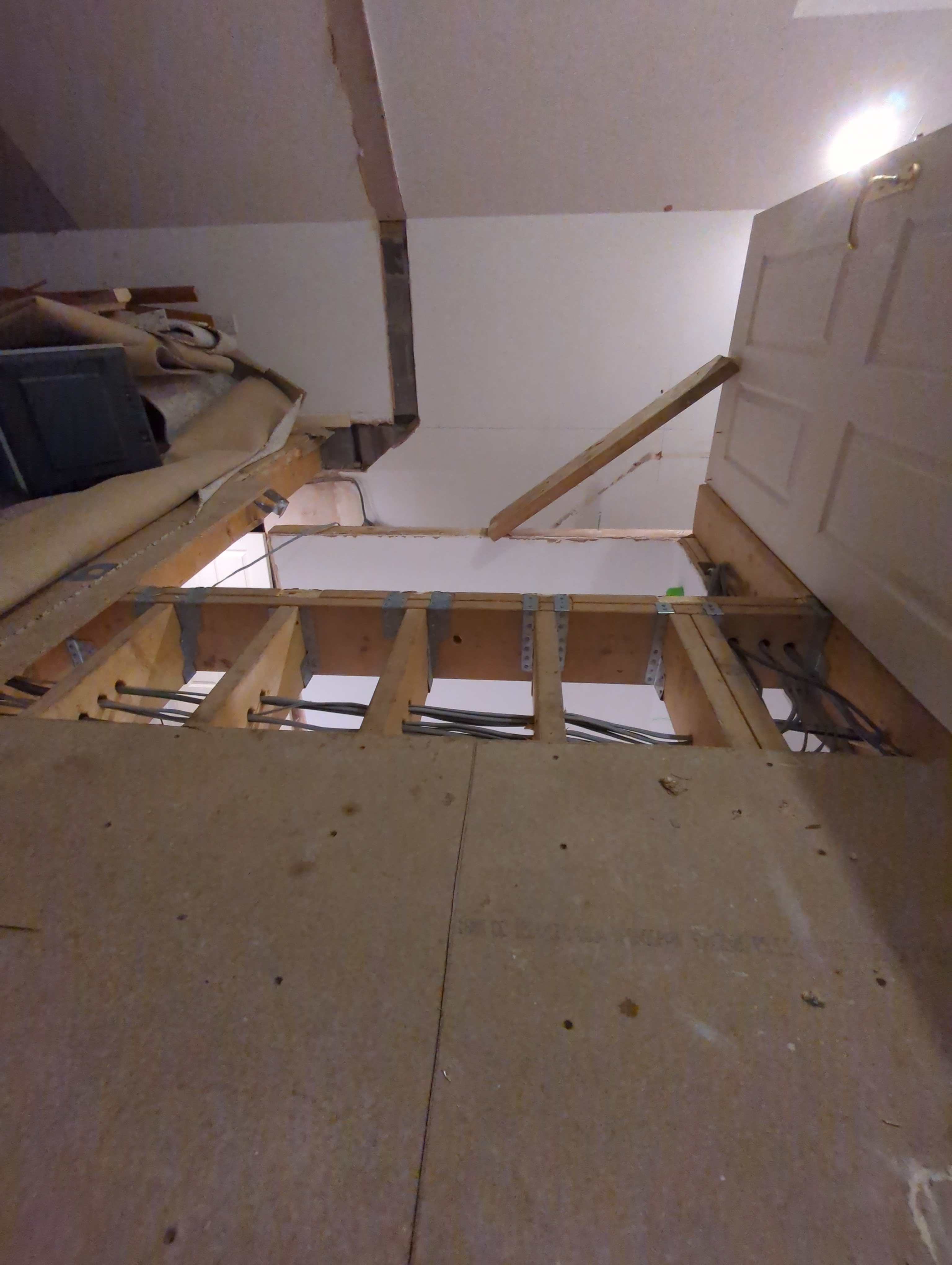

goodbyegti Posted November 2, 2024 Share Posted November 2, 2024 (edited) The family have gone away for half term, so I decided to move the stairs. I need to extend the joists attached to the trimmer, so that they can be hung off the wall. The trimmer won't be supported at both ends, so I think it has to go. Or I need to seriously beef up the joist it's hung off. So I was wondering if anyone has used splice plates to extend joists? I would be adding them right in the middle, near where the sparky has routed all the cables. The original plan was to replace each entire joist with a full length one, but you guessed it, I need to cut literally every service including almost every wire to the consumer unit if I do that. Perhaps I should get on with it? Edited November 2, 2024 by goodbyegti Link to comment Share on other sites More sharing options...
nod Posted November 2, 2024 Share Posted November 2, 2024 Bolt a joist to the wall Fix hangers on the joist and on the trimmer Back to back with what is already there Such a short span will be fine Link to comment Share on other sites More sharing options...
