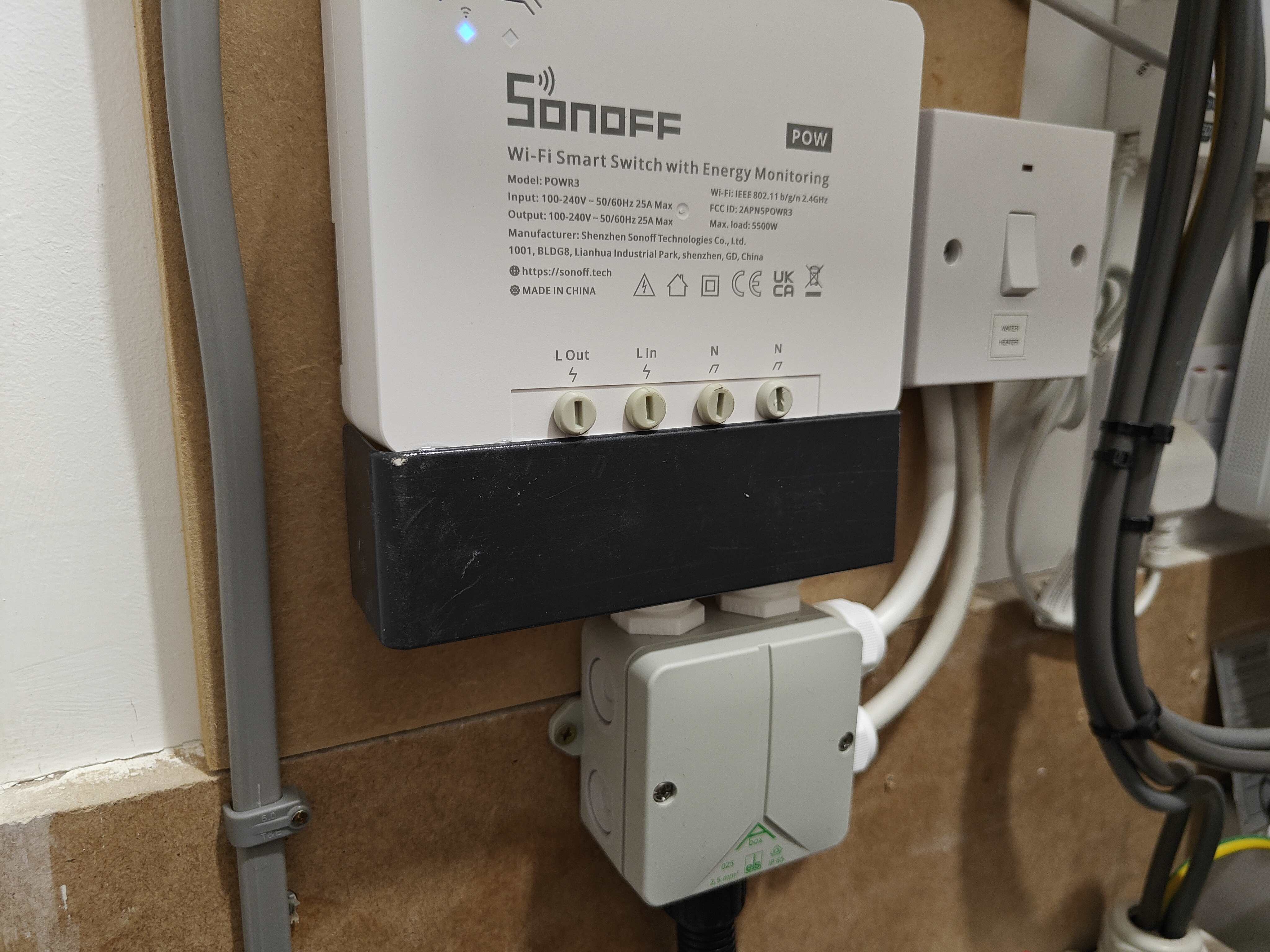

27 minutes ago, Mattg4321 said:
upon further investigation, that’s designed to be fitted inside an enclosure with a DIN rail
That's one of the mounting methods. They supply other fixings
Will get the mechanical protection sorted.
29 minutes ago, Mattg4321 said:
Also, those exposed live terminal screws are a potential danger.
They are quite deep down, but again will get that issue fixed at the same time.
Job for tomorrow.

Posted
On 05/11/2024 at 12:03, sgt_woulds said:
Are those single-insulated tails?  (Blue and Brown cables)  If so, they need additional mechanical protection to comply with wiring regs.
13 hours ago, Mattg4321 said:
Exposed basic insulation (brown and blue). Needs mechanical protection as above. Also, those exposed live terminal screws are a potential danger.
Should all be sorted now.
Mechanical protection added to front and sides of the brown and blue tail.
Terminal screw points blocked off with removable plugs.
Solution keeps plenty of cooling effect around the relay. Cupboard used as an MVHR through space to plant/storage room above which has an MVHR extract

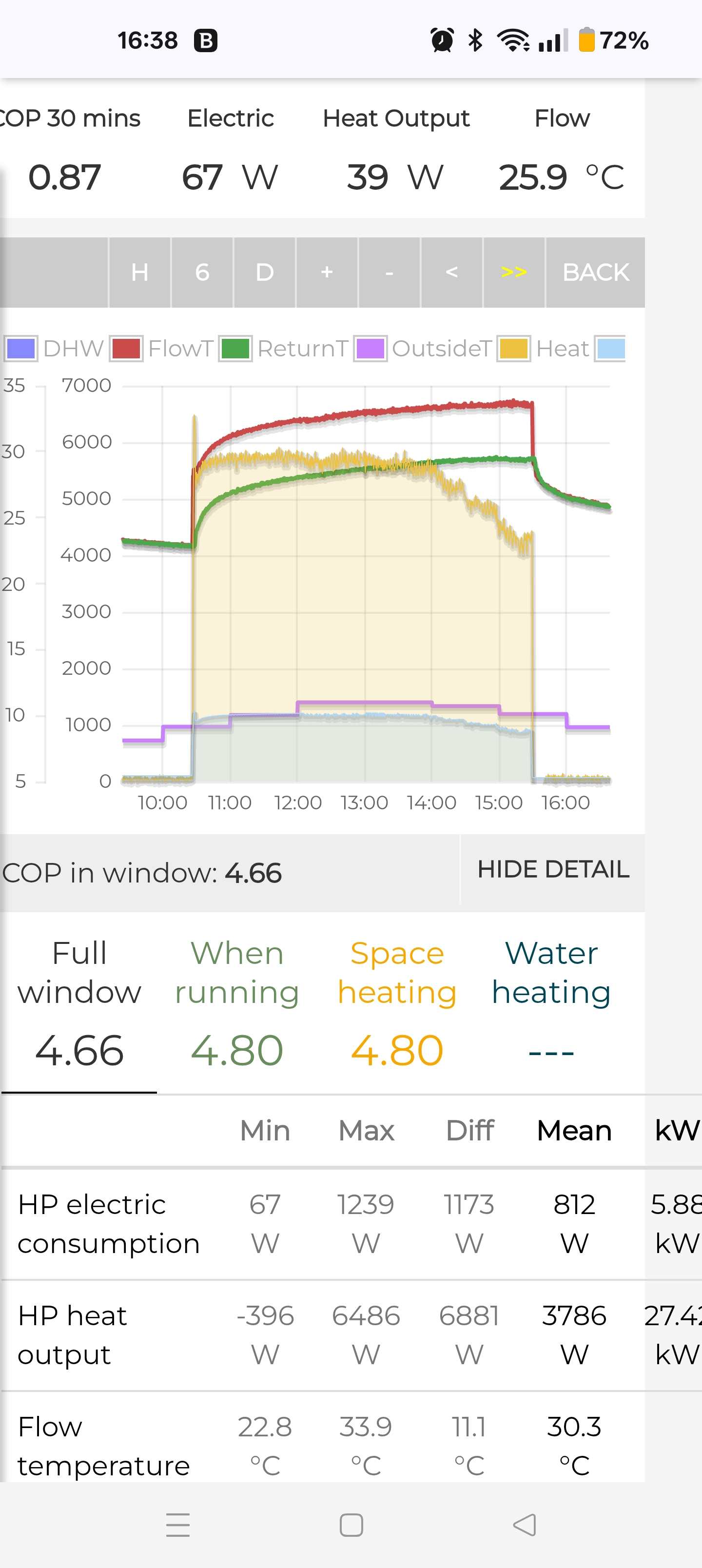

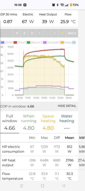

Posted
Diverter is working well.
Generation today was 22 kWh
Export 1 kWh.
210L cylinder heated to 71 degs (8.5kWh), which the max I get out of the immersion.
Buffered 27.4 kWh of energy into floor via ASHP with the heat pump running continuously for 5 hrs. At an average of 4.8 CoP.
